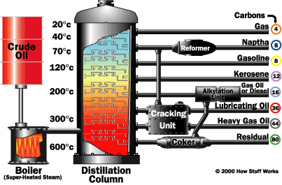

    I posted this on another oil thread, still relevant so enjoy
    Im not an engineer but have access to them and I have been extensively trained by Mobil etc.
    The official word is this, for bikes use bike oil (not car oil) for cars use Car oil not bike oil and so on............easy eh !
    Mobil certainly wont endorse any car oil in bike scenario, because some engineer some where decided it was ok.
    For your bike Magicmonkey I would have thought (from our range) a Mobil Extra 4T 10w-40 a semi synthetic.
    But there are plenty of options out there.
    If I can explain the differences between Mineral and sythetic oils for you in a easy easy way, think of it like this
    The oil they use to make your engine oil (the raw oil) is called Basestock, Basestocks have different groups, group 1 to group 5, each group has different levels of quality the higher grades are used for synthetics and the lower grades are used for mineral based oil as well as a host of other things.
    These are extracted in a refinery tower , lower basestock grades are taken from the lower/mid part and higher basestock grades from the top, the top tower basestocks are generally gas.
    Photobucket
    So know you understand this
    the higher base stocks are gas and the PAO (polyalpholefin) is used to make synthetic oil, the advantage of this PAO as a basestock is this.........All the molecules are exactly the same size, please think of a row of marbles in a line all the same size)
