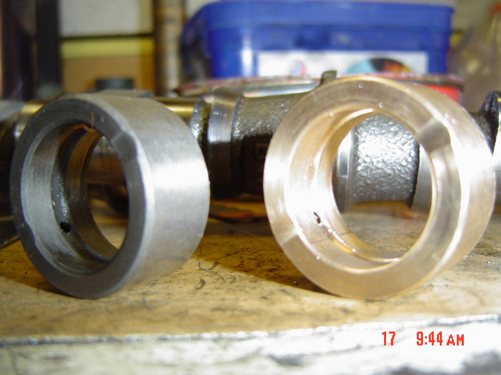

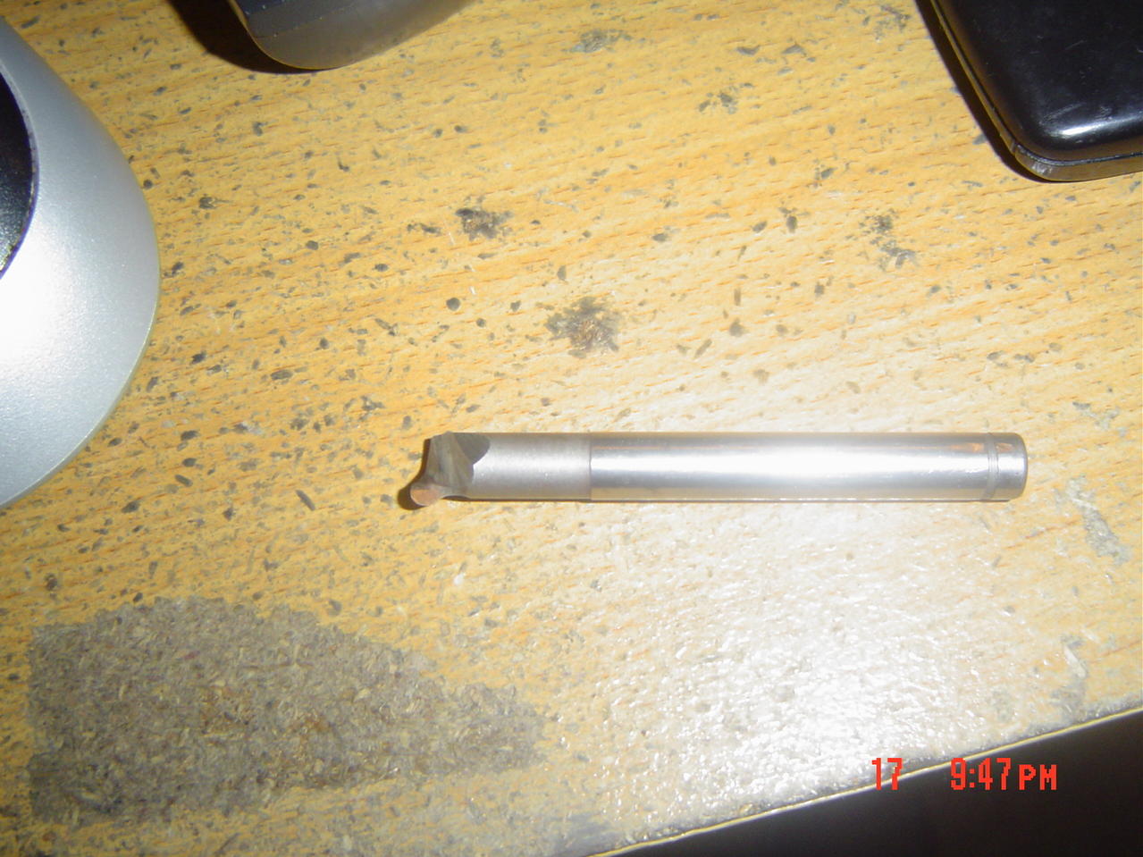

The bushes themselves are relatively simple and the bronze machines really nicely. The only tricky(ish) part was machining the oil groove (see the tool I altered below) to the inside and pressing the locator pin/oil way into the finished bush. I didn't make the pins I just destroyed the old worn bushes and reused them.
So I machined them to the closest clearance specified in the manual and checked the cam journal to make sure it was ok this time.

New versus old bushes, note the oil groove inside.

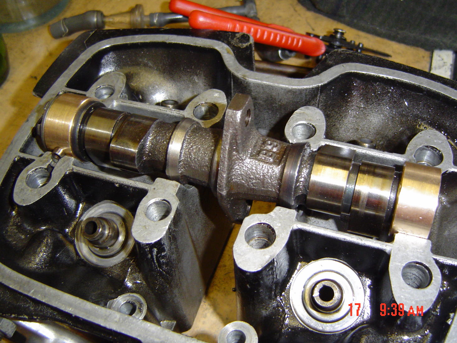

New bushes installed on cam, in cylinder head.
Oil groove maching tool, reground internal thread cutting tool.
