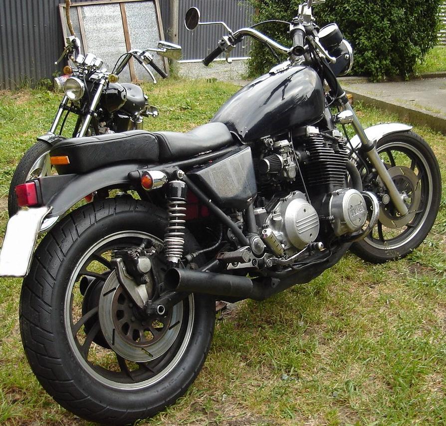

    I have some loaded in my profile, shows what it looked like with the 'orginal 2-1 pipes, and how she looks today

    here ya go. looks bloodly brilliant, maybe i'll get one for a project after my mc22!

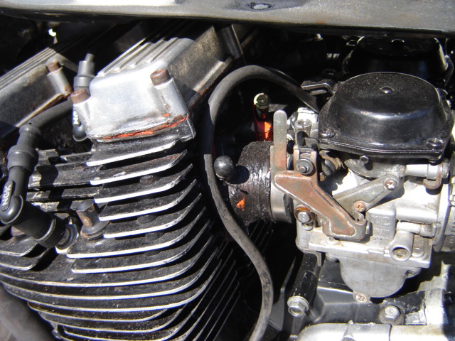

    Cheers Renegade, the bottom pic you can see the tank before I restripped the paintwork back off, it wasn't a good job and was flaky on left side.
    You can see the difference using aftermarket taps, bugga all room for hoses.
    Was thinkn the space behind them towards the seat would be semi okish for the ignition.
    You can see the inlet boots are shagged, I've smeared them in rtv until I can get new set.
    I notice though that whoever put the head back on used sealant rather than a proper gasket, are they as good as they say or is a proper gasket the way to go??

    i wouldnt use that silicon shit on a head gasket (but it doesnt look like it is a head gasket?) - but if its working...

    they have def used in on the tops covers though

    Yep, there is clearly silicone under the rocker covers. That is not all bad. But when you take them off to work on the cam gear (adj valve clearance etc) you will need to strip and re-apply. Not sure with yours, but many have a rubber gasket (think a thick O-ring that is the shape of the rocker box) and if that one is in good condition and has not been pinched too badly, you do not need any silicone or new gaskets for the rocker boxes.
    I be very surprised if someone would have used that stuff as a head gasket. Would not last long!
    The taps look OK. Re space for them: you could make the tank sit a fraction higher by fitting some rubber between it and the frame. Or if you really want to keep those taps, then go the whole way and move them backwards on the tanks. (Here you end up cutting and welding, and is not that straight forward on a tank)

    Just went an had a good squiz at her. They've used silicone in the top only. Looks like normal gaskets elsewhere, hopefully.
    But we'll find this out when the head comes off.
    However the bottom gasket I know is thicker than normal.
