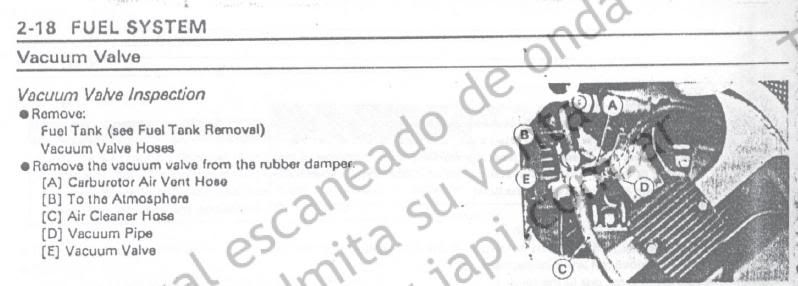

    Fitting a vacuum valve to my ZXR250c and im unsure on where two of the hoses on it are supposed to hook up to. They are hoses A and D in the photo below:
    http://i21.photobucket.com/albums/b2...cuum_valve.jpg
    The carbs have two vacuum nipples on the top/front side (facing steerer tube) that have no hoses on them and was wondering if hose A is supposed to hook into these via a T fitting?
    As for hose D, im not really to sure.
    If any ZXR owners out there could quickly whip their tank off for me and check would be much appreaciated!

    A goes to nothing
    D goes down left side of bike (clutch side) with a twin hose that hooks onto the vacuum ines hanging off the intake manifolds under the carbs... you will see 2 hose one linking cyl 1 and 4, the other linking cyl 2 and 3. hook it into that, ...D is the smallest nozzle on the entire unit and shuld face straight down
