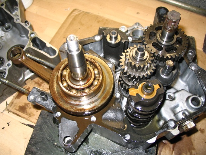

    Using the front mount is risky. Dipy went through a few cases when they broke. I only use the rear two mounts and have an alloy plate under the head bolts which connects to the chassis rails using little brackets. That alloy plate also provides a convenient mounting place for the radiator and ignition.

    My first iteration used the front mount, this was 15 years ago & shortly after when others were starting to mount MBs into different frames they were breaking cases. Those front mounts are on a really thin part of the cases. Dave was by far not the only person to find this, I've replaced cases for John's bike & there was another set in his collection (bought from someone else) thus afflicted. H100s are the same, well almost the same, but for point of this conversation the same.
    CR80 has much more webbing.
    So next iteration was not to have that mount used.
    I had to cut the std top mount away as the big carb would have hit it. That sounds silly but case reed is very different from Mike's picture, although there is Frits's idea of shortening the inlet that could sidestep that but create other case problems.
    Either way if I had a custom set of mounts for the top I might as well for the bottom as they stick a mile away from anywhere useful on an RS chassis. Besides the cases were custom to make them case reed. I have a plate for making new cases in the same place.
