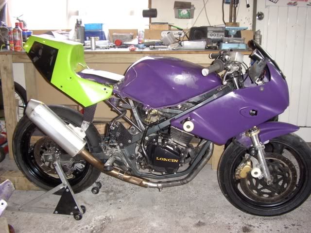

    26th July 2005 - 12:12
    Newdlands, Welly...
    5,480
    Alrighties...
    Work hard today trying to get her ready for tomorrow but just wasn't going to happen. Ran out of alloy to make some brackets for the new tailpiece and also needed to get some exhaust brackets.
    Anyway, here she is tacked together for a pic.
    I'm going to repaint her soon also.
