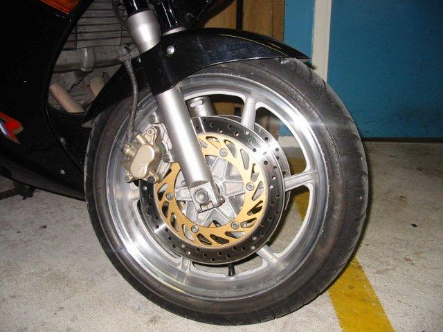

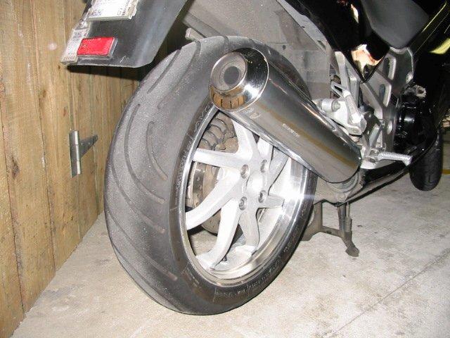

    Quote Originally Posted by Ragingrob View Post
    How hard would polished rims be to keep clean though? Just as hard as white ones ?
    Nope.
    I had white wheels on the VFR750 - they were de debil.
    Stripped'n'polished them, and they were a piece of piss to keep clean.
    I suspect the paint/powdercoat electrostatically attracts road spooge, whereas the shiny alloy lets the dust'n'dirt'n'spooge slide right off.
    Quote Originally Posted by jono035 View Post
    Yeah, it's worth clear-coating them. In other threads people have mentioned that it makes em easier to keep clean too.
    I've read lotsa cases of the clearcoat either discolouring, or cracking/flaking, or otherwise misbehaving. And if it's paint, the you're back to it attracting road spooge.
    If you want em to come up shiny it'd pay to have a bit of sandpaper ready in case they've got the original casting surface on them.
    If they're like other wheels, the rims are machined, but sandcast on the centre bits where the spokes are. It looks OK not polished.
