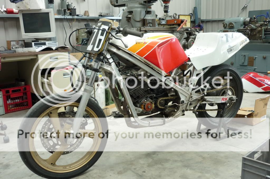

    Hi, Ive got an old GSXR250 (87/88) steel frame with 70's Yamaha DT125. Put 20mm spacers in the forks and a 5mm spacer to stiffen the rear spring and it handles really well. Good thing about steel frames is they are easy to chop and weld. Weight is 97kg.
    Took one of the discs off the front to reduce weight and changed the brake reservoir and lines for the required hydraulics and haven't noticed any difference in stopping ability.
    made up some rear sets to lift the pegs up 25mm and back 25mm
    I'm over 6ft and a bit long in the tooth so find the extra height of the 250 frame much easier. Rode a couple of smaller RGV types and felt too cramped (15 laps of Kaitoke and the old joints complain somewhat)
    Now if I can get the engine sorted and tuck the chamber in bit for better ground clearance, I'll be happy
