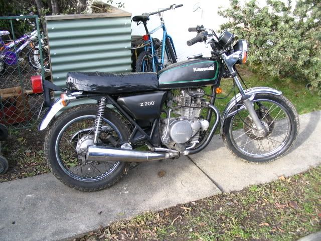

    I knew about the nos lol.
    A Z200 is a mid 70s Kawasaki lightweight, 2 valve 200 single. supposed to be about 18hp, disk front, and quite light. is fairly zippy around town but I wouldnt mind seeing how much I can get from the stock motor.
    kinda got sand kicked in my face the other day by some kid on a cb125t.....
    Is the same family as the old KL250 trail bike, but has 12v and electric starter.
    pic below

    well there is a start for you look at a 250 (did they also come out as a single )

    yeah, on the look for a 250, can probably bore out to 300+ too, that would be fun, however at the moment I was probably going to make it breathe better, by fitting a free flow filter and exhaust, cleaning up the ports, and a bigger carb ( have a few laying about)
    raise the compression a bit, probably by removing the base gasket and maybe planing the head.
    sorting the ignition system, and advance it a bit.
    oh and maybe do some cam work, not sure what yet though
    should be good for a bit more go, and not worried about killing a donor motor, I will still have the origional to return it to stock
