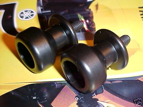

    8mm thread so will screw in to the FXR swingarm... made of plastic .... and landed for $15NZ.... sounds good to me... could not make them for that.

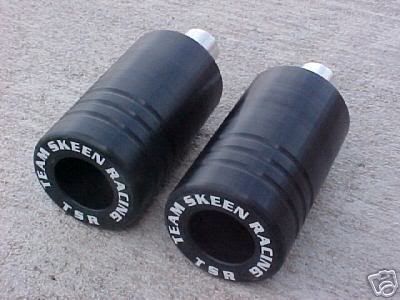

    For the frame Im looking at these.... (where your faring mounts)
    Photobucket
    Slighty more expensive at $50 landed... does not seem so good... how much to buy plastic and have it machined? OK $50 its a good price considering $50/hr to machine them plus plastic...

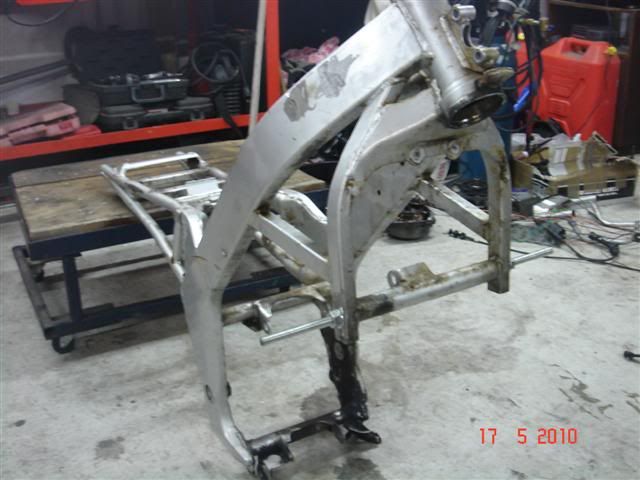

    another good thought... but it means a hole in your fairings... where your fairing mounts on to the frame above the motor... ... (henk told me this) drill through the frame so a 8mm threaded rod goes right through the box section..from left to right.... have a look at my build on FXR site and you will see what I mean.. then screw somthing like this on.... good protection and looks OK... and most importantly its strong.
    Photobucket
    Then some small bits of nylon or simular on the foot pegs... and lastley some thing to protect the front axle... (this is from Colin... orange CB125) replacing my front axle with a longer one with and putting a simular protection to the frame plastic on either side of the bolt head and nut... again nice and strong.

    Thats looks like a might fine idea.....do the swing arm ones double up as bobbins?.....would love a set if you wanna bring in 2
    Make a hole through the fairing is no stress.....
    WWW.CMLRACING.NET.NZ - Comfleet Graphics Bucket Racer
  7. #187
    18th June 2006 - 00:14
    890
    Yep...
    just waiting for some measurements...
    No problem will be at Mt Wellingtin Saturday.. I hope...deoends on brother in law... hoping he will have a go.
    I will bring in a set for you no problem... let me know if you want the faring ones also?

    That a good idea.. There's holes in the spada chassis around that location already.. And I can just pinch some nylon from work.. Sorted. And threaded rod hahaha.
