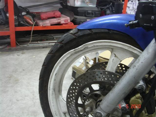

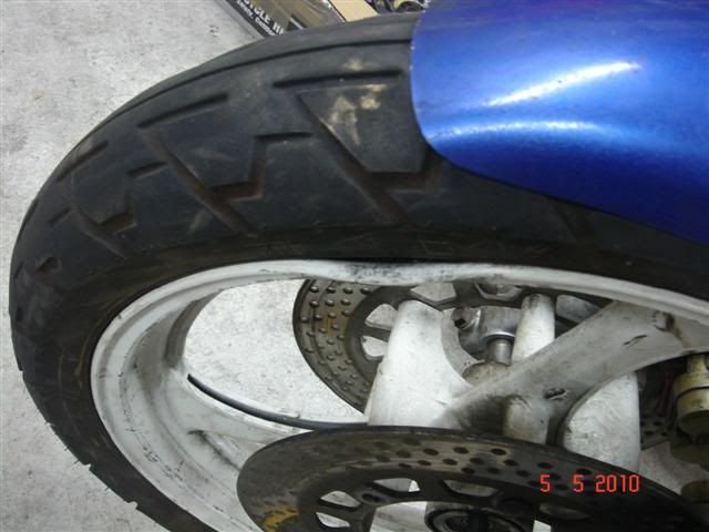

    Brought some GSXR250 rims and the front has a ding in it... what a piss off.
    Can this be fixed... like cheap?

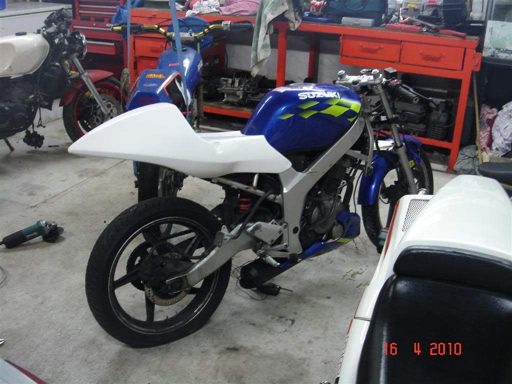

    Oh... forgot to add this is for my FXR... which is currently being built.

    Short answer - yes.
    It looks as if the bead seat is undamaged
    Any competant TIG welder could strip the paint/powdercoating and lay multiple layers of weld bead then sand to reprofile.
    DON'T try to knock it back into place.
    Any number amateur metalurgists will probably now talk granular structure, heat treatment, blah blah.
    Here in the real world, given the size and potential speed of the bike, find a fella with an AC TIG welder and buy him a bottle of bourbon.
    A big one.
    WITH a handle.
    Works wonders...

    Well... I was thinking heat... and hammer...
    Seems this is not the best option?
    I can buy a new front wheel for about $120 dollars... so cheap is the name of the game.
    So fill in the ding with weld and grind it back to original?
    never thought of that!!

    Because the wheels are cast the deformation will have caused micro cracking. You can't necessarily see it but it is there and from little cracks big cracks grow. Bashing back into place doubles the problem. When it is being welded the welder can see the extent on the crack (the localised heat seems to make the cracks magically appear). It is possible to chase the crack with the moten pool and refuse the metal. Or - make the call to grind more out and start again.
    Although the wheel will be a magnesium alloy the filler wire isn't too important. The side of the bead isn't critical.

    The front wheel off a GSXR250 will not be a magnesium alloy. Magnesium alloys are only used if lowering rotating mass is more important than loadsamoney, i.e. racing applications. A 20 year old jappa 250 road bike is not a likely place for a set of magnesium alloy wheels. Pro Tip: 99% of mag wheels are aluminium.
    FM (Professional Metallurgist)

    I'm suggesting a 6000 grade alloy which as a professional metalurgist you will know has a magnesium content. 6061 is the most common aluminium alloy used
    You will also know that pure aluminium has very few uses and that the alloying elements give the desired properties to the item. My comment was really to make it clear theat it didn't really matter whether the filler rod was 2022 or 5055
