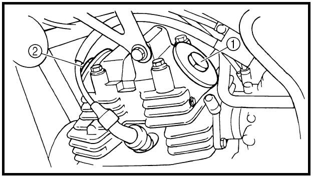

    Hey everyone, i am looking to open the rocker cover on my yamaha sx-4 which is an aluminium cover onto the aluminium head and simply put i cant get it off and am hoping for advice.
    Heres an image of what it looks like:
    Photobucket
    It has a 24mm hex on the rocker cover which unfortunately is also aluminium (as its all one piece) so will be very easy to damage. I have a decent 24mm spanner and with that have managed to dent the aluminium while trying to undo it already so dont think i will be able to apply any more force without seriously damaging it.
    The aluminium on the bike is quite oxidized and i am wondering if the rocker cover cover and head have fused in some way or something? and if so does anyone know of a way to remedy this before i try again?
    Any help would be appreciated,
    Thanks,
    Joseph

    Use a 24mm 6 point socket - 1/2 drive if you can fit it in. That should move it. Could try some heat (heat gun - not hair dryer) or squirting CRC over it and leaving it overnight before heating and turning.
    A normal spanner will just fuck it up, but if you can't fit the socket in there, find a 6 point ring spanner and file/grind the base of it flat so it sits flush with the cap - there's not a lot of purchase there.

    thanks for the reply guys, i have a 12 point ring spanner and a 12 point socket. I will have a search around the shops in the next few days for a 6 point round spanner or socket though will admit I was hoping to avoid the costs of buying more tools ;-)
    I've given it a good dousing in CRC but not much luck there, and have tried tapping it with a hammer as well, will try use a corrosion cleaner on it before I tackle it with another tool.
    If anyone in Wellington had a 6point 24mm socket of spanner they would be willing to lend me for 15 mins that would be greatly appreciated!
