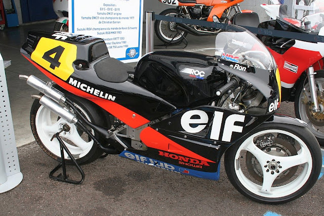

    pulled out the half finshed centre hub steering bike . looks like the honda 125 twin will go into it (looks the best)

    Quote Originally Posted by crazy man View Post
    the GT.. the GT..
    So are you going to build a crazyman framed centre hub steering bike?? Roll over Elf Yamaha.
    I better sort out those pistons then...

    Quote Originally Posted by Bert View Post
    the GT.. the GT..
    no l have reserved the frame the 125 twin was going into for the 100 twin he he. you better get the pistons here (-:
    the GT.. the GT..
    Wasn't the ELF's er........ Honda powered they brought all the patents after the project like Proarm etc.
    Serge Rosset went on to Build pretty but conventional framed and suspended ROC Yamaha's and Swiss auto powered stuff later?
    PS found some RS rear brakes stuff carrier, MC etc caliper too i think as well if you are interested?

    ELF... Honda...
    true; bugger.
    yes well I was rather young at that stage of GP history... no excuse for that though.
    Wot a 40kg motor that makes fuck all power? Surely there is a better (2 stroke) alternative.
