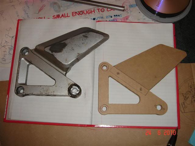

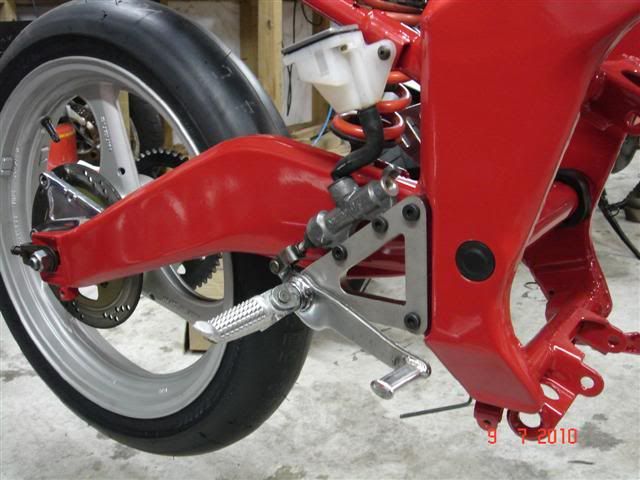

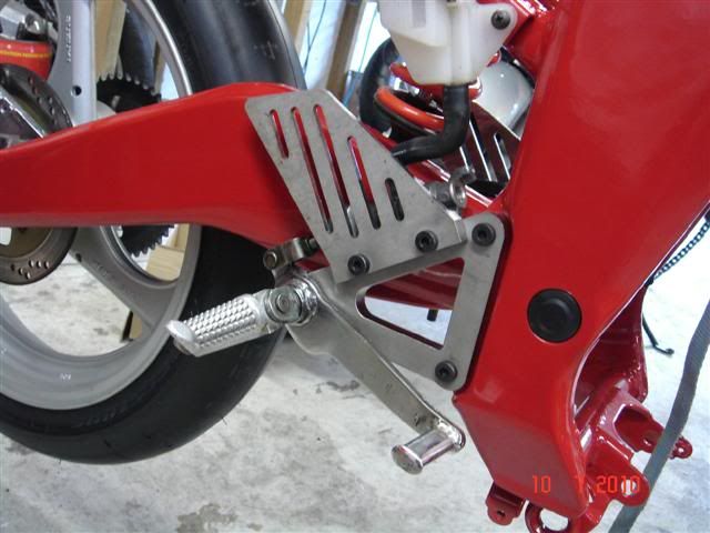

    I have made some rearsets...

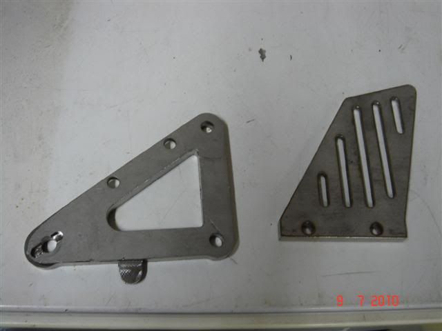

    this is the first set... everything is laser cut incluiding all the holes and stuff...
    What would I change... the kick plate is rather heavy... could be done much much lighter.

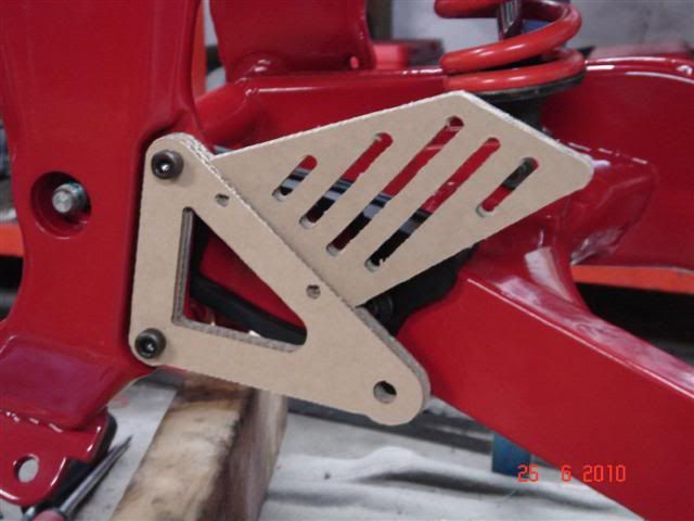

    Started making some out of cardboard.
    Photobucket
    Photobucket
    then Stainless.. just needs a nice polish.
    Can be done in Steel, Ali etc.
    These need a little mill time and they will be mint.
    Also I can have just the mount... no skid plate.
    Photobucket
    Photobucket
    One for the road...

    Umm, not keen on cardboard ones (I reckon even if they don't break, they'll bend like anything, and if it rains, they'll just distintegrate).

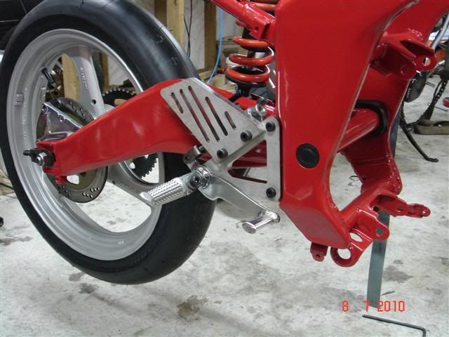

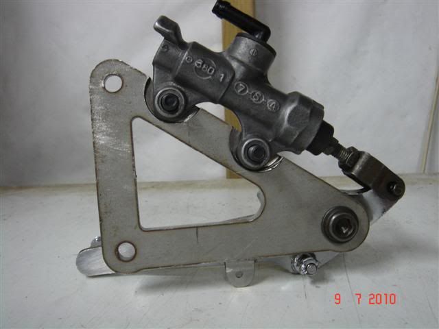

    Damin... let me know what you want... 20mm back and 60mm higher and i will send you cardboard templates to try.... when your happy I will do the rest... Stainless, steel, ali... your choice.
    one side is with the skid plate... other is without... good thing is it is removable.. unless you dont want the mounting holes.
    Photobucket
    Photobucket
    Photobucket
    Photobucket
    Photobucket

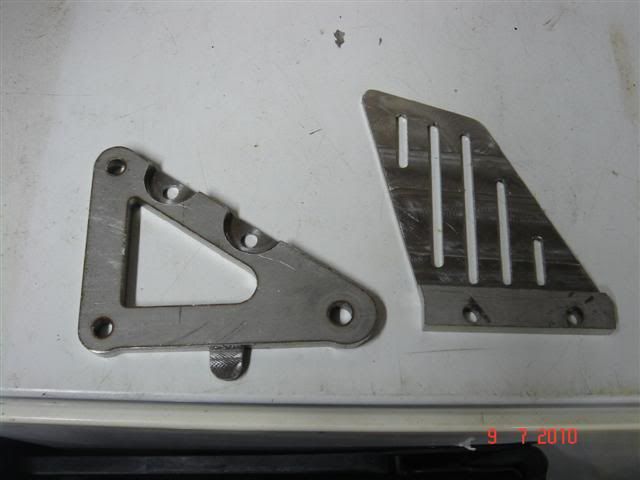

    with skid plate... spent 2.75hrs on the mill today... next set skid plate will be 3mm plate and I will wled on a rectanglar spacer... still about 1hr mill time per set.Photobucket
    One for the road...
    18th June 2006 - 00:14
    890
    skid plate is 4mm thick now... good buy all that weight

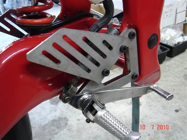

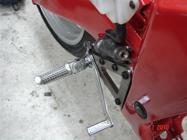

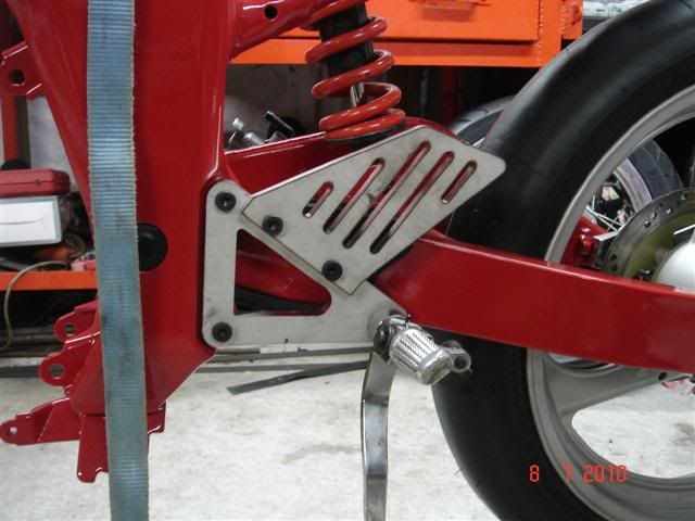

    A couple more pictures... with the kick plate...
    Got to say very pleased.
    Laser cutting is soo cool, all the holes etc are cut and everything just lines up perfect.
    Photobucket
    Photobucket
    Anyone interested in a set just let me know..
    Can be made to suit your requirments.
    say 40mm higher or back 20mm and up 30mm.
    Can send you cardboard temples to see if you like the postion.
    Your choice of material... Stailnless, Ali or steel.
    With or without kick plate.
    Hard to provide a price at the moment but I would sell mine for about $220 and they are Stainless Steel... just need polishing now..LOl.
    But they would be cheaper in steel and approx the same in Aluminium.
    Without skid plate and you are looking at $120 a set in Stainless....
