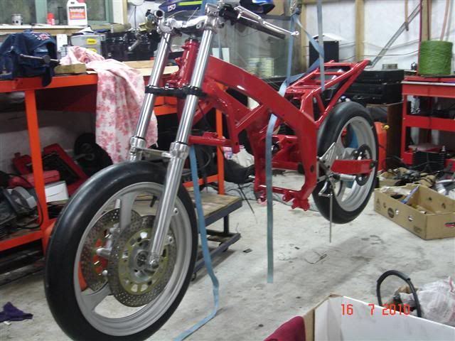

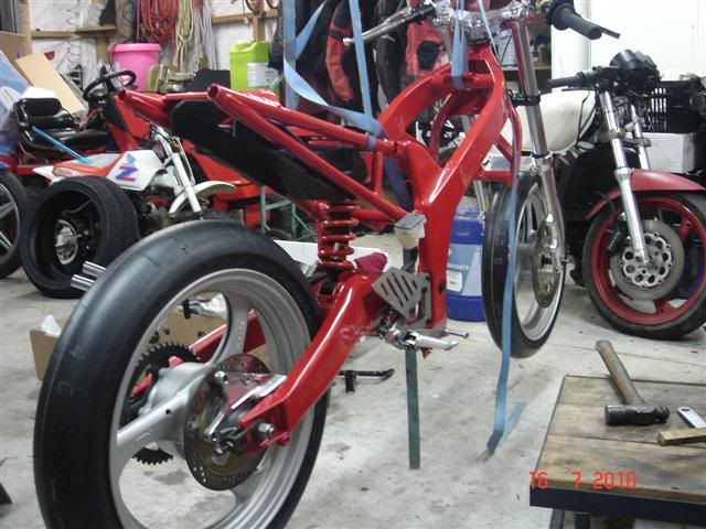

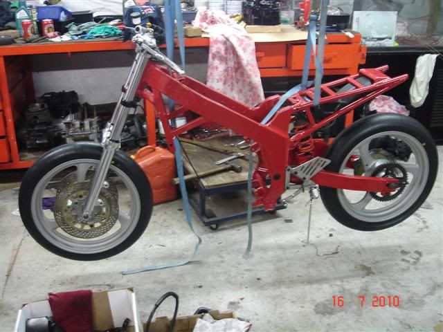

    FXR starting to take shape...
    Photobucket
    Photobucket
    Photobucket
    motor ready to assemble.
    Photobucket
    Photobucket

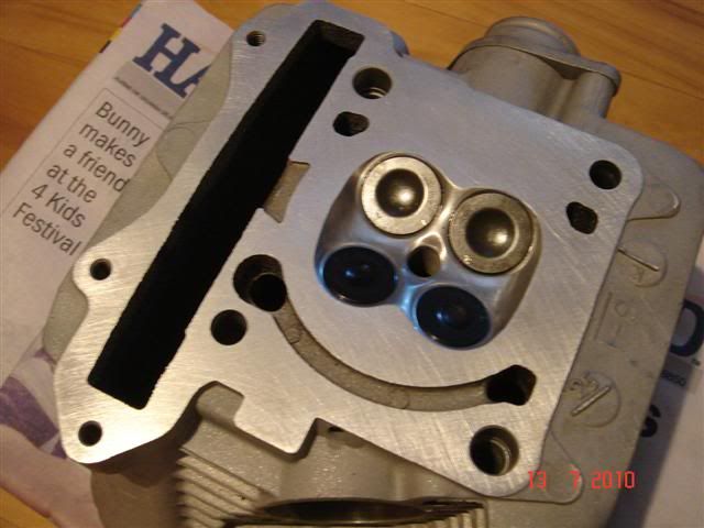

    Barrel has been rebored +2mm with new piston.
    Head ported
    Valves re-cut and new oil seals
    Crank rebuild
    New bearings and seals

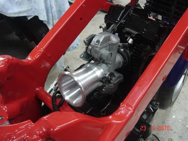

    XL250 carb with new seals and velosity stack
    Quick action throttle
    Tuned exhaust.. on order from a secret location in the deep south
    Igntec ignition with quick shift and launch control
    Still lots to do...

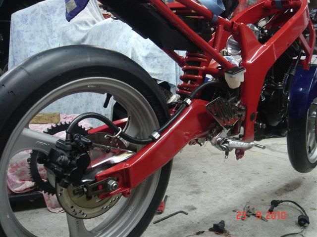

    FXR update ....

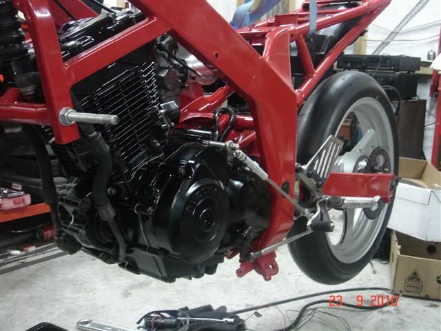

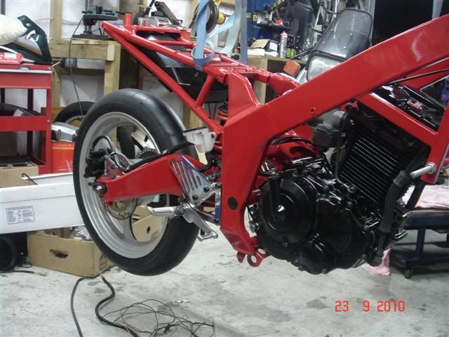

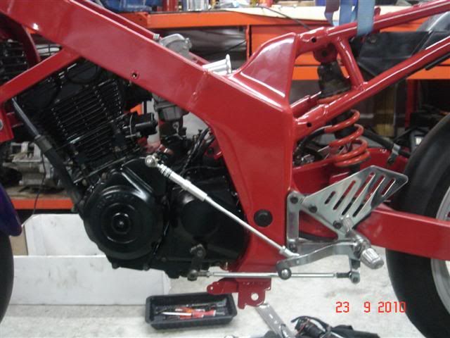

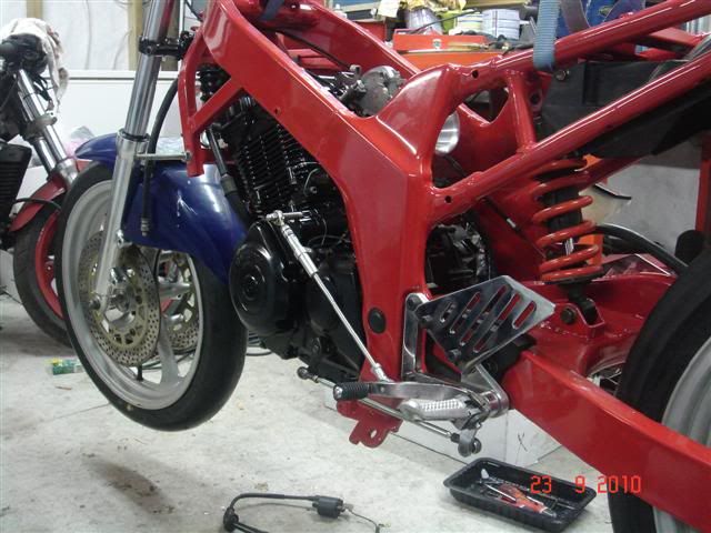

    Motor is in and its starting to take shape...
    Photobucket
    Photobucket
    Photobucket
    Photobucket
    Photobucket
    Photobucket
    One for the road...

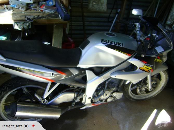

    And... oh no...
    Photobucket
    the wife went ape shit.
    Was watching this on trade me this morning. i was just watching... and some how purchased it.
    1999
    7000km
    no foot pegs
    has not run for some time
    and the best bit...$685
    Now what am i going to do with it?
    This will slow down the FXR build as all my funds are gone... but I have a CG150... that will be sold soon.

    What is the purpose of the additional linkage on the gear shifter ?
    18th May 2007 - 20:23
    10,551
    That quick shifter looks mean, looking forward to hearing how it works out................
    4th February 2005 - 07:32
    Rattlecan blue
    3,963
    It's the sensor for his flash ignition that will kill the spark when he changes so he doesn't have to drop the throttle and can do full noise shifts. It's also an expensive lump of kit hanging in the breeze to get smashed when we run him onto the grass through the sweeper.
