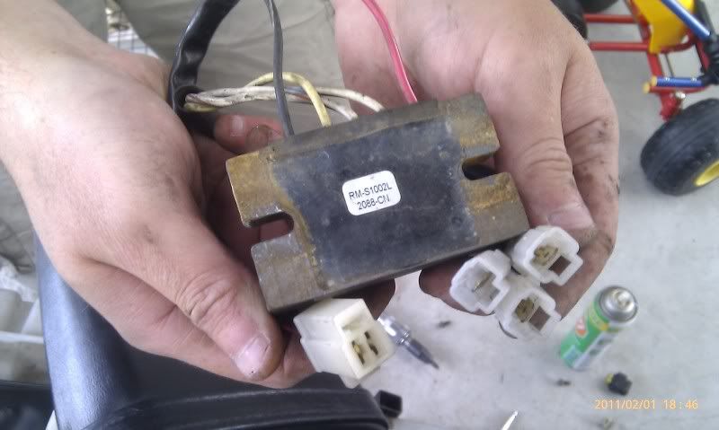

    Hey guys.
    Thought i would post here and see if anyone has one lying around.
    Im after one for a 1989 GSX R250.
    This is what my busted one looks like.
    Any help would be appreciated.
    Cameron

    thats an aftermarket reg/rec you have there

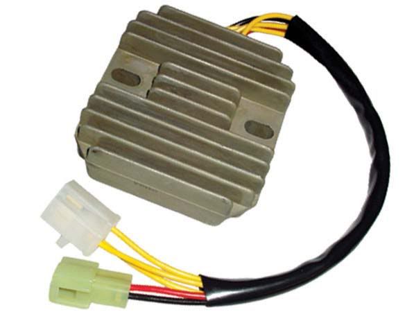

    the original replacement item should look like this rr17
    the brand new aftermarket one is $195 plus courier
    scare yourself if you like,ring Suzuki and price a new genuine one
