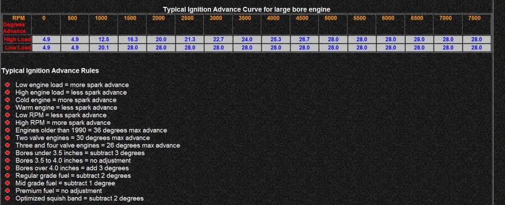

    Where to start tuning ignition timing? From the net
    where to start tuning ignition timing...
    Photobucket
    Now whats the thought on the above?

    Quote Originally Posted by Arronduke View Post
    Seems odd.
    As I've really ony ever been playing with quite crude setups I've found it perfectly fine to tune by trial and error, slowly adding advance until knock then backing it off 'til power drops off then going back between the two.

    18th June 2006 - 00:14
    890
    Just look at the timing on my ignitech now.
    10deg base advance
    then ramps up from 10deg @ 1500 rpm - 35deg @ 3500 RPM and then stays at 35deg.
    Anyone know if this is close to standard?
    Photobucket
    The top graph. You want all your advance in before peak torque. 8000 on an FXR so they say. So maybe 28 @ 7500. But like other people have said. Really needs to be done on a Dyno listening for knock under load.

    It certainly looks like the dyno is the way... trial and error.
    Like most i am unsure what gains there are but hay... if it gives a little then I am all for it.
