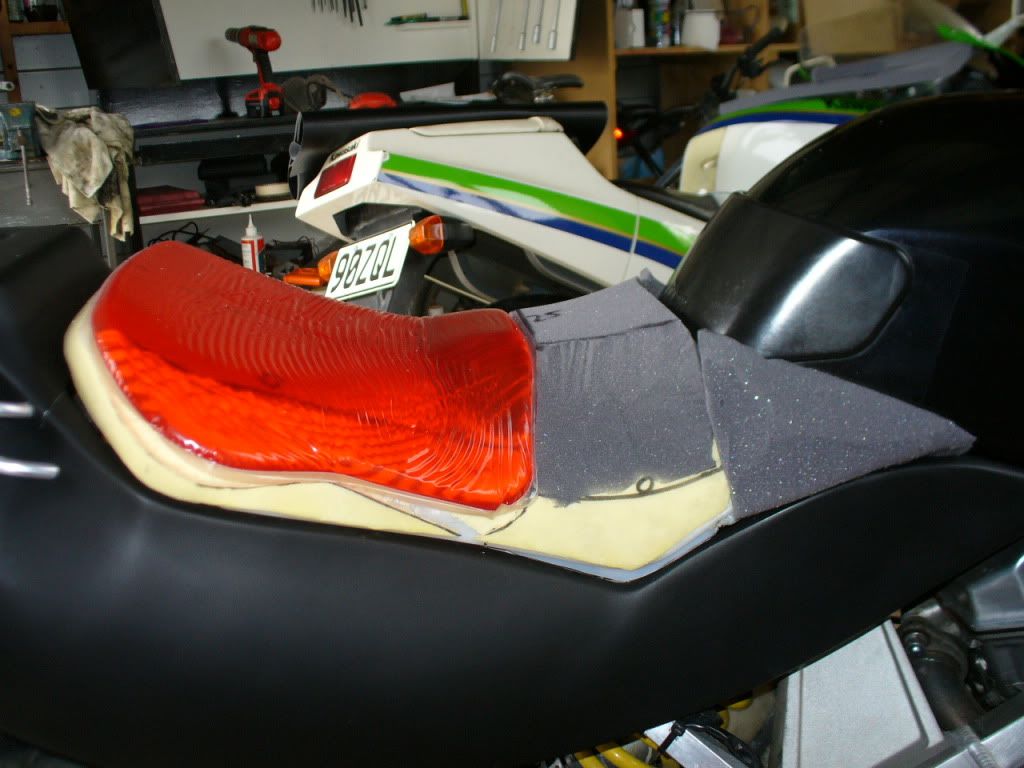

    Made a start on it this arvo. Had to hack into the existing seat foam around the sides to the gel layer would stay flush with the bodywork, but with a gel layer on top, you don't have to go super smooth when cutting the foam! I lifted the front bit of the gel 12.5mm (+12.5mm of gel) for a 25mm raise at the front, and just the 12.5 at the rear. Should make braking nicer on me plums.
    Still have to fabricate some extra bits for the front (seat doesn't quite line up how it needs to) so hopefully it'll plastic weld... Then put some foam on those bits, smooth it out, take some pics, add vinyl, done!

    Got it installed today. Pic before grinding foam to shape, and one after putting vinyl on top.
    Vinyl fit looks like arse (as opposed to the more desirable, vinyl fitting my arse), so will redo next time I'm at the parents, as Mum has a sewing machine so will make it out of three panels as it needs to be. Borrowed an almost usless stapler which didn't help my temper bout half the time it lodged them in enough so I could bash them through with a hammer, made it hard to difficult to put much tension on the vinyl though.
