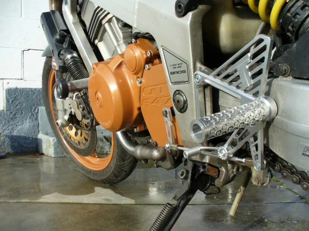

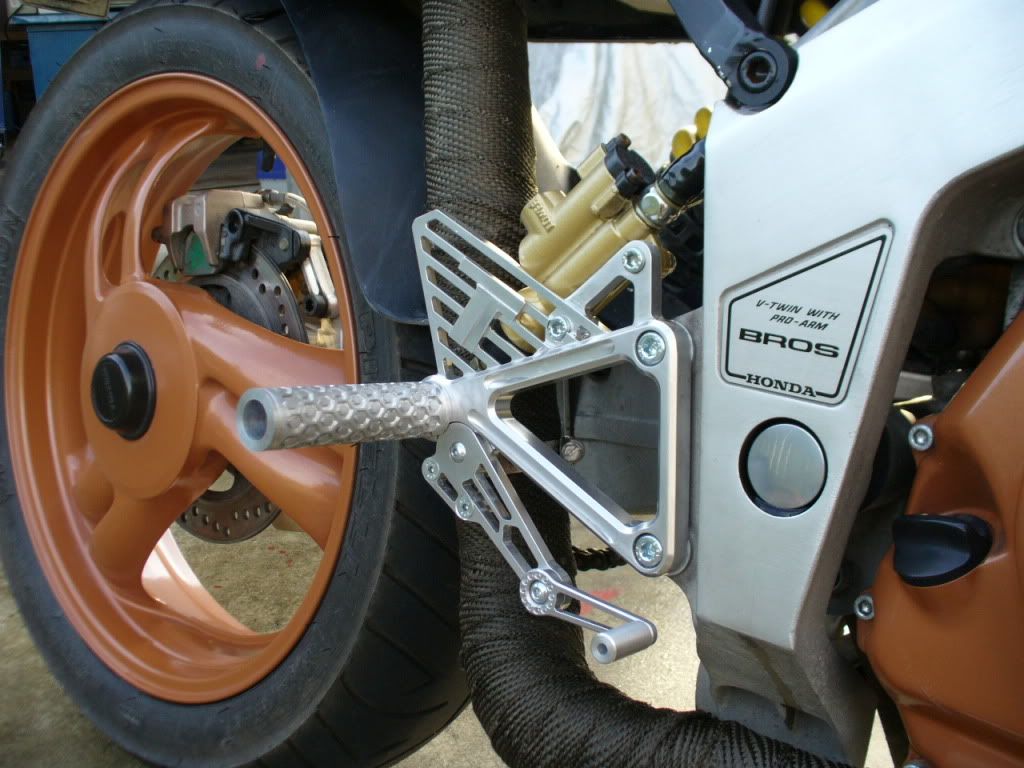

  15. #120
    25th April 2009 - 17:38
    RC36, RC31, KR-E, CR125
    Manawatu
    7,364
    So I must confess, the photos above use trick photography to make it look like I had two footpegs, and that it was all in working order.
    This update; now I do have two footpegs, and it is in working order The peg position puts a bit more weight on my wrists so I'll have to work on gripping with the knees, especially around town.
    I also did some tuning, and it runs better than before, hopefully it gets a bit more kms out of a tank too.
