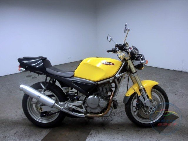

    looks like a goose

    Quote Originally Posted by mr bucketracer View Post
    looks like a goose
    A little bit i guess
