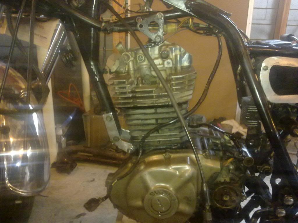

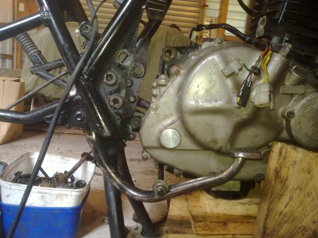

    Here be some flat alloy dummy mounts for the lower front I bashed up, nice 'n rangi
    You can see the lower rear mount with a bolt through it hitting the brake lever (used the bolt + ratchets to lift the engine in, I'm too weak)
    This can be done if I have a two part rear mount.
    If the rear mount goes from the top engine mount to the lower (down below the gear shift shaft) and then bolts to the original lower mount on the chassis (on the bar where the center stand mounts), then have one from the swing arm pivot that bolts to the other.
    Hopefully the shit paint pic here helps visualise Incredibly shithouse paint image
    Fits very well, I just have to trim the lower rear frame mount back and re-drill them and I can pull the motor back a bit more.
    No issues with chain/frame clearance, but it'll need a roller on the swing arm as the sprocket is a lot lower than a GN one
    Kind of neat that it'll only take 5 minutes with a hack saw to trim the mount and then start making some dummy mounts out of flat alloy poo I have floating around
    The motor has the kick start blanked off and there's no electric start (bulge at the front is a second balance shaft, I think) I have all the bits here except the lever, so it looks like I'll have to open 'er up properly and install that.
    It turns over rear nice, there's no play in the gudgeon, the piston is sweet, has new rings too, bore will want a hone as it's a bit ugly, but that's no big deal.
    The head is very similar in design to a GN, but runs twin plugs.
    The carb is okay externally, but I'll rebuild it once mounts are done
    It even came with header pipes
    There's about a million random spares, CDI, coils, gaskets, throttle tube etc etc
    Oh and who loves my high tech Kiwi spec engine stand?

    Where you make plates to go from original mounts to your motor, you need to put a grommet/spacer/tube between the plates.
    Also, you really really really wanna get the sprocket as close as possible to the swing arm mount. If you don't, the rear suspension won't rebound at all with the gas on.

    I'll be moving the motor back and up a bit when I trim the rear lower mount, so fingers crossed we don't have too many issues
    Definitely have spacers between the mounts, don't want it to twist right out the frame

    Motor is all in place, will get the front mounts machined up then take nice accurate measurements of the rear
    I haz better idea for rear mount, so that's all happy.
    I have to split teh cases by the looks of things, the kick start hole is blanked off and there's a box of kick start parts fucked if I'm roll starting it every time
    Turns out the early DR650 is very similar internally, so I've got a pre-96 650 manual to use as reference
