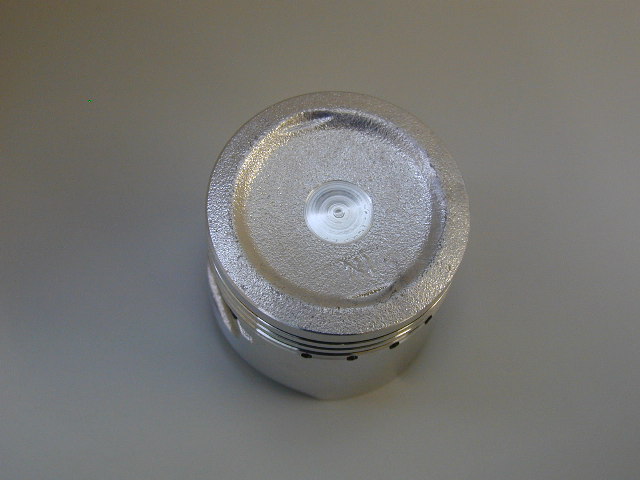

    Flat-tops would decrease comp hugely by themselves, the 250/4's I've seen inside all have contoured tops to get the 12.5:1 or so ratios that they run.
    Main problem of all this is that the motor is just so damn tiny.
    I elected to get a much more cost efficient 2-stroke. That's a comparably easy build but it still stretches my resources super thin.
    So should i let it die down as well but...
    Even with allowing for the reduction in comp with the destroking to achieve the needed 6.5:1 for the 22 psi to make the supercharging worthwhile it does need dished pistons or no squish and massive detonation.
    Here is the ideal supercharger
    they don't come up very often so someone will snap these up
    http://www.trademe.co.nz/a.aspx?id=492361027
    http://www.trademe.co.nz/motors/car-...-492574448.htm
    Anyone attempting to do this should exclude the Honda CBR250 from there list of options as well as there would be bloody hard to destroke. The Kawa is to too overquare imo as well. That only leaves the suzuki or the Yam and the Suzuki's looks a lot less advanced in regards to its head design.
    like these but forged of course if you want them to last.
    http://www.tkrj.co.jp/goods/m-AH0370X--GB6-911.php
