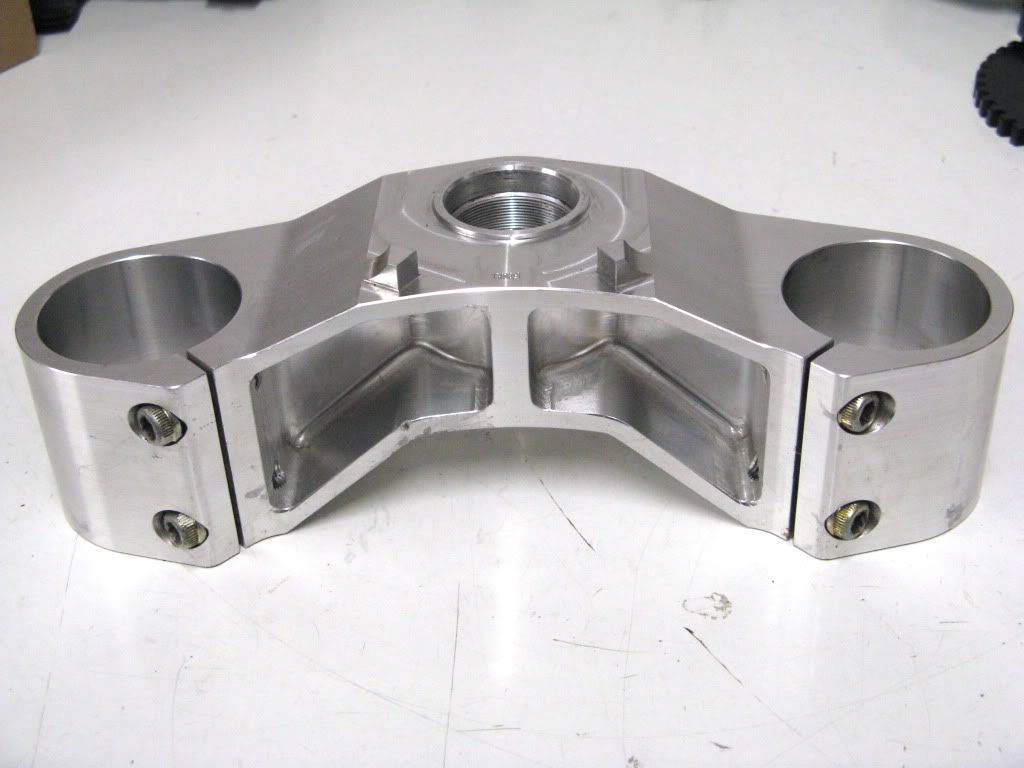

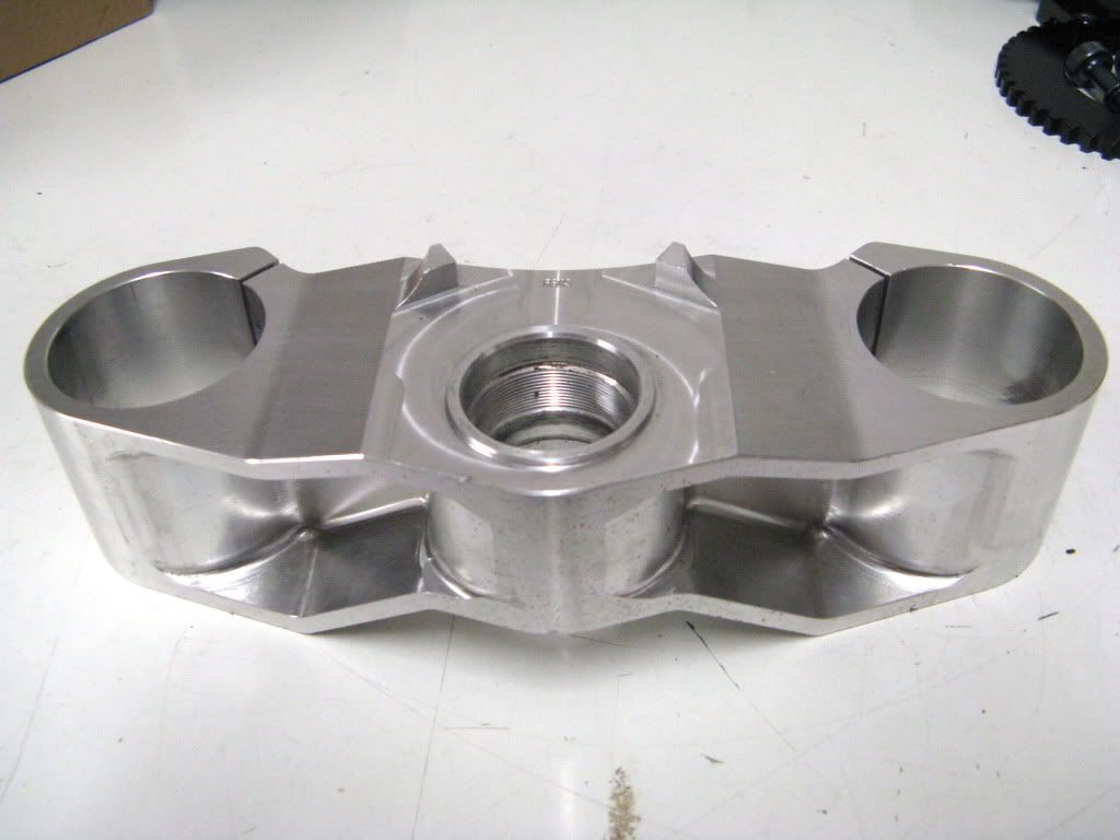

    The plan I have is to build around the old FXR frame then cut away the old bits. Looks like it should be ok. I will build a real basic jig for that job. After talking to Mr water cutter I am also now looking at using some late model 600 forks. Water cutting the triple clamps will be cheap and easy. He said just make the holes .5 under then mill to size later. Will have to check the weight of a gsxr stanchion to see if it will be worth it.

    If i may suggest if you were making clamps make them adjustable for offset. That way you can adjust the trail independent of the rake also most of the race bike clamps are real deep on the lower yoke. A built in bracket on the lower yoke for a steering damper could be fun (like an RS125)
    thrown in a ROb North clamp as they are neat i think the Works BSA MX ti bikes had beatiful fabricted yokes from round tube that were far lighter than any exotic Mag alloy

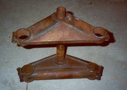

    I don't know why more people don't fabricate triple clamps - the last pre 72 I built I fabricated the top clamp from machined bosses and thick wall open channel which I had bandsawed out of rectangular tube...TIG it up on a simple jig and bobs yer unkie..
    Came out quite light and very stiff - without any real attempt at lightness too.
    I suppose the lure of the magic acronym C.A.D....and shiny billet is too much to resist for some people.
