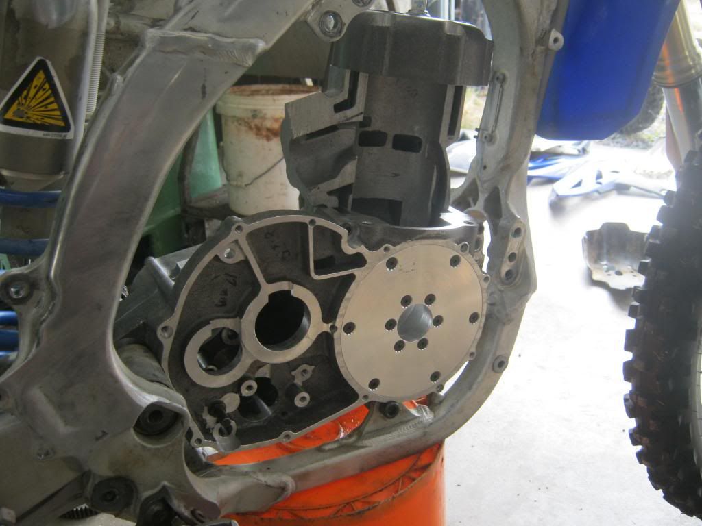

    The old " half a cylinder trick aye " this is the 180cc option.
    This was the second cylinder ever cast for the gyro engine, water core slipped, so it was a reject. What else to do but cut it in half.
    Don't be looking at the ports, I've been reprimanded by wobbly and have a new layout port under way including prevision for a power valve.

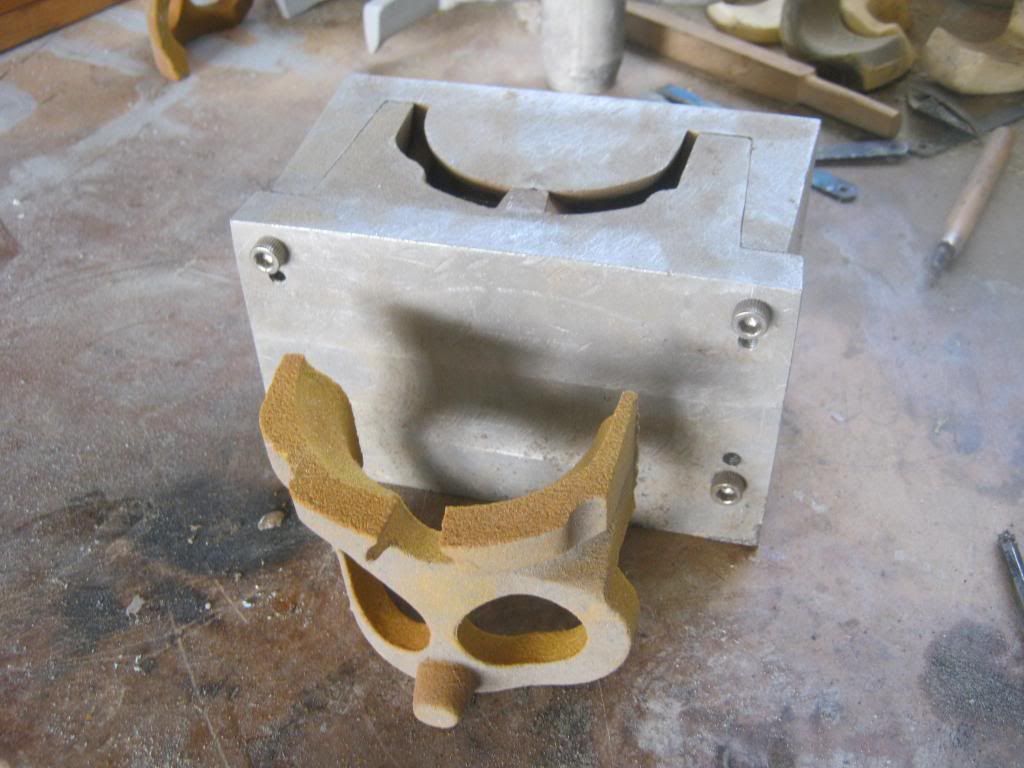

    Do you make your cores with the Co2 hardening process?
    Not too familiar with disc valves as yet, so I'm trying to figure out why all those c/sunk screws are there on the side of the case, - is that a removable back wall for the disc chamber?

    CO2 sand is good for most cores, cheap core boxes, easy to use but can be brittle for intricate cores ( water jackets )
    For the more tricky cores I use Shell Core sand,this needs metal core boxes as it sets at 180 degrees C.
    If you don't have a CNC to cut these core boxes, just copy cast from the wood / bondi fill core boxes you would have already made.
    This core box was copy cast from the original wood core box, then machined to fit together with screws. A little cleaning up on the inside surfaces are usually needed.
    The disc valve plate you see here is to cover a cavity behind the valve. This plate seals off to allow cooling water to flow behind to help cool the crank case. Water comes from the pump, behind the valve then up under the exhaust port. out through the head after that.
    Disc valve port still needs to be cut, we have attempted a test cut in a scrap peice of aluminium, not right just yet!

    cores
    Thanks, that's all very interesting, - way in the past I have labouriously milled out CI coreboxes and the foundry then cooked up the cores using shell/coresand.
    Interesting that the valve needs to be cooled, I seem to have fallen behind in understanding modern day practice!
