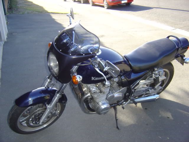

    Well must be time for an update....it lives
    Still as dirty as ever apart from cleaning the painted bits, spent a loooong time cleaning congealed black gunk out of the carbs, tried to do the same to the fuel tap but once it was apart it was never going back together. Almost looks like someone has put some oil in the tank to stop it rusting, and in the 12 years since it's turned to tar, so after a new fuel tap, one new carb float and new float needles it's no longer pouring fuel all over the floor and running on 4 cylinders. Pulled the brakes to bits and freed everything up and gave them a bleed, seem to be working pretty good, and chucked some lube on the chain which doesn't seem too bad.
    Took it for it's relaunch ride the other night and wouldn't do more than 95, any more throttle opening and it stared dying, so first guess was to replace the plugs. Out for another ride today and much better, not sure if it was just old dirty plugs or because I replaced the D8 plugs with DR8 plugs as per the manual and it needs resistor plugs, either way it's sorted.
    Now it's wait for a rear tyre from trademe to turn up and get that fitted along with the front I scored for free to replace the 14 year old one currently on the bike, and then down to the wof shop to see if I can make it legal.

    Well.....
    Bike now has a WOF, scrounged up a legal rear tyre and took it in, found out it failed it's last check 11 years ago, but all good.
    Then....
    Dropped to 3 cylinders on the ride home, cleaned the plugs with not much improvement, had a bit of a look and judging from the crc test the intake rubbers are shagged.
    Then to finish things off nicely, after sitting outside for a few hours I put it away and it proceeded to empty the contents of a full fuel tank onto my shed floor, and from a quick look at the level glass also fill it's crankcase with petrol. I'm figuring some crap from the rather dirty fuel tank has found it's way into the fuel tap to hold it open, and got into the float valves and held them open as well keeping every flowing rather nicely downwards.
    So now I'm at the point that I really can't be bothered any more, don't really want to spend any more time or money on the thing and can't really ride it in it's current state, so thinking it might be time to stick it on tradme for parts and spend my time riding bikes that actually work.

    I'll consider your generous offer, but really would like at least the cost of the shiny new parts I've attached to the thing.
    It probably just needs the rusty petrol tank treatment, and to have the carbs cleaned. again.
    I think it can sit and rot for a bit, floors to tile and walls to paint before I get to pulling it apart again, a set of intake rubbers from the dealer are around $300 or direct from the US for about $120 so not too bad.
    Just bloody annoying when it looked all good to go, and I was about to get keen and start shinying the thing up.

    Any idea what size carbs and distance between the boot bolts?
    It'd be possibly to use other ones (I think they're running 36mm carbs?) as Kawasakis of the era are surprisingly mix and match
    Quick little search, P/N 160651256

    intake rubbers
    Hmmm, according to evidence I saw on www.zephyr-zone.com the intake boot is actually a metalic cyclinder coated in rubber. Some summarise that the common cracking is superfical only and a red herring.
    That said though, my old girl had some form of sealant smeared all over them, given that they are metal inside I would recommend doing the same thing to rectify yours.
    Don't give up on her!!! a couple more hours and she'll be running great and road legal. just make sure you clean the tank properly this time and fit an inline fuel filter ($8 from cycle treads)
    Oh yeah and throw some CHEAP oil in her until you're sure the fueling/rust issue is sorted
    .... back in green and feeling great ....

    Well, it lives.
    My fuel tank cleaning efforts weren't quite as good as I thought so did the complete POR15 treatment on it, fuel tap still dribbling a bit afterwards so stripped and cleaned that, dropped the float bowls and cleaned the valves and finally no fuel leakage. Smeared some rtv around the intake rubbers on suspicion, seeing as it was in bits anyway, not up for fronting the cost of new ones at the moment.
    Went for a ride and still seriously short of go, so *sigh* pulled the carbs off, completely stripped and cleaned them again.
    Reassembled everything, still no fuel leakage as far as I can tell and it actually works proper like, and doesn't sound half bad when you wind it up to 10,000rpm.
    Took it out for it's first useful ride tonight to get some paint, the plasterer has finished the walls so it seems to be sorted just in time to move onto the next job, timing is everything.
    Looking not too bad for a bit under $500, so far I've only cleaned the painted bits, now I just need to decide what to attack next.....
