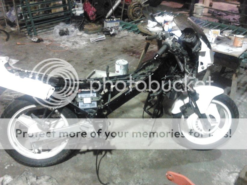

    I put the motor in the bike last night, was a full all nighter. Used the new carbs on the old heads that are bolted to the new block which is using the old sump. The drilled and tapped oil feed lines, mismatched cams (used the newer ones, less marks on them), resused headgaskets and whatnot were all a bit of a worry. Lots of work for an unknown.
    I was going to use the sparkplugs from the newer motor because it had been taken care of better and had new plugs. However the new heads use a different size thread for the plugs, so reused my old plugs for the time being. I spent HOURS trying to get spark from the motor. I checked everything and it all seemed fine, I got on the net using my smartphone and found an old article from VTR250.org. Guy was trying to put a VTR motor in his VT250F, he had the same problem and gave up on the old electrics which didn't give me much hope. However I read that he had spark but it was backfiring through the carbs, I had no spark period.
    So after many hours the last thing to check was the VR sensor/crank pickup gap, I know from tuning my racecars it can be a prick of a problem. After bending the bracket slightly I got intermittent spark. Took about 4 more attempts but I eventually got the gap perfect and a steady crack-crack-crack from my test plug.
    After all this I put fuel straight in the carbs from a can, full choke, hit the starter. Fired and died. Put the tank on and after some problems with a blocked fuel screen I had it running sweet. Just needs an idle adjustment. 5am ride in the rain on roads with tar bubbling through, was cracking the rear tyre all over the place once it hit about 9k in second. I'm pretty happy for 30 bucks though, the rear cylinder compression came up after a ride to, rings were a bit stuck from sitting.
    And a quick vid of when I first started it with no exhaust, this was at 2:30 am this morning
    http://youtu.be/mhyb51yt8no
    Another thing to note is I had to cut my lower fairing. The gearshift sticks out lower, works out though because I have a decent sized foot and the placement is ok. The bike the new motor out of was an xelvis I think. Not too much newer but enough they are not perfectly the same. I think I used every tool in the whole workshop making this work. Shoulda put a VF400 motor in it then played dumb getting a WOF Also be interesting to look at a spada engine and the differences there.
    Anyway I'm off to enjoy the spoils of my work because I damn well deserve it at this point I think.
