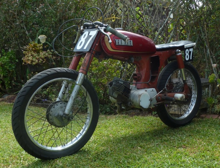

    This is pretty much where we started too.
ID:	276608Click image for larger version.
Name:	SettingUpThe IgniTech.jpg
    This is how we fitted rear set foot rest brackets. hopefully you can see them. PM me if you would like better pictures.
    We found bracing the swing arm worked but bracing the frame did not. The bikes with the most frame bracing handled the worst. Front end chatter was a big problem with them.
    We fitted 2.5 and 3.5 rims, rolled about 3/8" of new thread onto the original spokes, then cut them back when the wheel was laced up, that worked out ok. The thin rear axel from the GP100 bent when pushed hard, the 125 one seemed OK.
    We had gas shocks on them that had to much gas pressure, so the compression was to high and rebound to low. Didn't find that out until it was too late. Emulators in the front forks, GT185 front end worked better than the GP125 one.
    We have kept our old GP frames as Chambers reckons that with a bit of suspension development they could be made to work better than we had them.
    Best of all these may be eligible for Post Classic tiddlers to be run with the CMRR soon. They would need to be dressed up to look like period racers. But you know 26-28hp is easily possible so they would be pretty competitive.

    Thanks Henk, thanks Rob! I shall keep that in mind. The GP125 for now is an as low as possible cost machine for some build fun and to learn more about 2 strokes and setting up a bike. Hopefully one of my friends can ride it whilst I'm racing the FXR for now.
    I'm very curious to hear the more you braced the frame the worse the bike chattered in the front end.
    TBH it seems that the more they were braced the worse they were, mine would chatter very violently front and back, it was so bad it would throw my feet of the pegs and hurt my back.
    The one that was ridden the fastest was basically std, except for foot rest position, both had proper rims and slicks, never figured that out.
    My guess is that resonable rear shocks and fresh oil in overhalled front forks would be a good start.
    They are good till they let go, and if you have improved the point where they let go they let go more violently.
    I think a basically std frame and attention to the suspension would give you a resonable ride.
