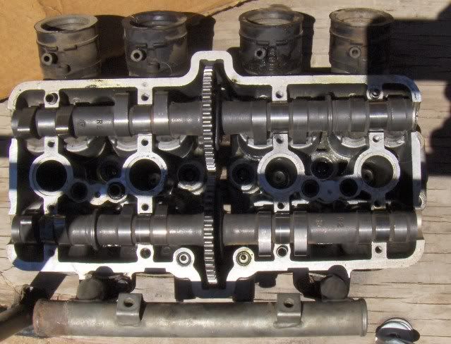

    It's quite possible a mild shrink fit on the sleeve would hold the torsional load, but I wouldn't trust it. Oldham couplers would be nice, if yo ucould buy them off the shelf, (fair bit of work to make) and if you had room to swing them. You dont. The simplest way to form a mechanical drive that'll fit in there is to pin a sleeve radially through the shafts both sides of the joint. I'd use taper pins, nominal dia about 5mm. Pre-assemble the shaft and check run-out and timing before reaming for pins.
    All you need to do that is a lathe and a drill press, easy. I've got taper reamers if you decide to go that way. And pins.
    Bummer, I expected the oldhams to be "relatively" straight forward.
    Mr Bogan, do you reckon you can manage the idea Ocean1 has mentioned here? If so, I may have to send some cams your way
    What diameter is the shaft at the join? And what clearance does the standard shaft have from the oil runner?
    Will get the measurements next week, still 450km away from the bike
    Bore through the centre of the camshaft, cut the shaft and put a spigot inside, give it a decent chamfer then bronze the thing back together in correct alignment
    H-D did this with the rocker shafts on the original XR750 motors to get the angles right after shortening the 883 cylinders, so it's not like it's never been tried
    Don't quote me on this yet, but I think the ZX6/ZZR runs a hollow cam, but not for oil like Hondas of the era. This, to my noob head, seems like a good idea.
    I found those links last night after much trawling. I may be getting a little obsessed with this...
    Quote Originally Posted by Brian d marge View Post
    Im worried about the loading , while its not reversed it is repeated and again while the movement isn't big , the frequency is high and fatigue may be an issue, as well as the interference fit remember it will be running around 100 deg c more or let , which will affect any interference fits
    the last idea with the bronze with a sleeve seems the most sturdy , but until you have an idea of the loading .....
    Do a free-body diagram , then a loading diagram this will help you making a decision,
    just my concerns
    Stephen
    Cheers Stephen
    I... errr... have no idea what these diagrams are, moar google for me!
    Edit:
    I really like the simplicity of Ocean1s idea, I think I'll have to get the measurements done, then look at it
    The biggest issue I'm seeing here is I need to cut it where the locating ring is on the exh cam.
    Will have to see how much clearance there is and if the sleeve can be made with the raised thingy in it
    This shows the bit I'm waffling about http://img91.imageshack.us/img91/3116/dscf0891.jpg
    The intake side has it on the gap between 1 & 2, so no issue there
    Bling your bike out!
    PM me

    More pics to make my silly idea even closer to reality...
    I'll look up the spec for the cam journals so we have a vague reference as to the sizes of what's in there
    Yeh the hard bit will be the setup. Once I get em held in the lathe securely it'll be easy enough. Then again getting the setup right for pressing and pinning. You might have to buy me a boring bar though... and maybe some telescopic gauges too...
    Yeah, that might be a problem, the ring is about the diameter you'd want for a sleeve. If that makes it too hard to sleeve you migh need to look at an alternative, like either a dowel and braize joint or building up the lobes and getting them reground.
    I wanted to avoid re-ground lobes if possible (I'm a cheap bugger)
    I suppose, because the cam seems to be hollow, I can't have it machined down quite a bit and press fitted
    What's the likelihood of a braze joint warping the cam?
    Similar risk to welding, you'd still want to jig up for it.
    You might want to think about hard soldering it, also. Joint prep might look like below.
    As for cost, pretty much any way it could be done would be cheaper than having the joint fail.
Name:	cam joint.JPG

    What about modifying the locating groove? It's only on the oil feed and is a separate arm, there's no locating groove for the cam on the head. It could possibly be machine to accommodate a press fit sleeve with a locating ring machined on it?
    Or cut the locating groove thingy off and have another made that is bolted to the oil feed gear
    Cut, bore both pieces using a travelling steady to hold the long piece. The cam is hollow simply to save weight - the insert doesn't need to be anything clever, mild steel will do, and it'll silver solder too. Pin it as well. The load, while interupted, isn't actually that great - i'd point out the huge number of cam sprockets which have been slotted and are held in place very effectively with two 6mm screws...
    i disagree with the cost of failure...which ever cam breaks, the short end is going to stop with valves closed IMO...may be lucky and have no valve damage at all...If this actually works though, I'd not give a lot for the cush drive's chances in the back of the clutch.
  13. #118

    So, if I run an internal one with pins/weld, would it be wise to put the pins through before brazing the joint?
    Could it even be possible to run a pinned internal rod, without weld?
    Right you are gov'nor, see pic. Edit: you'd want to machine the shaft OD first.
    With Easyflow or similar you'd make most of the length of the joint about 0.05mm clearance, with perhaps the centre 4mm of the pin size for size. Tin the pin and cam bores, lay it into a simple jig to keep it aligned and timed, heat it up to about 650c and push the lot firmly together. As long as the surfaces are tinned properly that won't move, but it takes a mere 10 minutes to cross drill and ream the assembly and fit taper pins.
    Editedit: You could probably use the same technique with the appropriate loctite instead of solder.
Name:	cam joint R1.JPG
    I think this is the nicest sounding idea so far.
    If I can pull this off, I'll have to owe you a beverage too
    Nice and simple, I like simple
