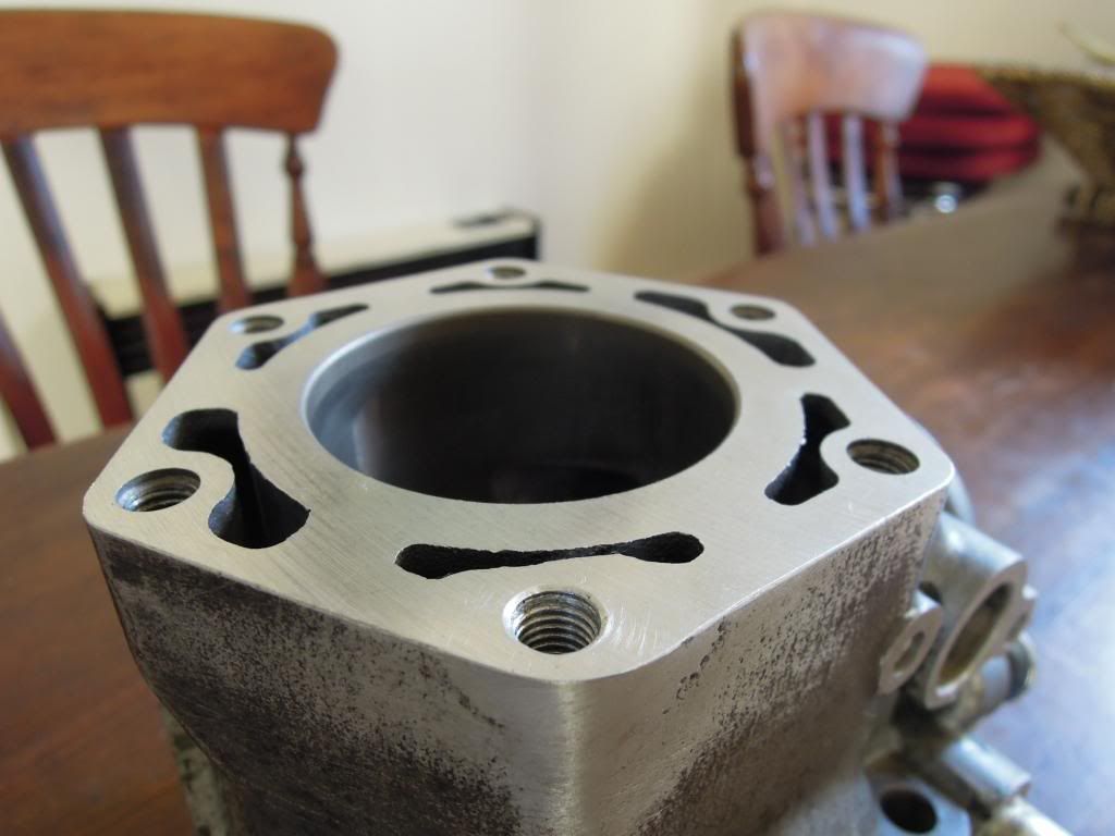

    There goes my only good cylinder. Ah well, this shit happens. Anyone got any barrels?

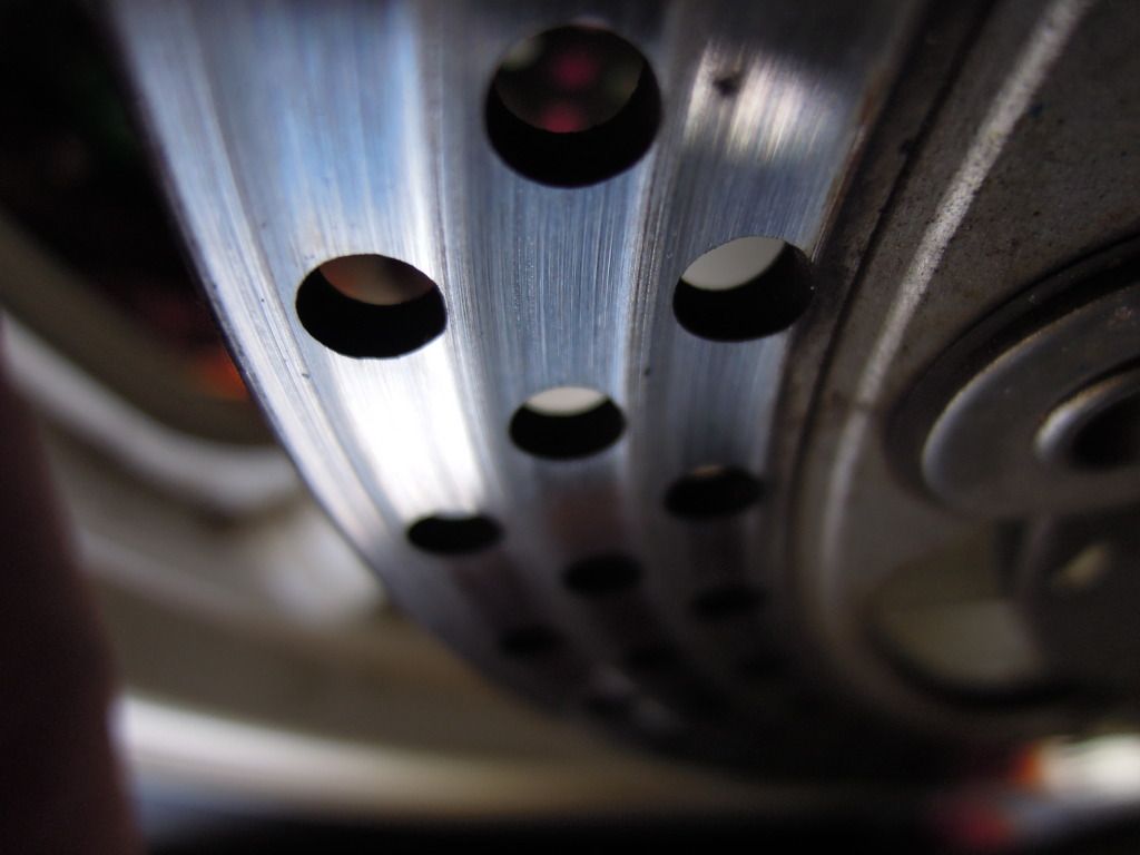

    Brake discs arrived today.

    Installed, and the system bled. Just the rear sets to go, and we have a fully functional roller.

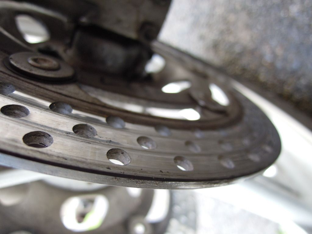

    What are the old ones like?
    I need another for my bucket, doesn't have to be flash...

    can that cylinder be welded and re taped ?

    Old discs don't look good. They've got big u-shaped grooves worn into them.

    Quote Originally Posted by Neal View Post
    Actually I think it would be possible. I'm gonna get it done and see how it turns out. May as well try, as the cylinder is scrap as it is anyway.
    They all seem to do that.
    How thin are they at the worst point?
    Mine were looking 'not good' before the last 3 years of hard use, I'm thinking I should get some less rooted ones soon...

    They look to be about 3.45 mm at the bottom of the groove. They're yours if you want em.

    Cylinder repaired:

    That's the way !

    Cylinder repaired:
    Looks professional, more info?
