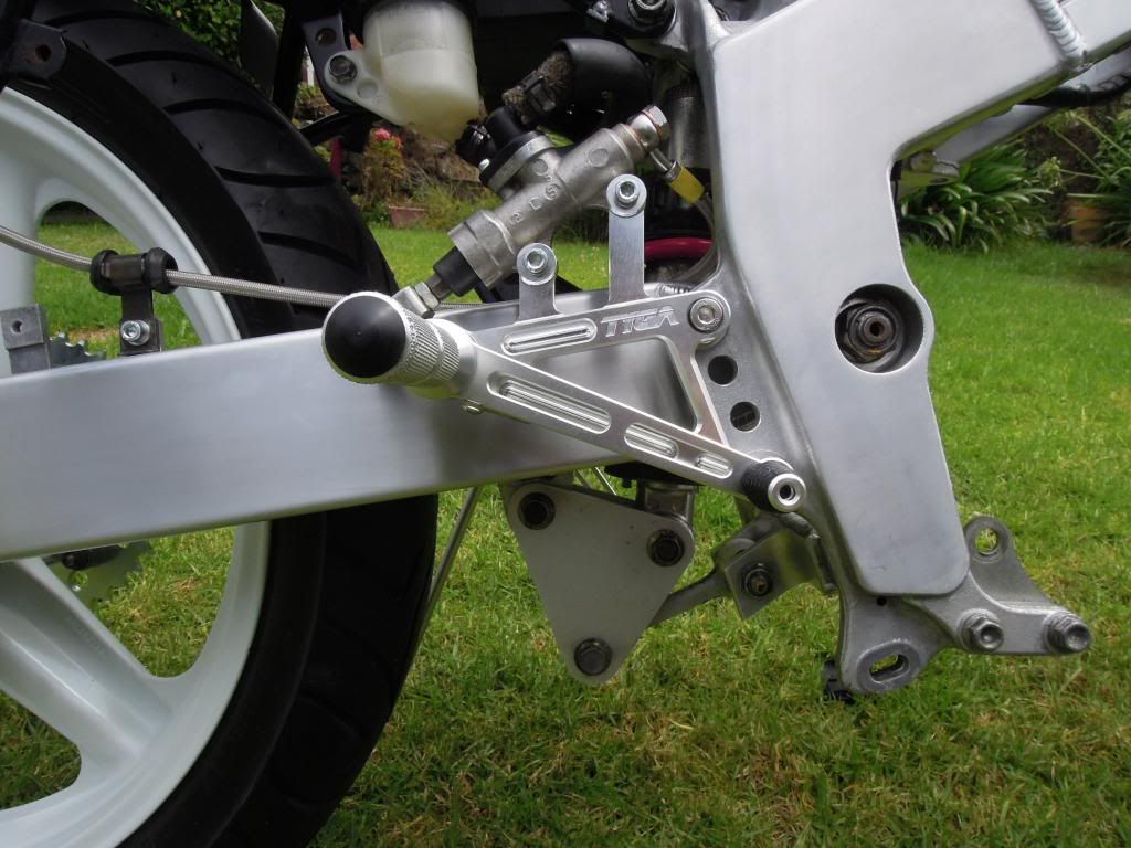

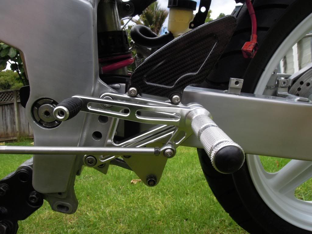

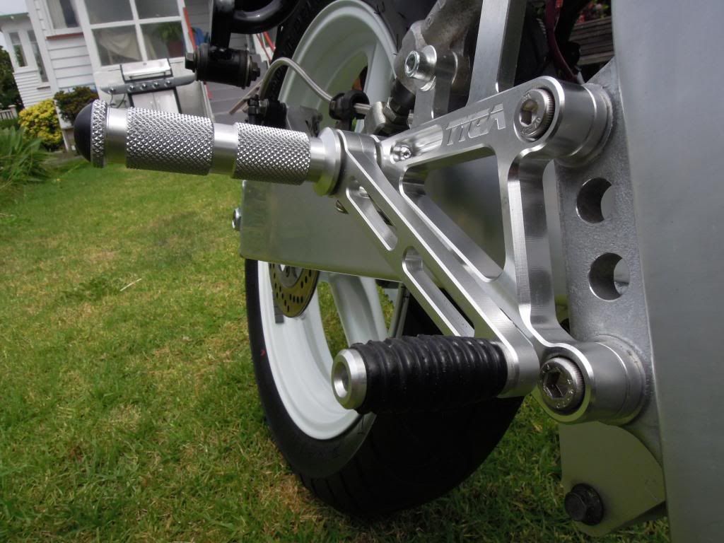

    The Tyga Performance rear sets I ordered, arrived today. Spent the morning installing them and bleeding the rear brake system.

    Looking very good !
    use some Loctite on the small " toe " parts of the gear change and brake pedal , mine vibrated loose once before .

    Quote Originally Posted by Neal View Post
    Looking very good !
    Thanks for the tip Neal.

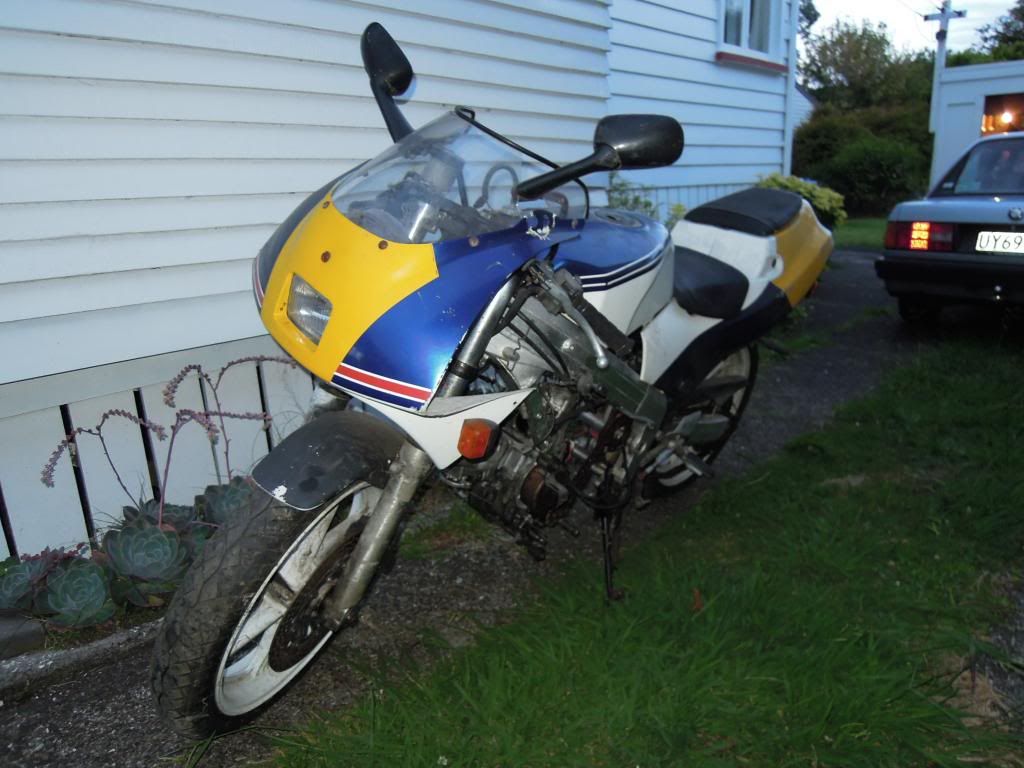

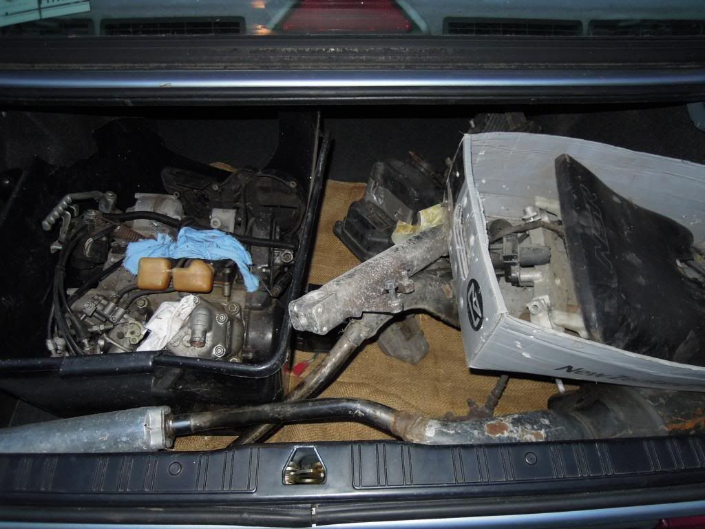

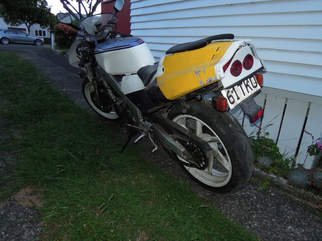

    Stoked! I just scored a complete MC18 R5K + spare motor for a very good price.
  7. #67
    9th June 2008 - 21:31
    XR650R, Bucket
    98

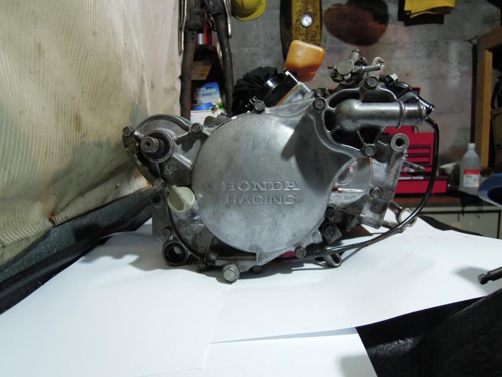

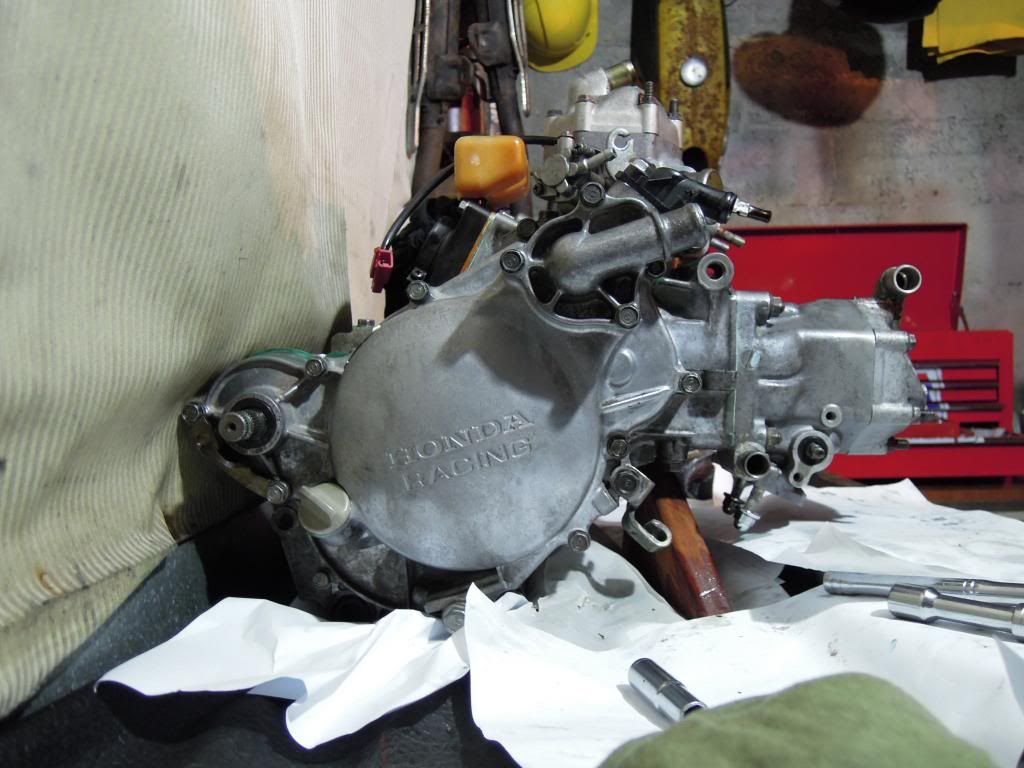

    Here's what I got:
    Spare motor and other bits:
  8. #68
    13th September 2012 - 07:48
    1991 NSR300
    In a house
    79
    Oooo your hooked now !
  9. #69
    XR650R, Bucket
    98
    It was an unfinished project, the guy spent 2800 on it apparently. Ended up giving up after his mechanic botched the engine reassembly and caused a crack in the transmission part of the case.
    I've already split the cases on one motor. The crank feels good, he said it had new seals and some other work done but he couldn't remember exactly. All the gaskets and crankcase sealer look fresh, so there's definitely been some work done that's seen very little use.
    I'm going to re-use that crank in my motor. I'll be tempted to replace the right side bearing though, as it's a bit noisy. Do you know a source for these Neal?

  11. #71
    1991 NSR300
    In a house
    79
    I have looked for main bearings before and found some that will work except that they never had the pin in them . Until now I have not used a rebuilt crank only new or very good 2nd hand ones . Finding someone to do the work I wanted done to convert and modify pins was impossible in SA .
    In a few months time I will start to play with cranks again . Deet is the only one in know on this side that can supply nsr bearings .
    I use a syringe with some 2T oil to place a few droplets in key places when I bolt things up .

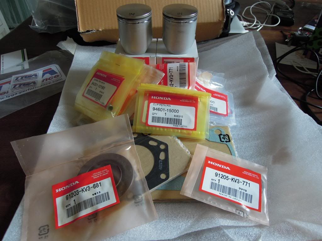

    We have power...electrical power. Petrol power coming soon, pistons and gaskets will be ordered before the end of next week.

    Mmm, shiney new top end parts, plus new crank outer seals as I discovered the old ones were actually the wrong size.

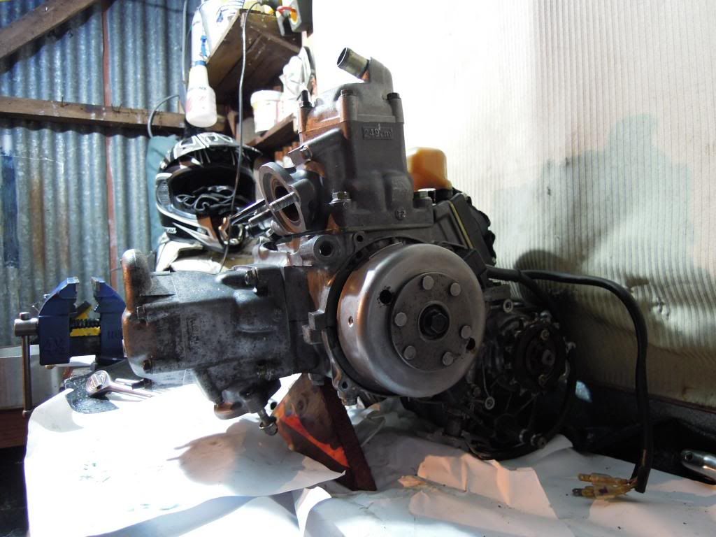

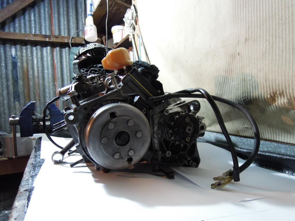

    Bottom end re-assembled:
  15. #75
    XR650R, Bucket
    98
    And the top end:
    Cylinders have been professionally honed. The top one looks almost brand new inside. The bottom one good, with some minor scoring. Power valves and exhaust ports have been de-carbonised.
