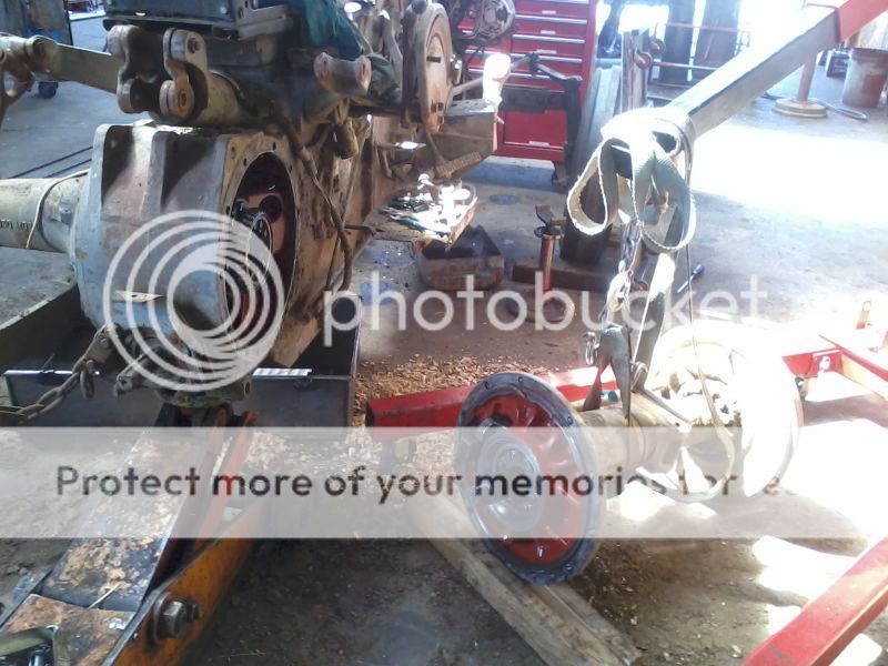

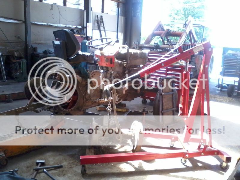

    Looks too small for a 165....lights are low in the grill. Went looking for a full half turn freeplay, and looked at the steering box first, so all that area is apart too....then saw where all the extra movement was. The other Fergy has totally flogged out bushes and pins in it's front loader bracket, never seen grease since it was new. By the time we cut the brackets off, make new ones and weld them on it might be a better bet to buy a new one.

    It's a 245! Today I took the trumpet housing off to replace the lower 3 point linkage pin - 30 seconds to replace the pin, 2 hours to get it apart, and 3 hours back together. Some bugger had welded the left guard to the ROPs! The 390 got a new spear in the front ram, and some fuel leaks fixed.
