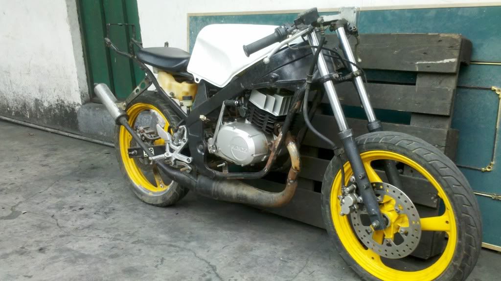

    here are some pics of my bike, what do you guys think??

    Thumbs up Looks like your off to a good start!
    May need to do some work on the tail section of your beastie, not pleasant to have something smack you in the back on the off chance you dismount awkwardly.

    It looks like a good start.
    You should definitely try and get a few mates out there.
    Nylon (or similar plastic) crash protection my be a good idea to avoid issues with track damage.
    It would be quite cool if you had a few people all start with the same engine if they are cheaply available new.

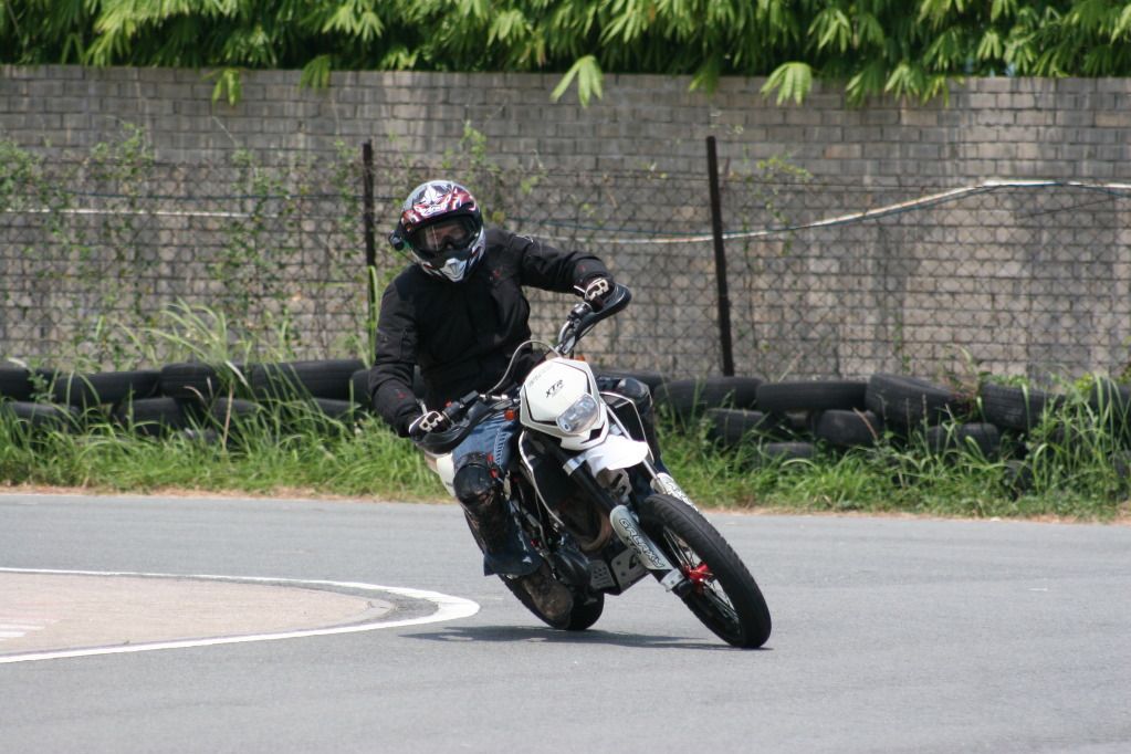

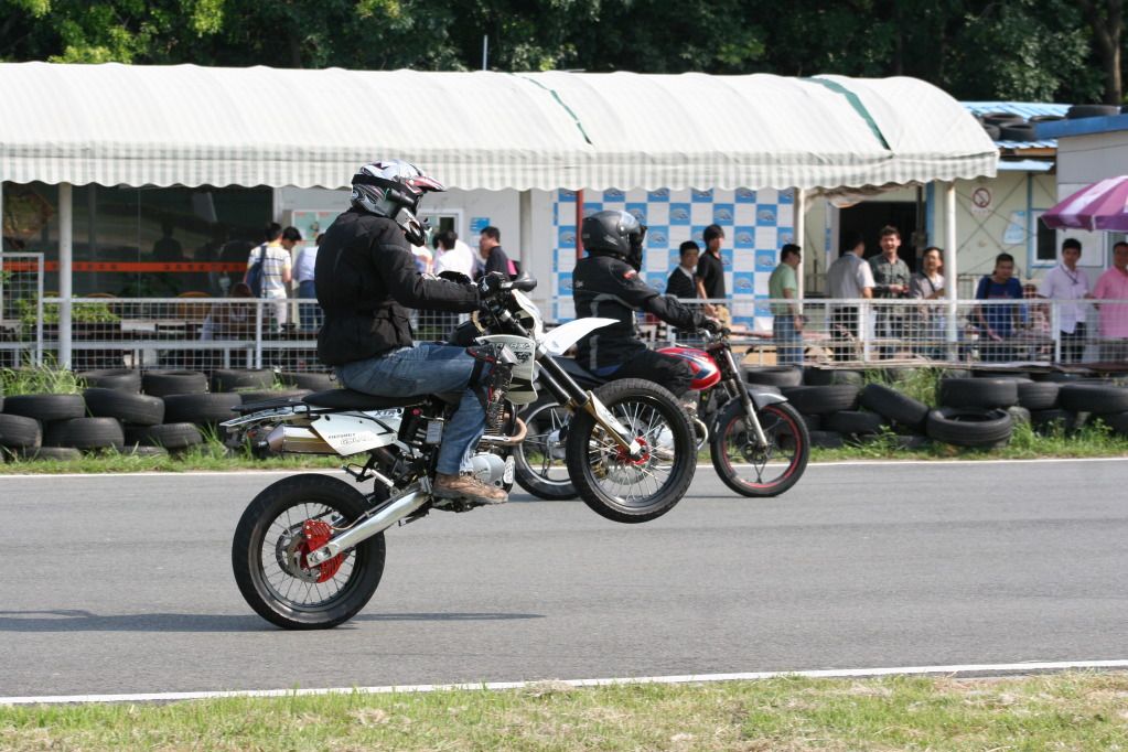

    Any input is very welcome and i'll try and keep you guys updated as we go along, here are a couple of pics from last year

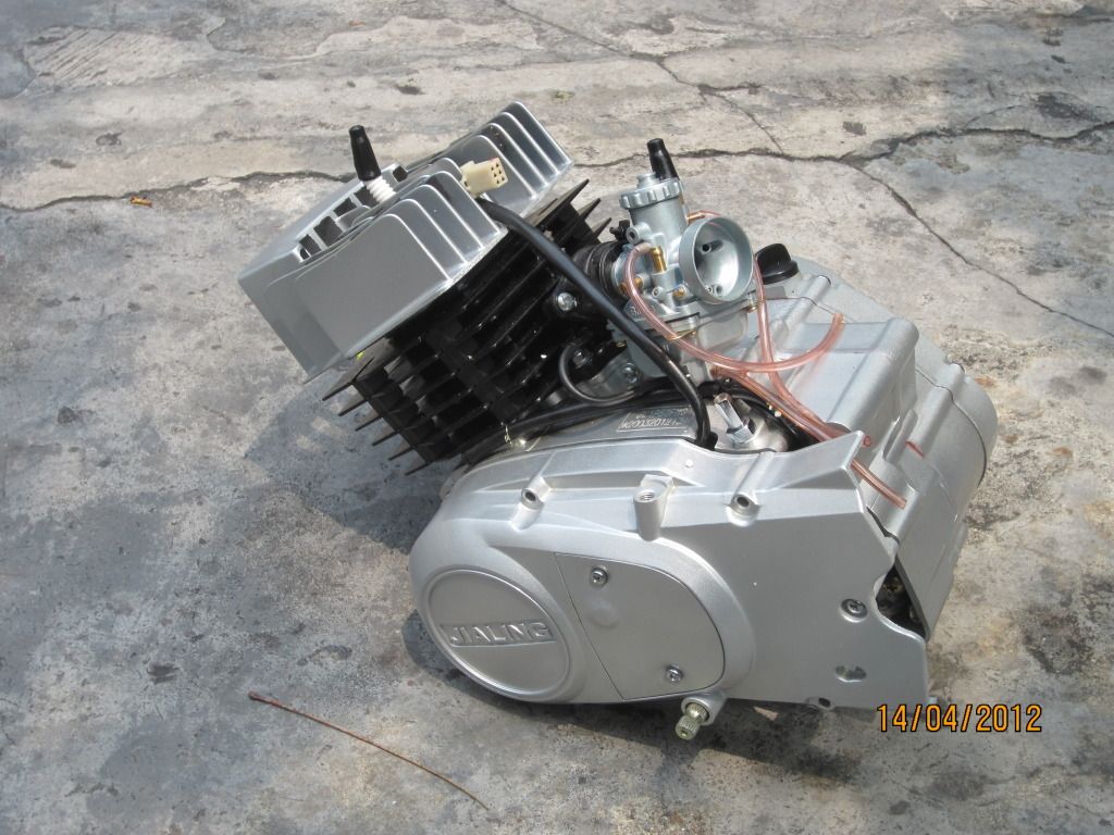

    Just an observation but the pipe has a very long header & obviously just munged onto the std bend.
    Really you need to set up the design parameters of how far you can rev that engine & what sort of maintenance schedule you are happy with.
    I always worry about the quality of non Japanese assembled engines + any engine that has sat around can have damage to the big end bearing so that it expires if you give it too much grief. On top of that they have like a 4 speed gearbox don't they? I'd not want to be revving it further than 11,000 unless you were serious on up-rating the rod.
