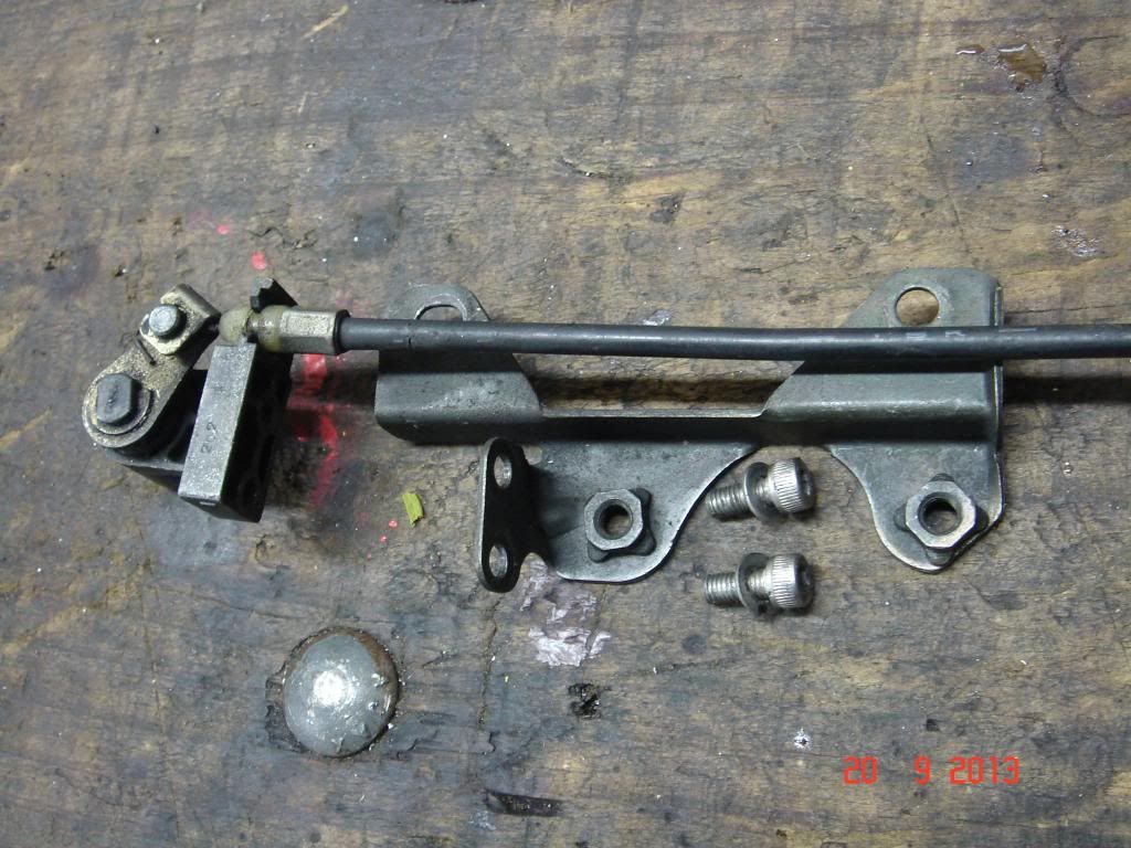

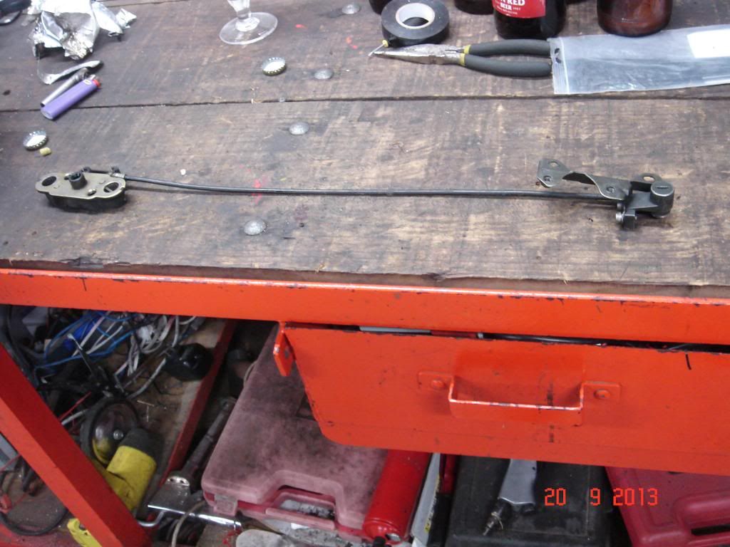

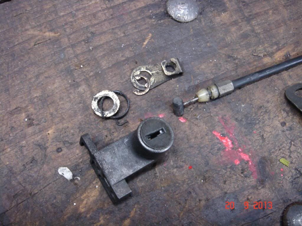

Did a bit more today... after work on a Friday, beer in hand and time slips away.... Hell... wake up dude... Im not that boring, cause right now the wife is chasing a 8yr and 10yr old boys around the house trying to get them in to bed.
Women yell, boys run, screams, yelling, death treats, "Into bed... "I DID TURN YOUR ELETRIC BLANKIT ON" loud, "YOU ARE NOT LISTEING" all bad. My head is getting very low and I sneak to the door and shut it. Done, turn up the stereo and I know nothing.
Nothing is my fault. I am innocent.
Clean it and use it, or strip it and make it mint?
Only one choice if it can be pulled apart... do so.... works on the wife

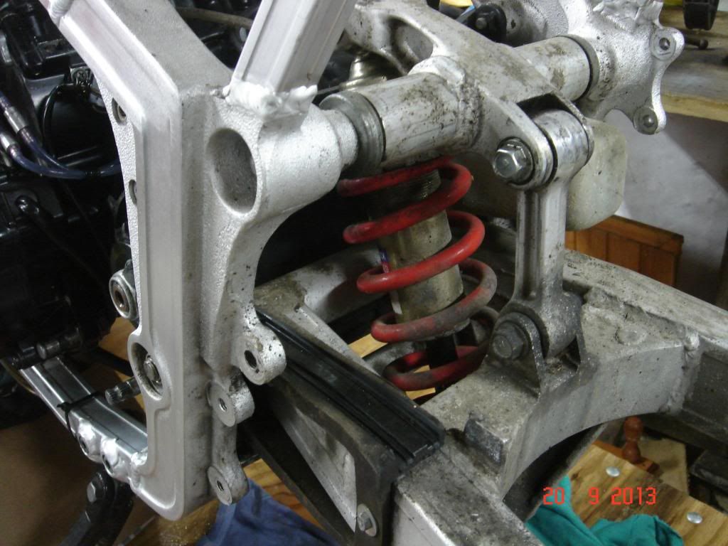

A good find.
Always thought the bike had a good ass.
