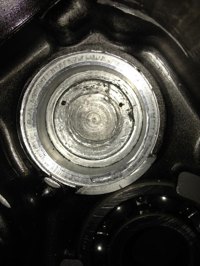

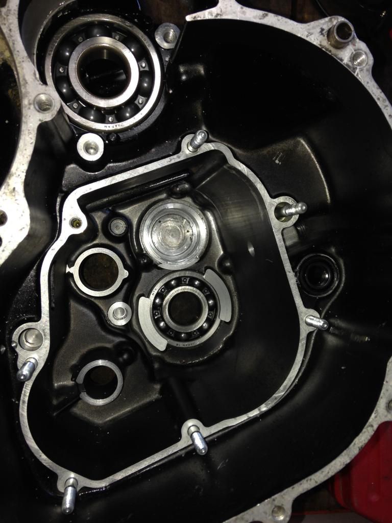

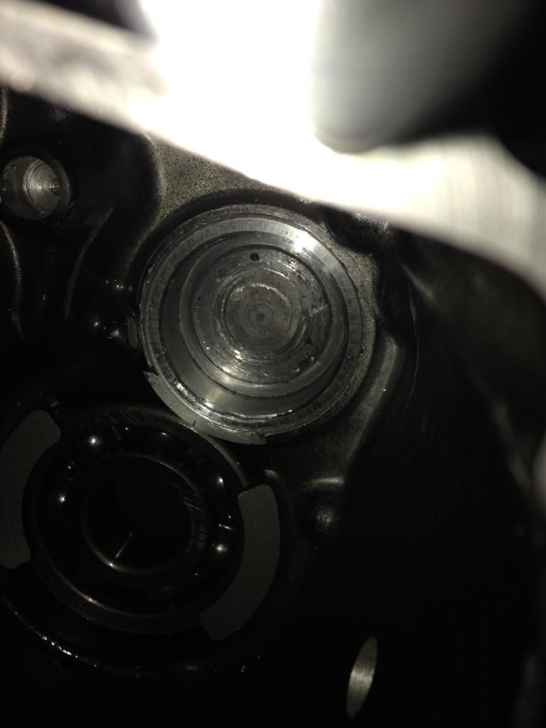

    With out further delay I show off my repaired crankcase.
    No more spun bearing.
    Bored, sleeved and only 0.1mm taken off the bottom bearing land and 0.1mm off the bearing sleeve base.
    Dude had to make a custom boring bar cause of chatter and whole job was $300.
    Oh and the dude is a classic bike nut.
    Repair is amazing.

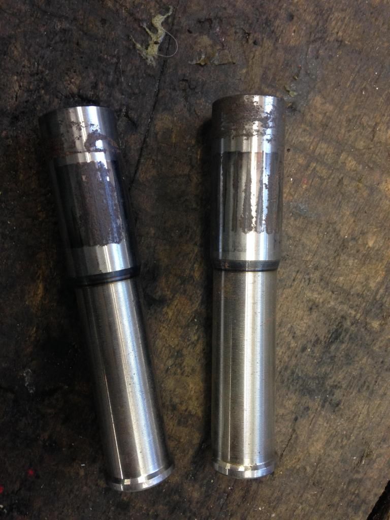

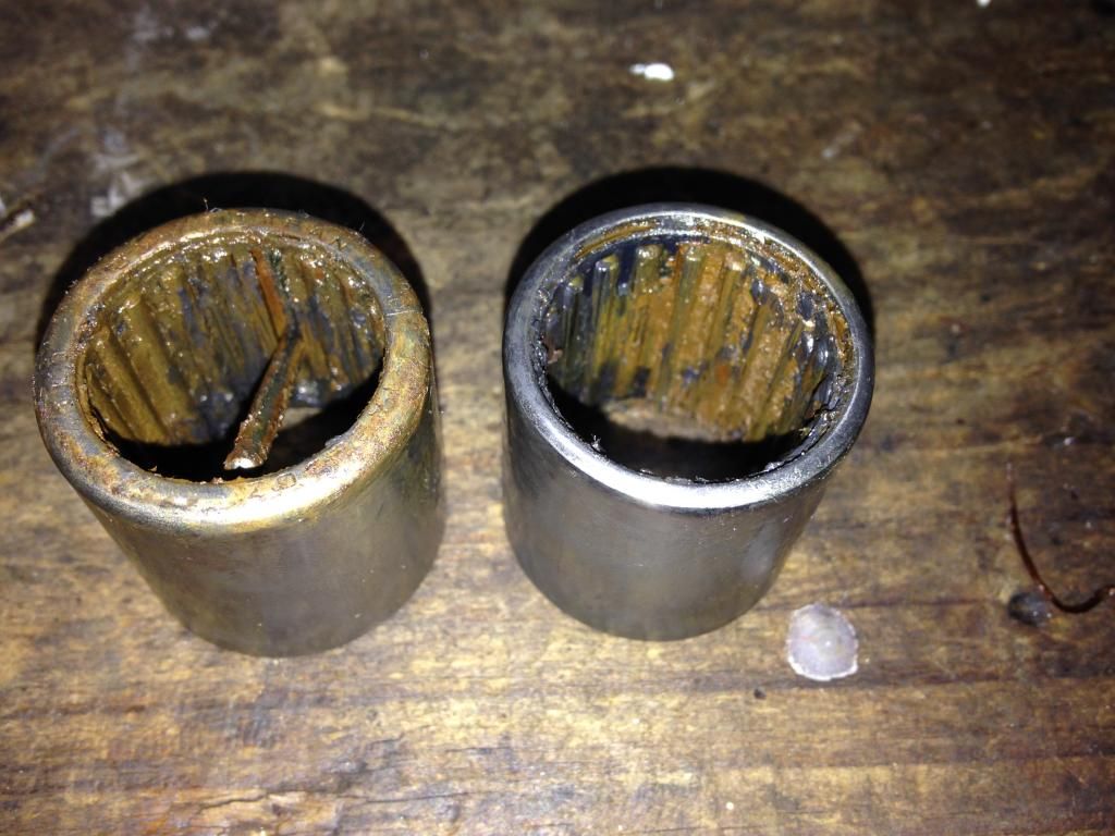

    Odd swingarm bushes..
    may have seen better days, only good for throwing at the wife now, eggs what is so hard about eggs?
    Every bearing and seal will be replaced, getting a woody just handling these bits.

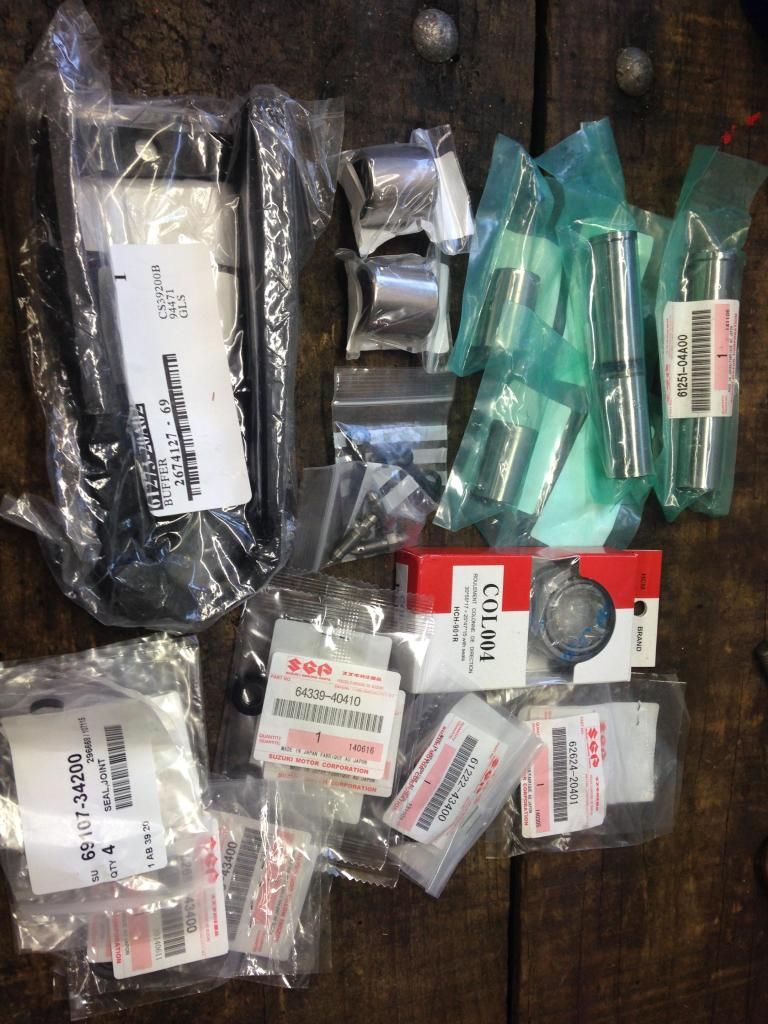

    I am thinking.. can I re use these?
    A wash with some petrol and add a little grease, great for another 20k.
    Nope, in the bin, new swingarm bearings sorted.
    If only I had a swingarm ready to go!

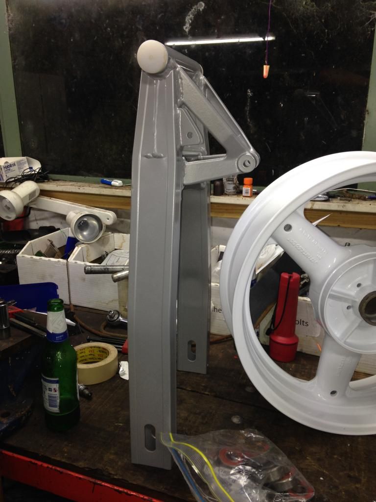

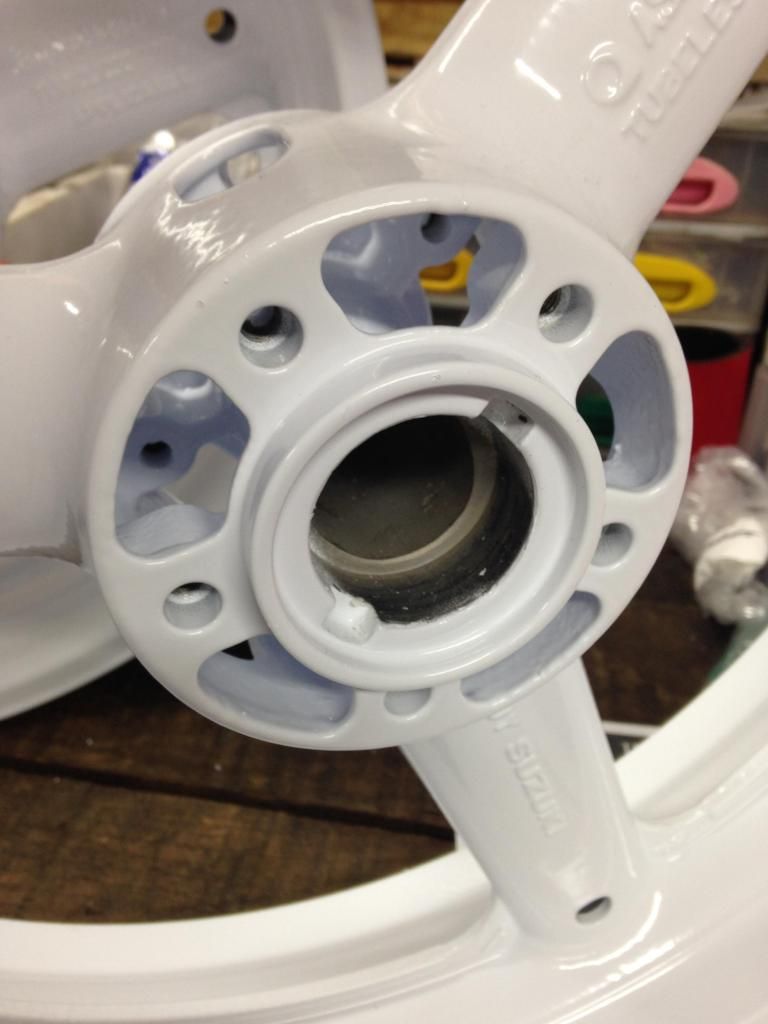

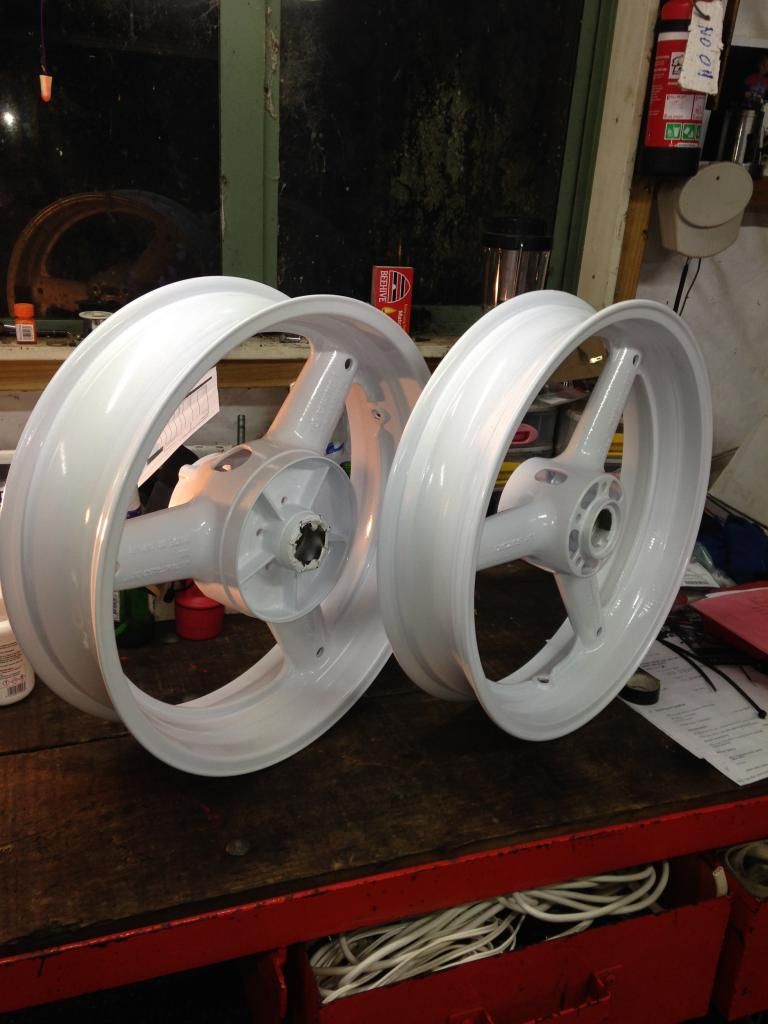

    Rims powder coated with a urethane powder coat, much better lasting than standard powder.
    Like normal I should have not been lazy and taped everything off... now I have to sand all the powder off where the discs go.
    What no swingarm pictures!
    will follow.

    Rims and swingarm cost $100 to be powder coated though a mate so that's mega cheap and appreciated.

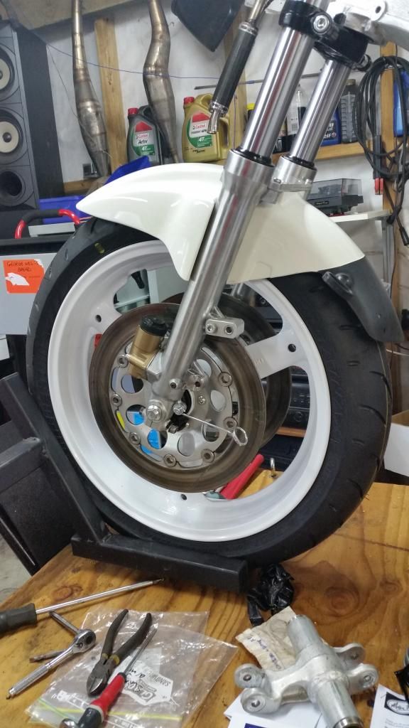

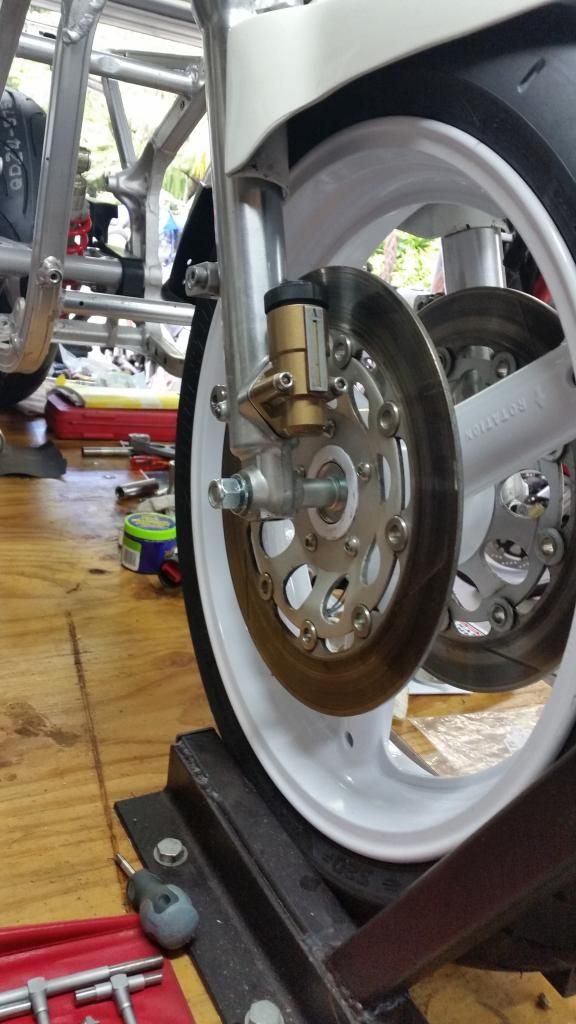

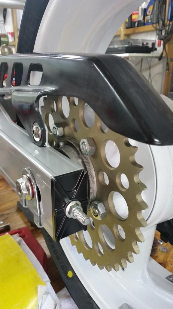

    BUT there is a time in your life when you just ignore all common sense and just do it....(Christmas is a great time as money is just spent - tyres are hidden in the festive spending period) RG got new tyres as did the GSXR11 which got a new rear. Yep three f#cken tyres in one go. That dam hurt.
    It did not hurt as much as falling off on the kids track at the Honda camp in Jan and breaking 4 ribs. That dam hurt and still does. Home brew, tramadol and codeine is the only way to sleep and that is in a lazy boy chair, cant lay down in a bed and its been 10days.... cant cough, laugh, sneeze (worst) etc

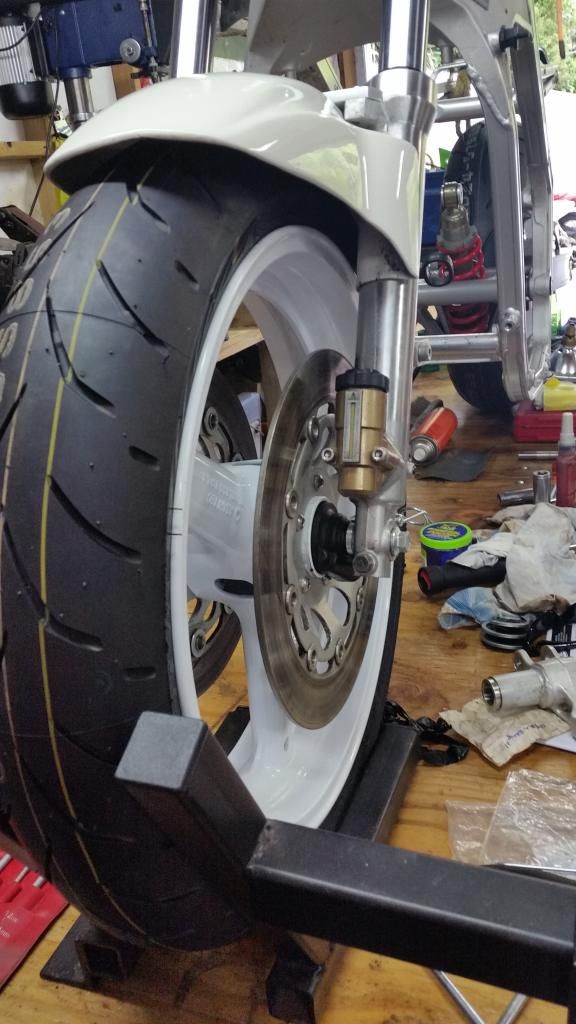

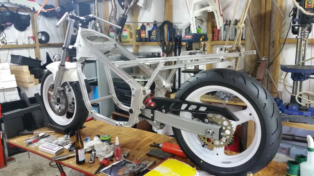

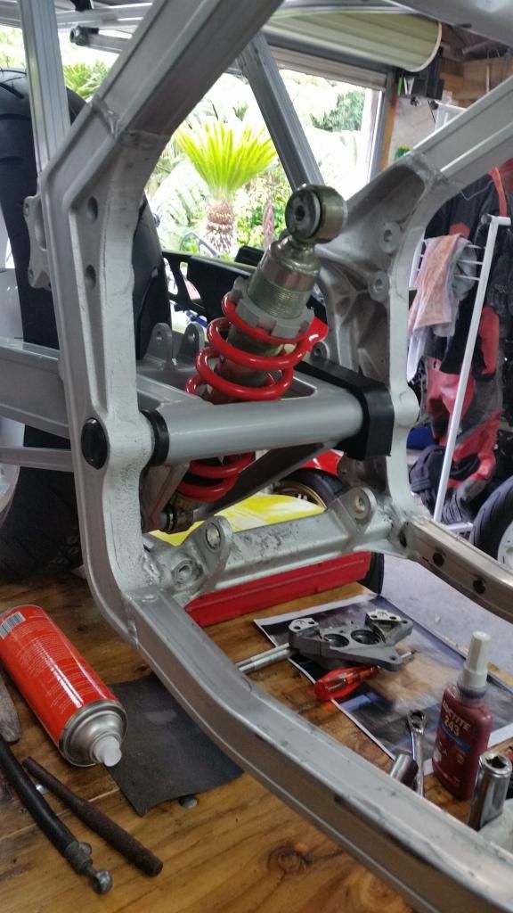

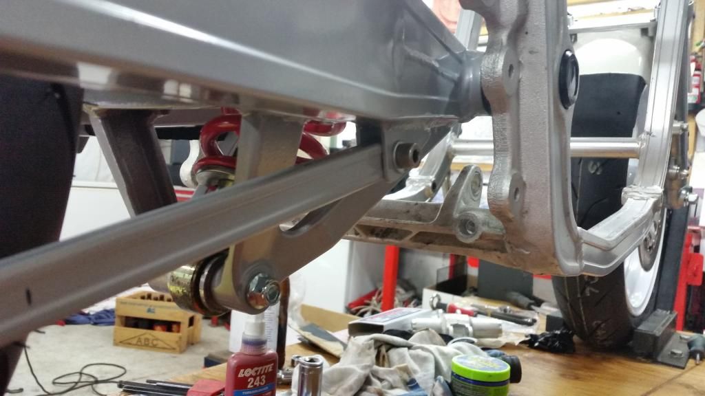

    But I have made progress and it was great... to have a rolling chassis.
    All the bolts have been plated, bearings replaced. Everything new.
    Yes that is red grease on the axel bolt. The sprocket bolts are M10 x 1.25 fine, fitted perfectly in to the crush drive. Just need to get some nice looking nuts. Wife has been saying that for some time but hey I need 5 and are on the look out.
    Front is installed, again everything is new, forks are standard RG forks with Rick lance Emulator kit fitted.
    Discs are RGV250 as are the caliper's still under revamp.
    The aim is to have an RG500 that looks standard but with a modern twist, tyres and brakes with suspension to match.
    So far all good.
    One for the road...

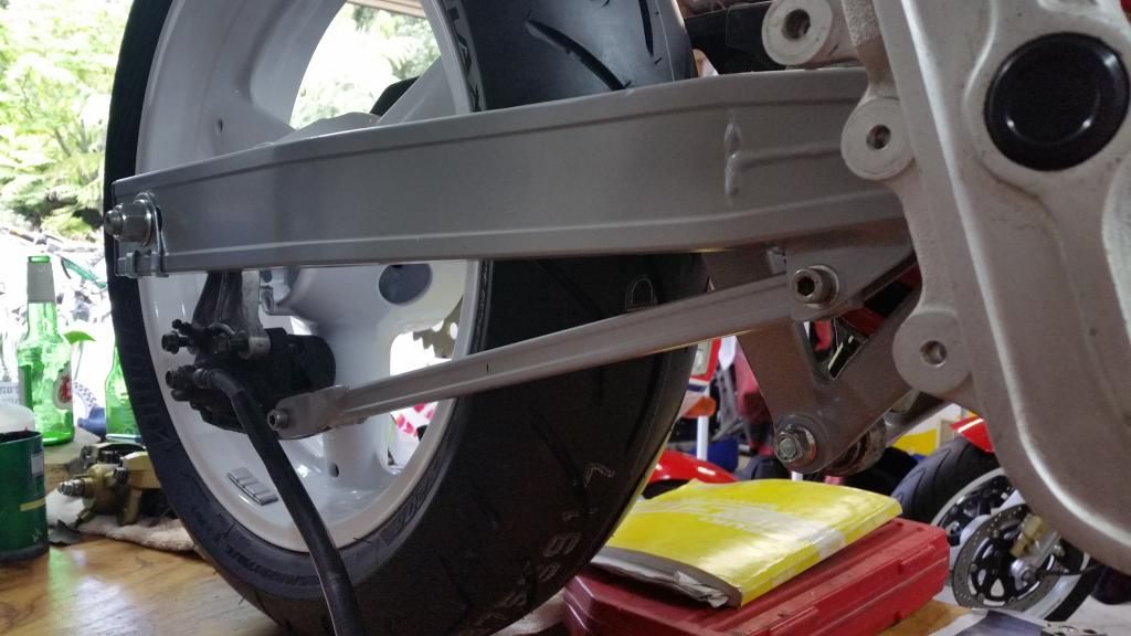

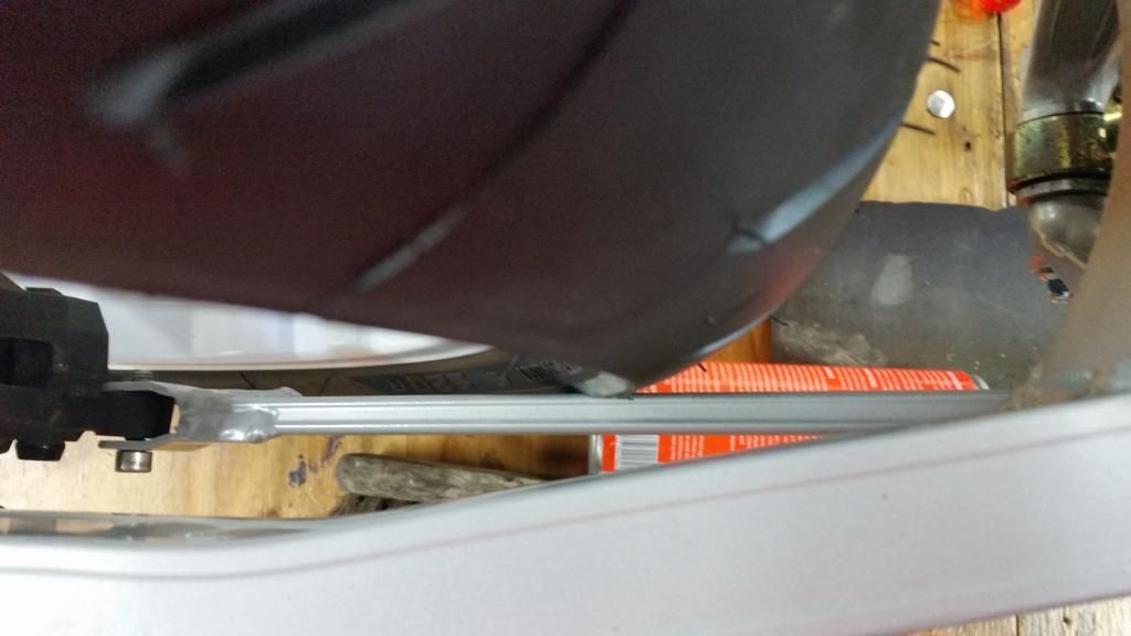

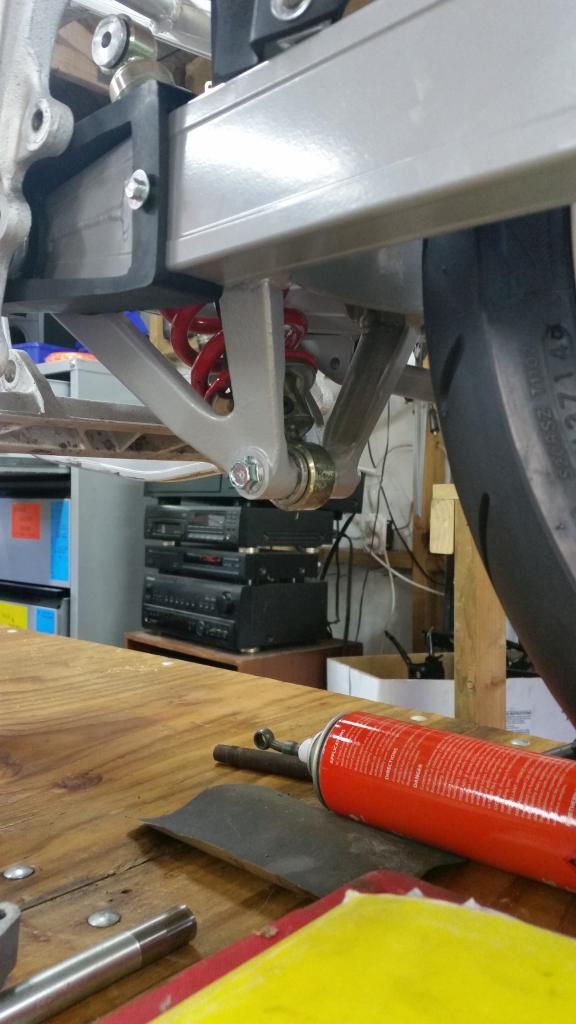

    Looking good...Here is a picture of the new torque bar for the rear caliper mount, the old one went to the frame. No good for the GSX600F caliper.
    Anyone got a GSX600F rear Disc?
    Lets look closer.....
    My worst fear was confirmed.... no the wife has not found the tyre receipt. Worse.
    Interference.
    What a f#cker... I guess a press will bend the torque bar a bit and no one will be wiser. Annoys me that 5mm has caused this issue.
    Saying that when I did my Katana and fitted a 170 rear I had to bend that one too, but I expected to bend that one.
