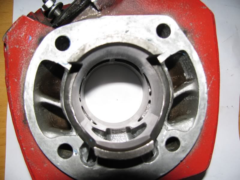

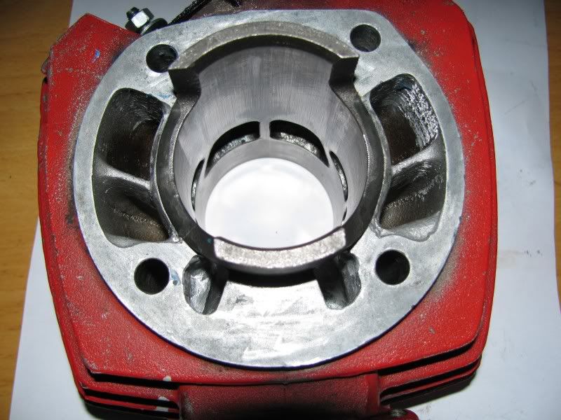

    So what is the carving at the front and back of the skirt bottom supposed to do? Rod non std?
    He's the only one I've got.
    Rod is not standard, carvings are special

    Just concerned about strength of inlet skirt esp as that port is big enough for a 40mm carb.
    Cheers Dave that 2nd one is my Dutch mates , I chickened out well before my hole became over enlarged 😁

    That pic actually looks a lot what a Air cooled Cr80 is like, Not saying its right, but that's how they are.........
    this is moded judging crankcase reed port they are normally two little holes.
    http://i376.photobucket.com/albums/o...Picture008.jpg
    http://s376.photobucket.com/user/per...re006.jpg.html
    can't remember the bore but they are about 48 or 49mm...

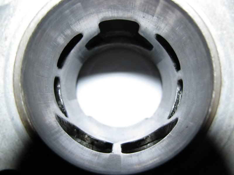

  15. #225
    12,369
    std pics as I find them
