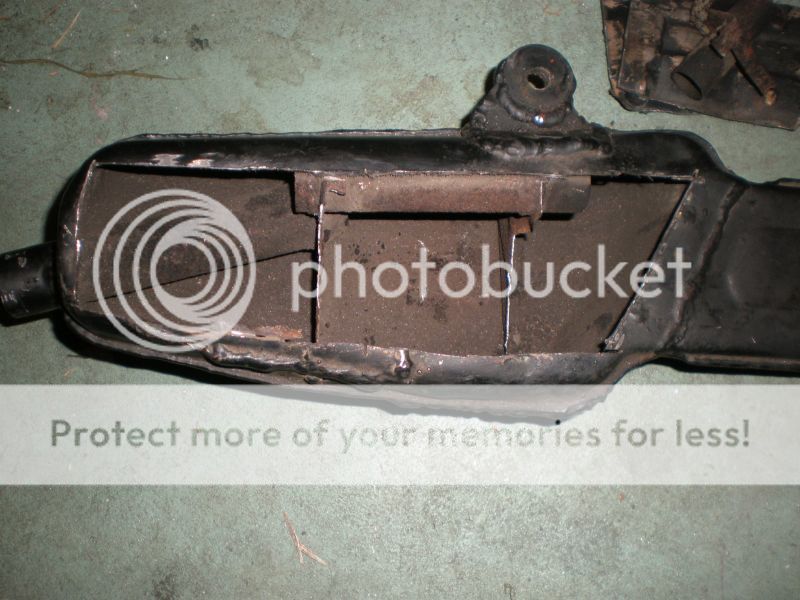

  9. #24
    [QUOTE=jellywrestler;1130607131
    i don't understand your word reversal though Dave[/QUOTE]
    Reversing the flow of exhaust gases, what most normal mufflers do. I cut open my TLR200 muffler the other day - the gases expand into the first chamber, then down the long tube at the top to the rear chamber, back through the small tube to the centre chamber and then out the tail pipe which is connected to the centre chamber. In all the exhaust gases get to expand 4 times in this muffler - you can't see the first part of the system. Controlled expansion,, that's the secret of quiet exhausts.
    Who needs quiet, after more than 10 years I'm opening it up - loud pipes save lives.
