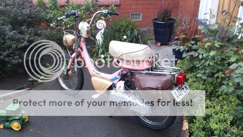

    Well here is pinky
    She got her plate today

    The rough blue anglia has been in my garage coming up 23 years, got me thru school uni etc, I do about 5000miles a year in her
    Pinky used to be blue but got brush painted pink by someone
    Cheers for the post I will keep updates coming

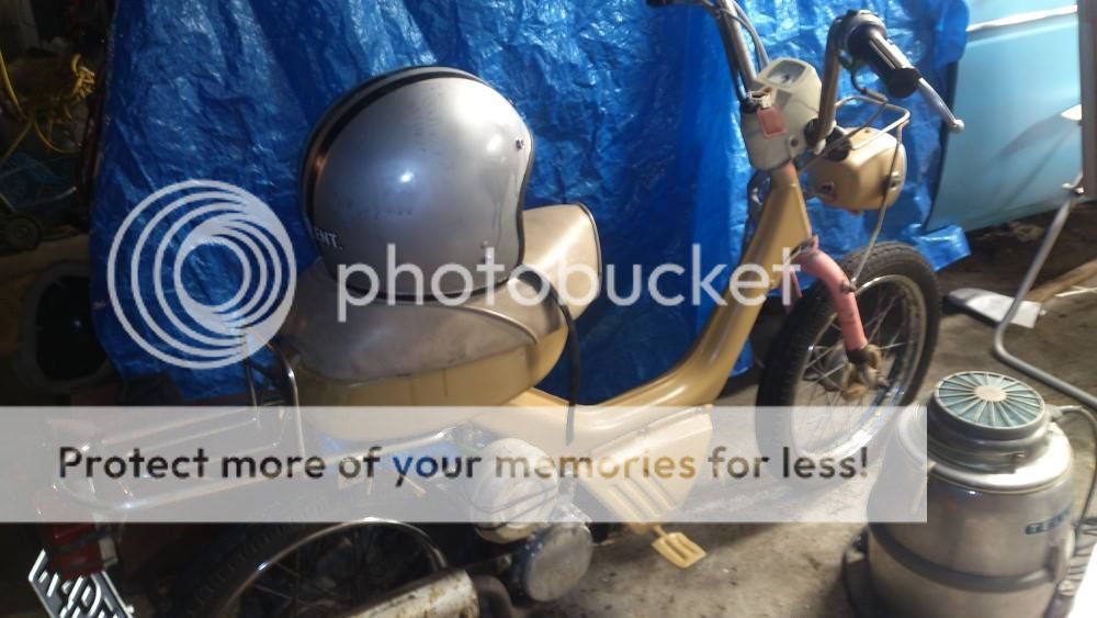

    So I have 2 weeks off and plan to take my 3yr old on his first camping trip.
    I also plan to paint pinky NZ Army Clay (Like the trucks) and the red one will get a lick of red paint.
    If I can get the red one going I will be happy.
    She MAY be up for sale if anyone is interested
    Red one will have all the 'extras' eg leg guards, basket and MAYBE a windscreen (Pics to come)

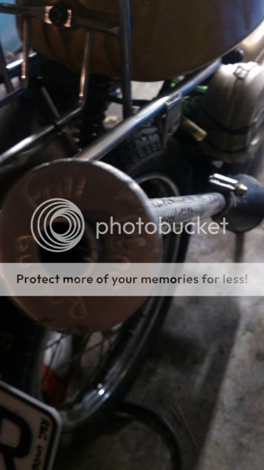

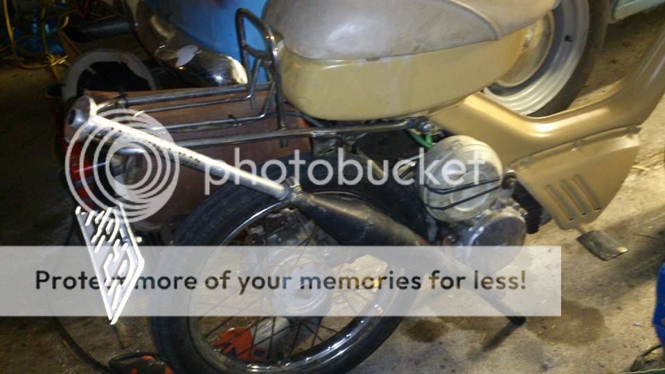

    Went to smash palace tonight
    Came home with this:
    Looks a bit better now I think;
    Unsure of top speed as the speedo broke but I think she is a bit faster
    Sounds fuckin awesome!

    what in gods name is that chamber-thing doing on there? just fyi you can't throw on any old chamber on and expect it to go faster... which it kind of seems you just did. chamber dimensions have to be calculated specifically for the port timing of an engine, and that your jetting has to be fattened up appropriately. maybe i'm wrong though, maybe someone with a few screws loose did in fact make a chamber for the FA, and maybe you did up-jet for the chamber. if not, expect a blown top end...
    13th September 2013 - 10:30
    1982 Suzuki Fa50
    69
    Thats exactly what happened
    chamber was made for fa50
    and it works

    It woudl be interesting to see what difference the chamber makes. The stock 12mm carb is pretty restrictive.

    Yussss! That is so horrible it is awesome =D Good effort.

    she keeps up with traffic in 50km zones now
    tazz thanks man1 she is loud as
    a cop drove past me and stuck his fingers in ears and laughed today, f9ound that epic as
