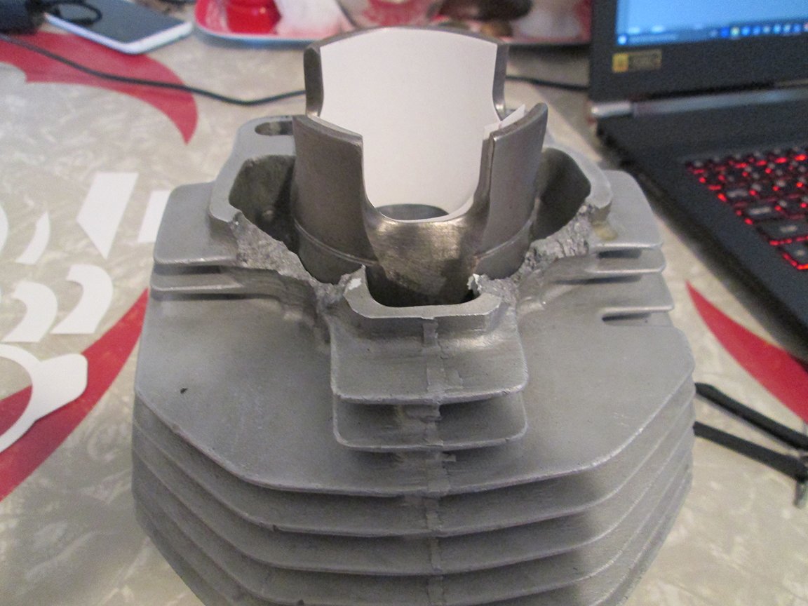

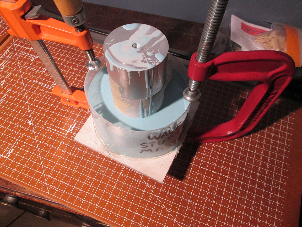

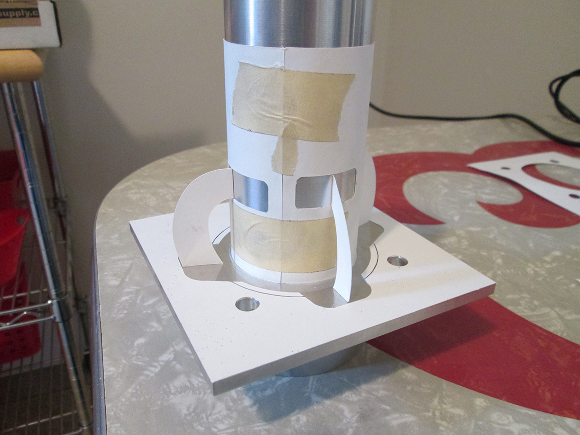

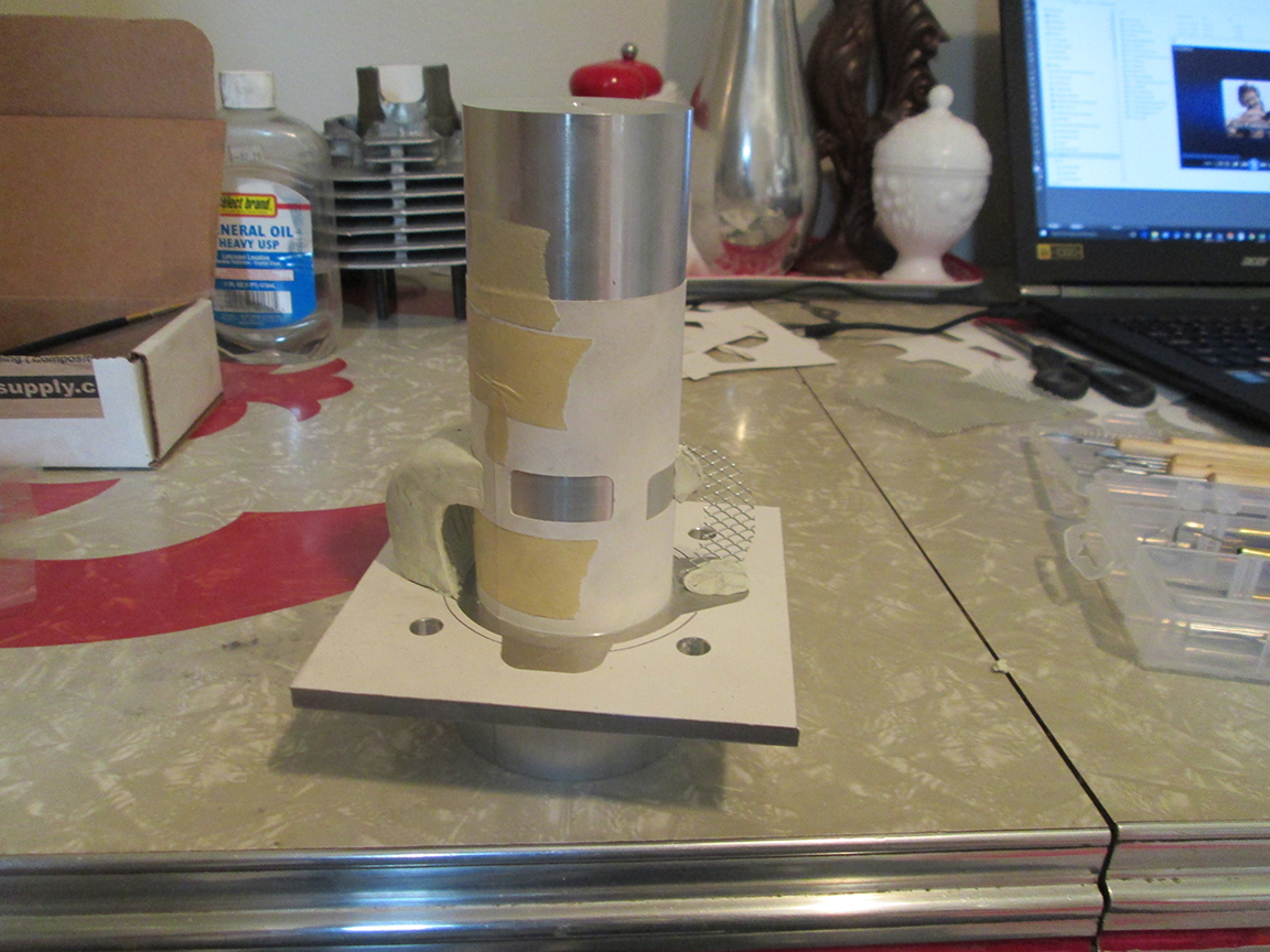

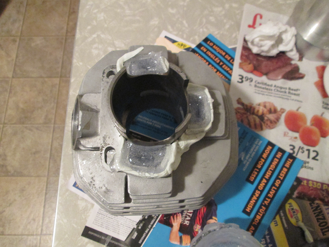

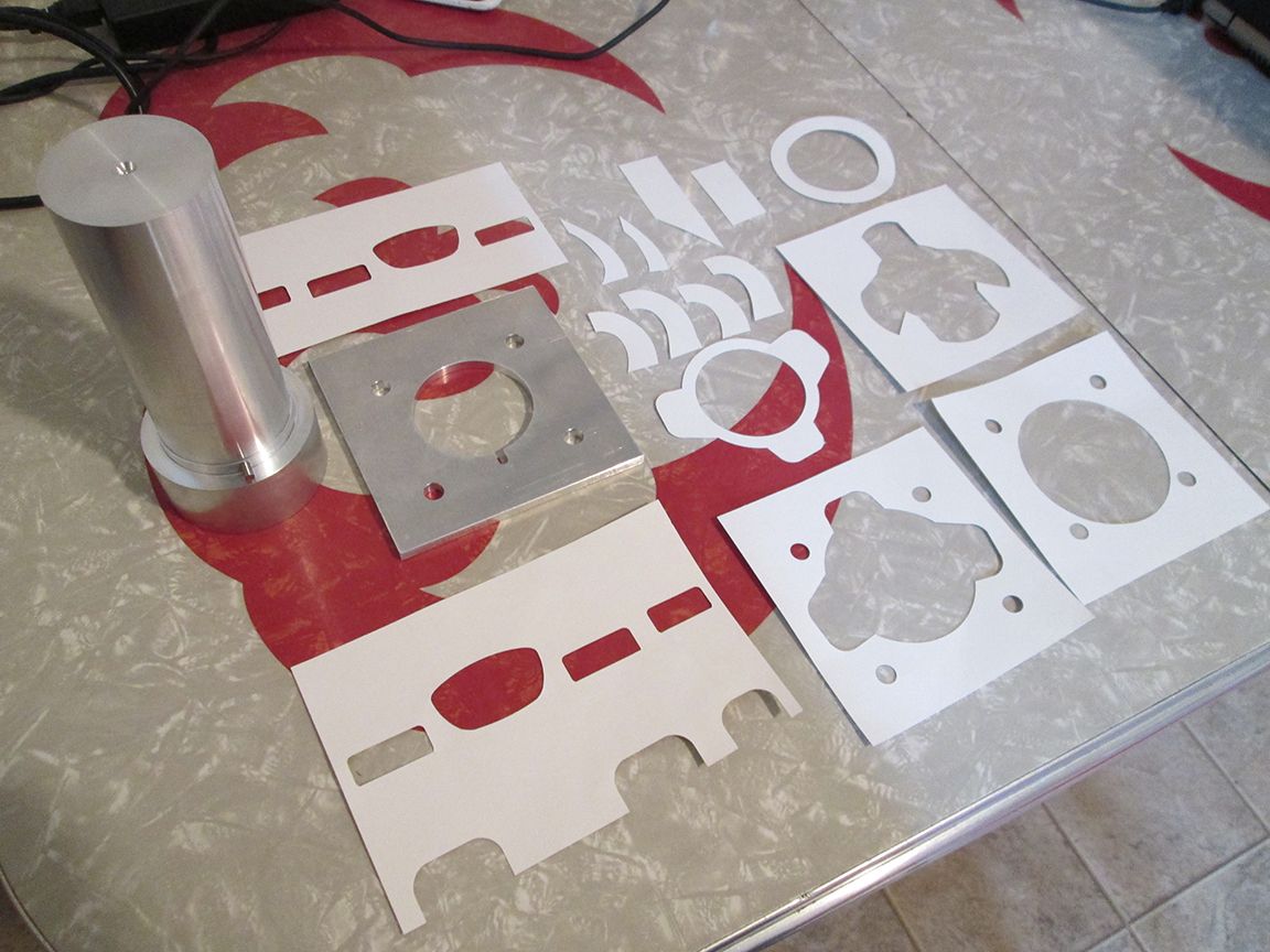

    20th October 2014 - 14:12
    1968 Yamaha YCS1
    United States
    7

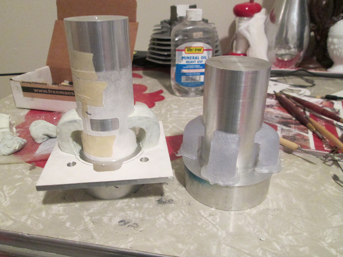

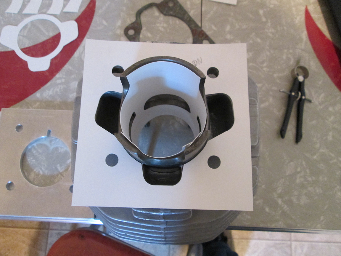

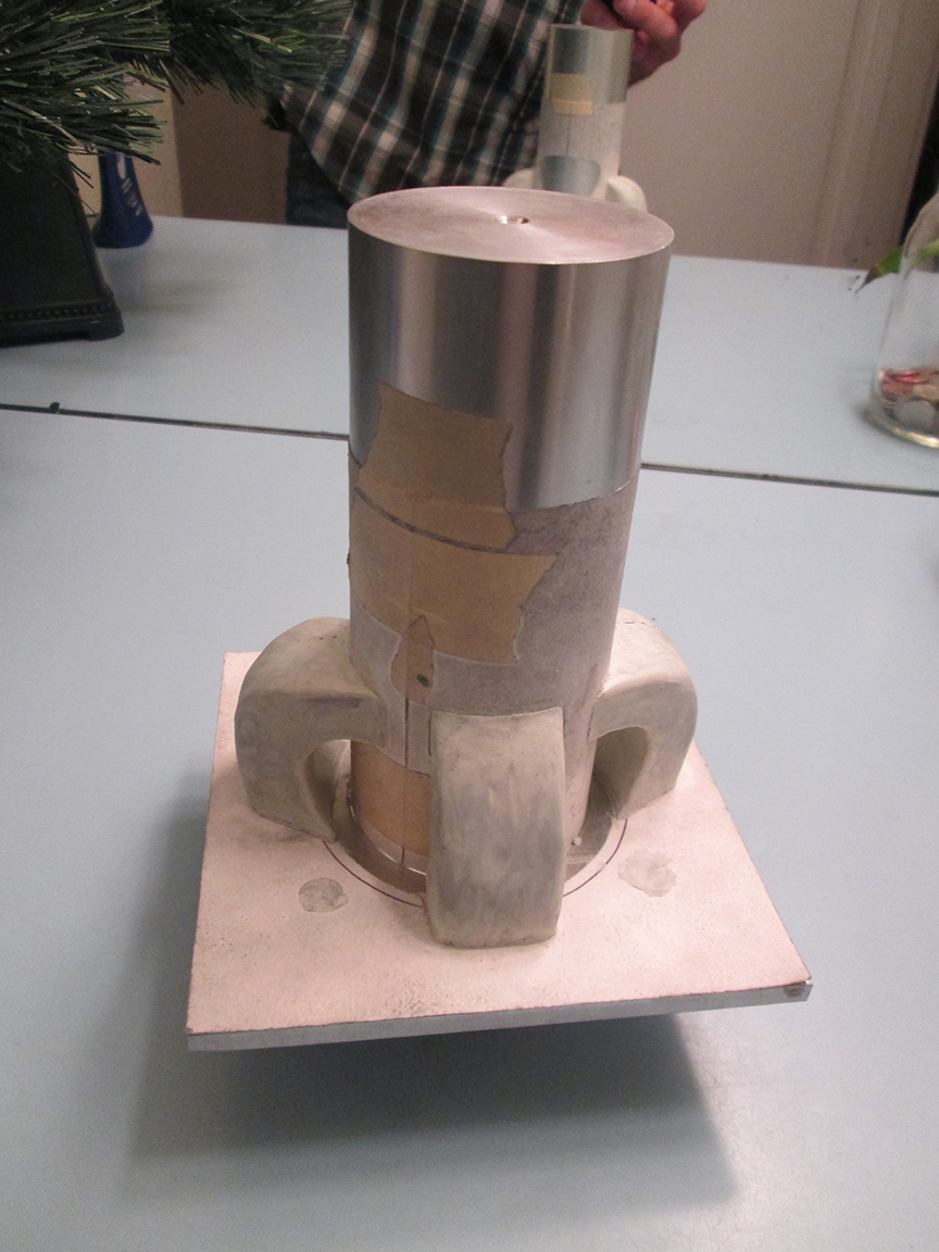

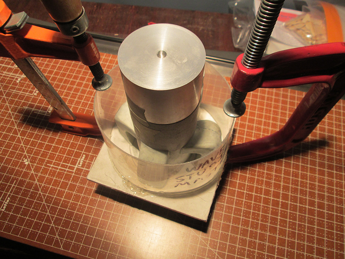

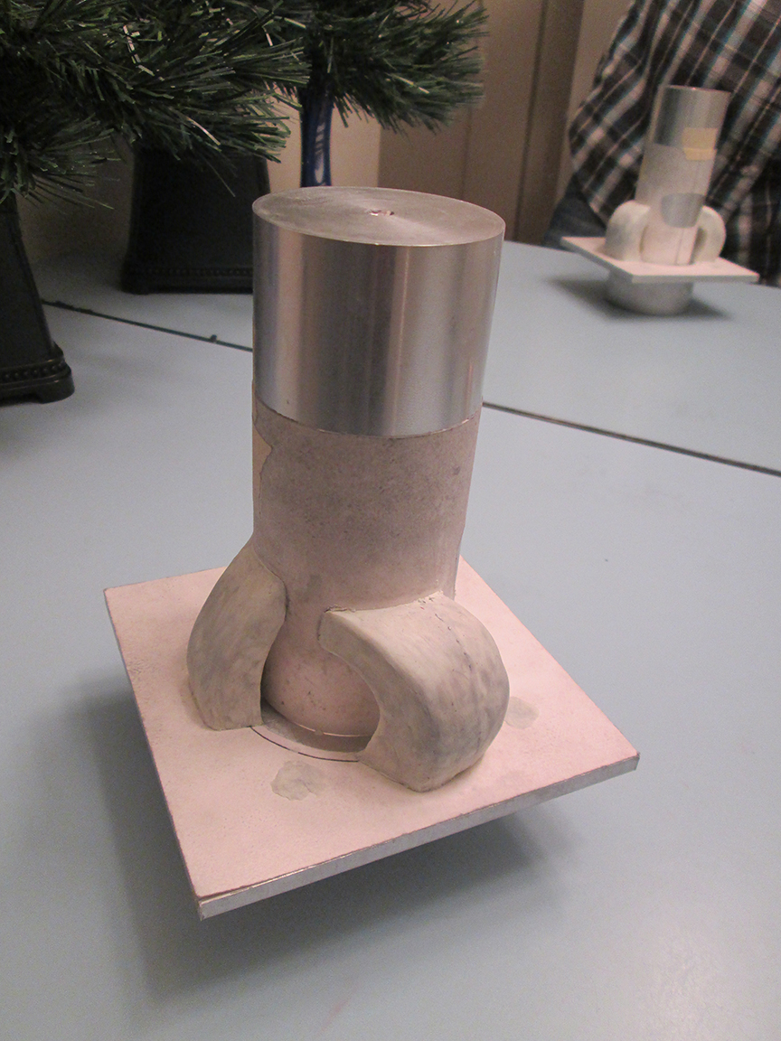

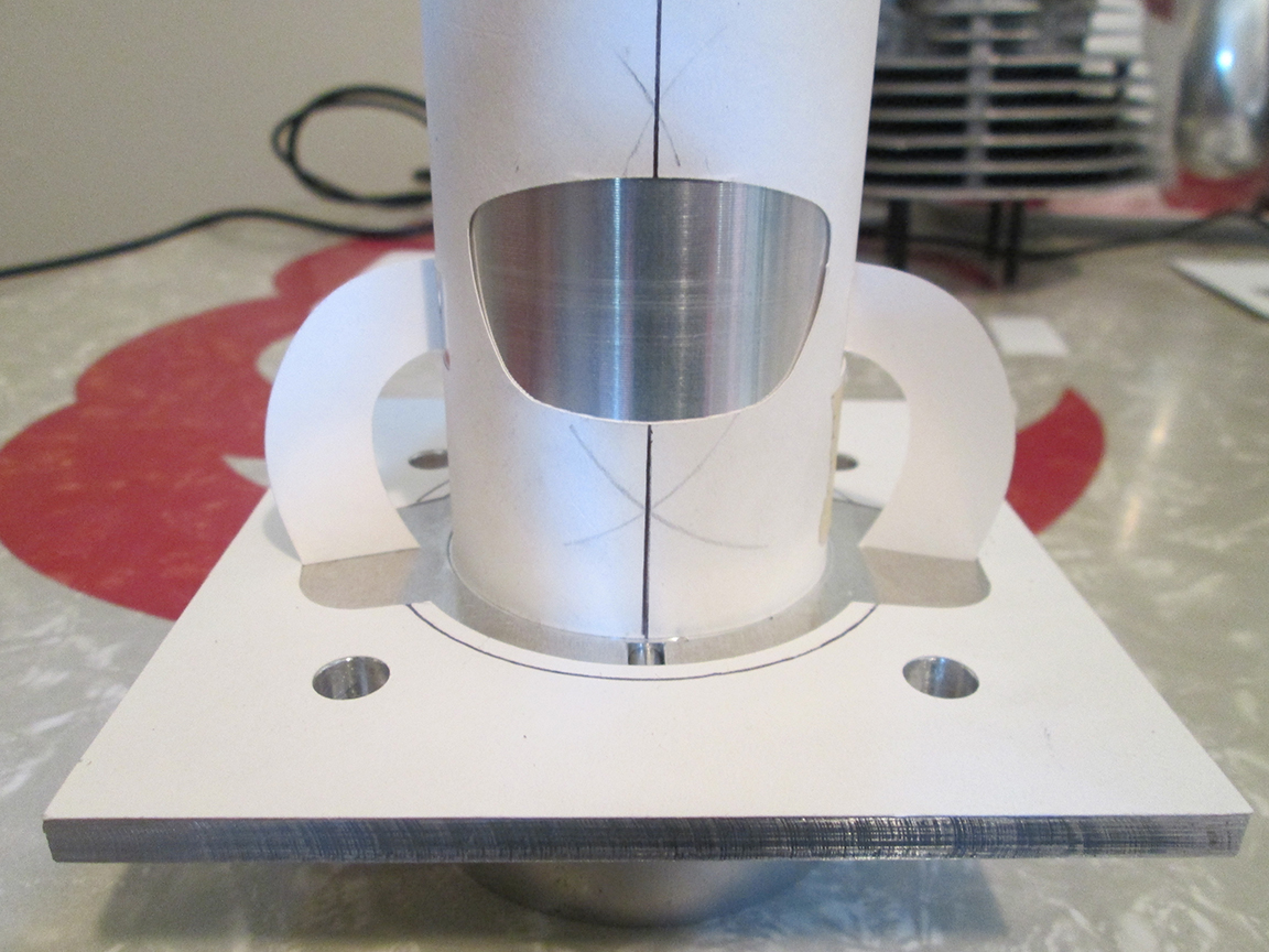

    Patterns for a new "F37" air cooled racing cylinder
    Howdy all, I have been following all of Neil's amazing work on here for about a year. We finally got to talking and he asked me to post some photos of my pattern making and sand casting work on here. Michael Moore posted photos of patterns I made for making air cooled heads on this thread a few pages back.
    We don't call them buckets here in the USA, but I build and race what qualify as bucket racers here in California.
    The machine I currently race and develop is a rotary valve 175, based on the Kawasaki F3 and F7, that I call the "F37" you can read about it here:
    http://www.highwaymanbikes.com/the-h...ge-road-racer/
    As it turns out the cylinders undergo catastrophic failure after a few weekends due to a much to weak mounting flange.
    So i have decided to solve the problem with a new casting, and while i am at it, I will improve the transfer passages and go to a nikasil bore...
    I have started the pattern making process for the mew jug that need to be on a running engine by March to race!
    Viny casting of the old ports for reference...
    I love CNC "paper tooling" I use it as templates to make many many things in my shop....
    Here is how "paper tooling" models the old cylinder ports and deck...
    Here is how paper tooling show where the improved ports need to be...
    The new ports are made with clay, just like in grade school art class!
    Comparing new streamline transfer passages to the old...
    Smoothing out the inner wall...
    Finished port patterns...
    Now I am molding the ports in silicone so i can cast hard copies in urethane that will be used in the next steps of the pattern making process...
    more to come...
