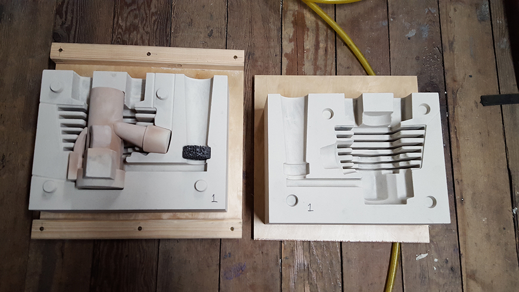

    idea for making sand cores for casting.
    3d printing the shell! with a super cheap desktop 3d printer
    (those boosters are meant to go around the bolts)
    the outer shape of the cylinder can be 3d printed aswell in two halves.

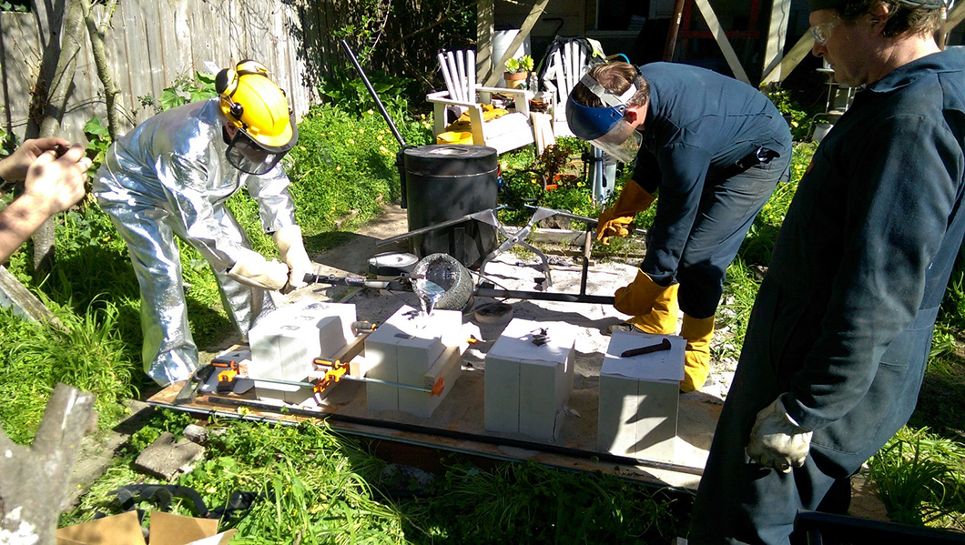

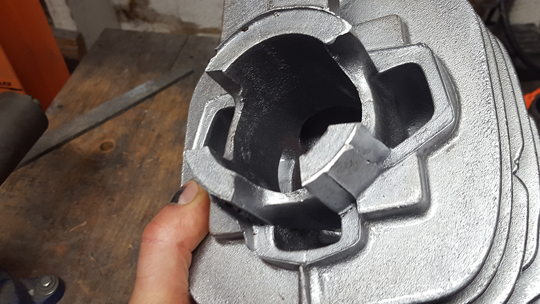

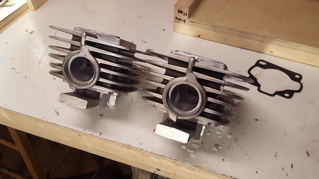

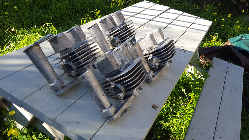

    Well, Neil we did it! Air cooled barrel cast!
    we had some small issues with the tips of the largest fins filling, but the bore and ports and the rest of the fins came out great. For these i will add the missing fin tips with the TIG and be on my way.
    I have some ideas on how to improve the fill, to the fin tips we were SO close!

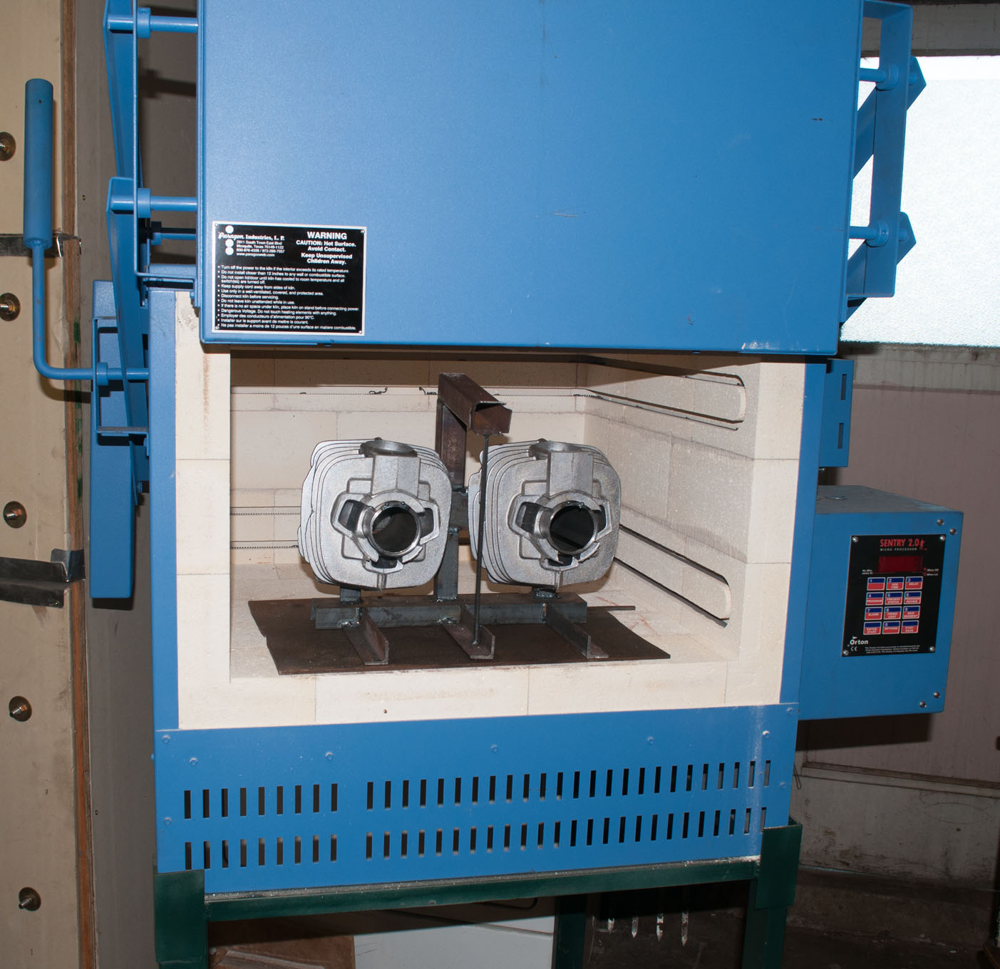

    Two cylinders have survived heat treating to T6 and will be machined and nikasil plated soon!
    full story here
    http://www.alloyavenue.com/vb/showth...cylinder/page7
    and heat treating...

    Applause for jhenise, well done!
  13. #1978
    11th November 2011 - 12:15
    93 kx500
    Aus
    47
    Great work Jhenise.
    Did you pour all cylinders at once from the one crucible and did the last one get worse fin filling?
    I wonder if they are just cold shuts or air couldn't escape.
    Maybe one of the below thoughts may help:
    If cold shuts:
    Hotter melt temp
    Remove filter for faster fill
    If trapped air:
    Slightly tilt moulds up on angle so air can run along fins to the fore aft web and scratch an air vent up mould split line to let it out
    Courser sand or less resin
    Drill down side of mould alongside fins and then drill through tips of fins to let air out. fettle off pips after
    Hopefully one of these may help.
    Brett

    Real nice job! You should be well proud, no stopping you now
    I use just a welding wire to poke down to the pattern before the sand is hardened, also these little holes are good for CO2 infusion.
    Tiny little holes to let the mould gas escape.
    Seeing those air cooled cylinders encourages me to have a go at my F9 cylinder, I can't say it enough, REAL nice job.

    Jeff, really nice work. I'm sure the fin filling issues will be easily resolvable.
    Hope the performance matches the level of excellent detail you have put in all through the design and manufacture.
