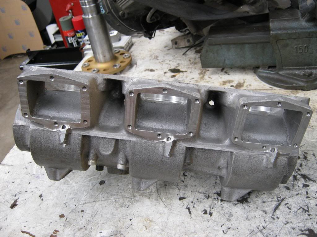

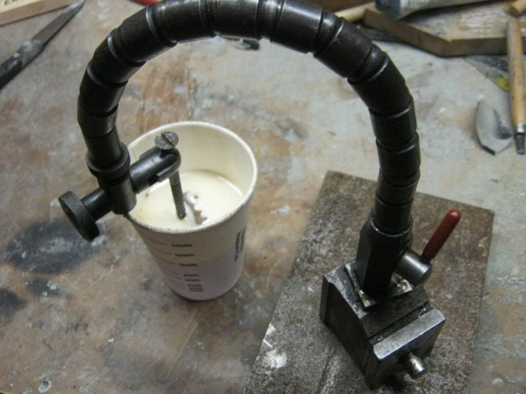

    Here we go again, I'm finaly back on to cylinder production.I've got several cylinder projects on the go, a revamped 360 cylinder with prevision for a power valve, a 185 (ish) cylinder for YZ125 engines and now also a cylinder to suit an RG400. In other words a modern cylinder to suit the RG ( Bucket cylinders ), I might want one or two.
    A water cooled 25cc cylinder might be nice too.

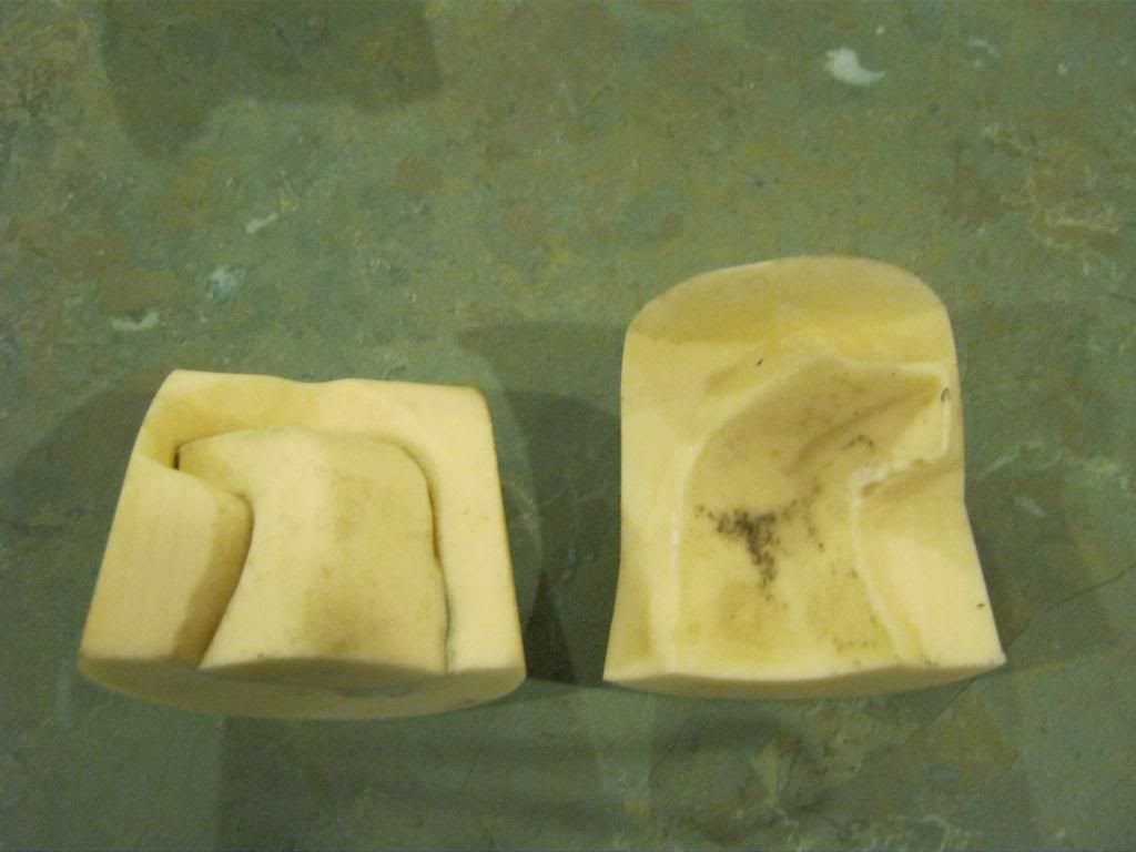

    New cylinder(s), good on you. Hmmm, but what could the pic be of ? I reckon it is a male shape of a transfer passage or powervalve relief passage, possibly made by hand or 3D printer, being cast in silicone so you can make a number of cold set sand cores.

    Quote Originally Posted by ken seeber View Post
    Flettner,
    Ken
    You're way out, it's a prototype cappuccino machine for the workshop!
    Seriously though, I am hoping to see the foundry processes used to make the new cylinders on this thread (hopefully)!
    Will.
    Flettner,
    Ken
    This is a rubber mould lifted from a cylinder I like. I am setting this rubber in casting resin to get a hard ( female ) shape. This hard shape will eventually be the sand core box. There are probably better ways to do this but this is how I know, it works for me.

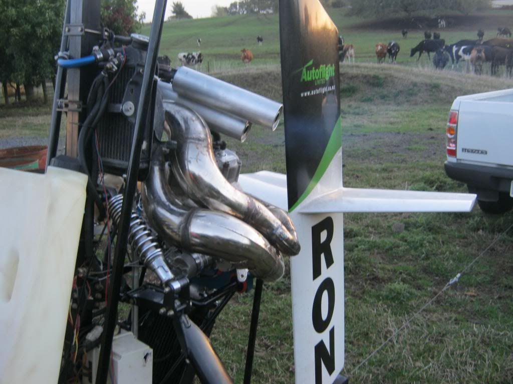

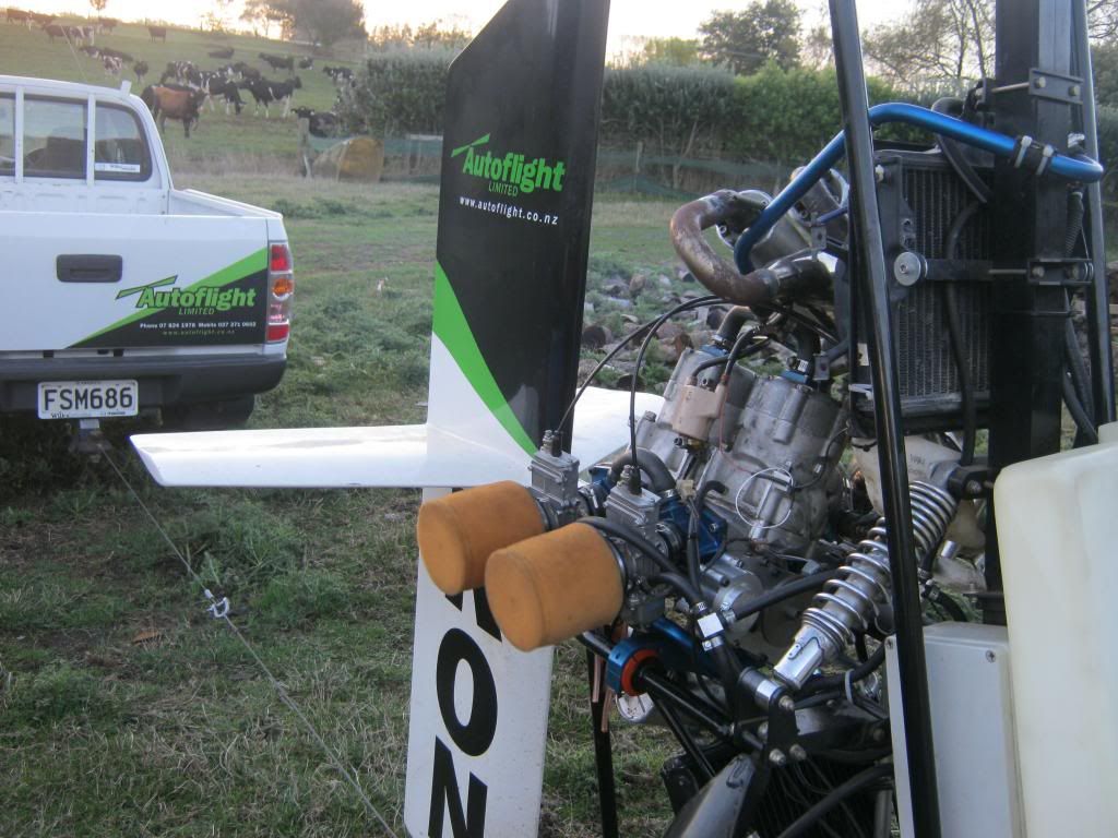

    A couple of pictures of the 700 twin at work, got it up to 6200 rpm for a while today, holding temps nicely. I will have to stop testing around home, it is loud ( in a good way I think ).

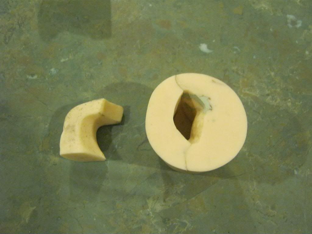

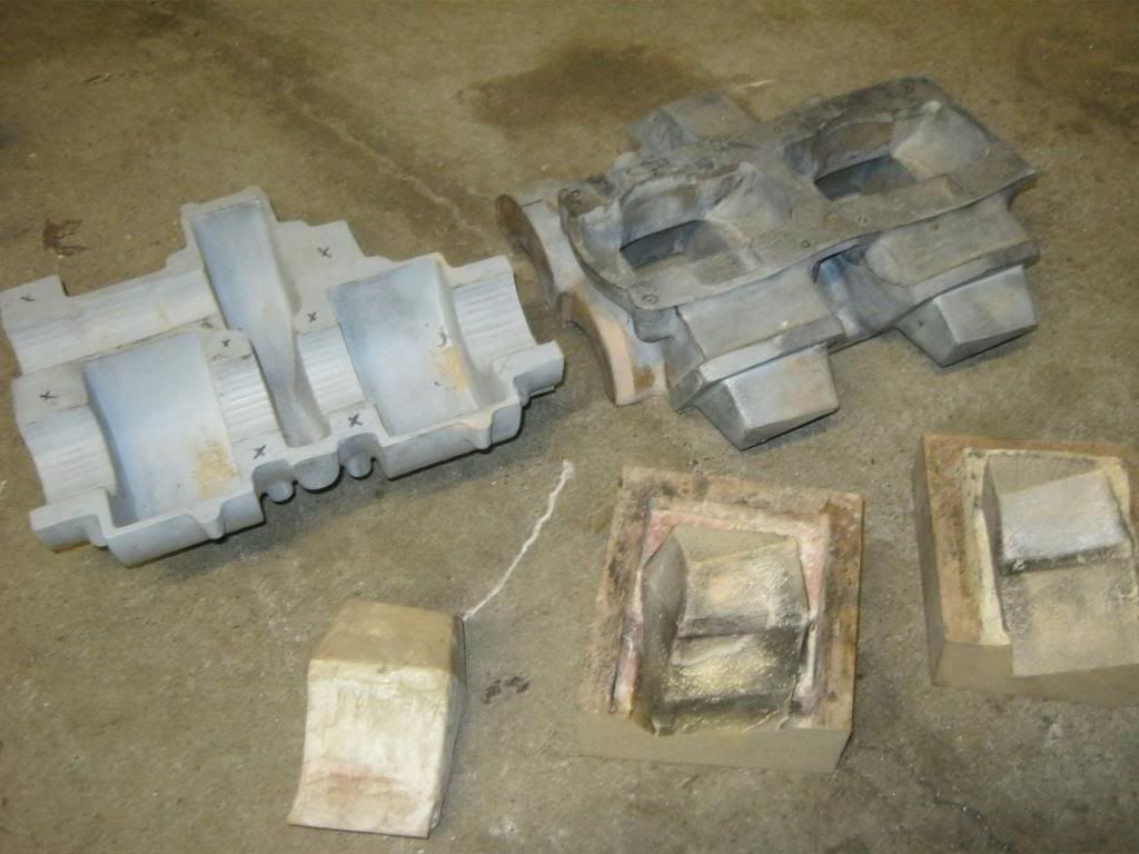

    This is an example of a core box. The bottom left hand item is the original hand crafted part ( copied in part from a cylinder I had on the shelf). The right hand pair are the core box that was made around the original. I made two extra shapes from the core box and glued them into the pattern ( as you can see ). So now when the pattern is invested into the sand, it leaves room ( core prints ) for sand cores all made in the original core box to fit in. This will make the casting hollow where the reeds fit, no machining nessary.
    Sorting out a few old patterns on the shelf. They might have to go down to the "storage cowshed" down the road.
    Managed to get my head around it all .... eventually!
    Looking forward to making patterns/coreboxes etc. and learning by mistakes.
    You obviously don't (probably don't need to) use the ready made reusable stuff on the market for taking off shapes for transfers etc. - it does sound good, but it's probably a bit expensive for me for a start anyway!

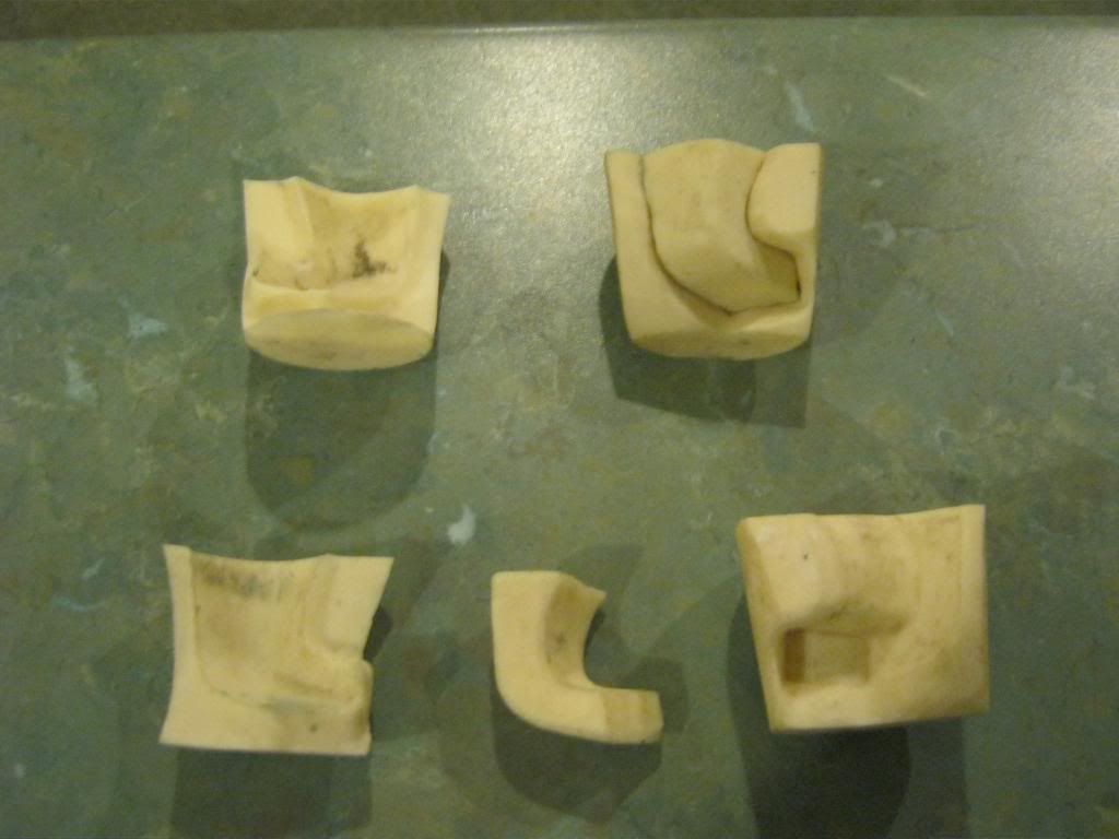

    Here we have hard copies of the rubber transfer ports lifted from our 'suitable' cylinder. With these hard shapes we can modify them to suit the needs of the cylinder we want to build. These molds will be discarded (kept on the shelf but probably never used again).

    [QUOTE=Flettner; 2T engine 38Kg including gearbox, conservitive 80HP. Needs smaller rotor system ie less drag, faster and more nimble with the 2T.
    /QUOTE]
    So there is definitely a good reason to keep the good old twostroke engine in circulation! I can't believe the difference in weight! - looks like you are on the right track developing that one.
    What sort of resin do you use to harden the rubber moulds in the pictures, would it be better for me to use 'vinamold' ?

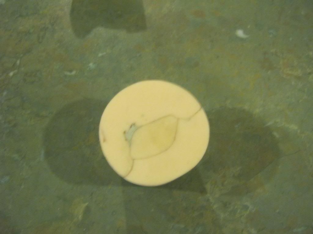

    At the moment I'm doing some test pieces trying to figure out a good recipe ( concoction maybe ), to use in my furnace, ie the hotface part, - all good fun even if I do it my own way!
    Used my wife's oven today to dry out a piece and I had to leave all the doors etc. open to get rid of the smell before she got home , trouble is, the damn thing cracked!
