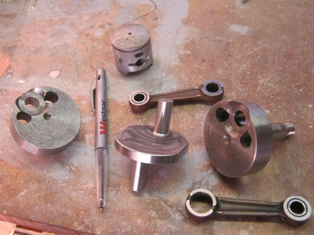

    Here is the crankshaft for my 2 x 25cc cylinders. Horrizontally opposed twin.
    Here is where I want to put it. A pre rotater engine for the gyro, not used in flight, only to get the rotors turning before you roll forward for takeoff. Need 5 / 6HP with no weight.
    The spiders are going to get a fright soon enough.

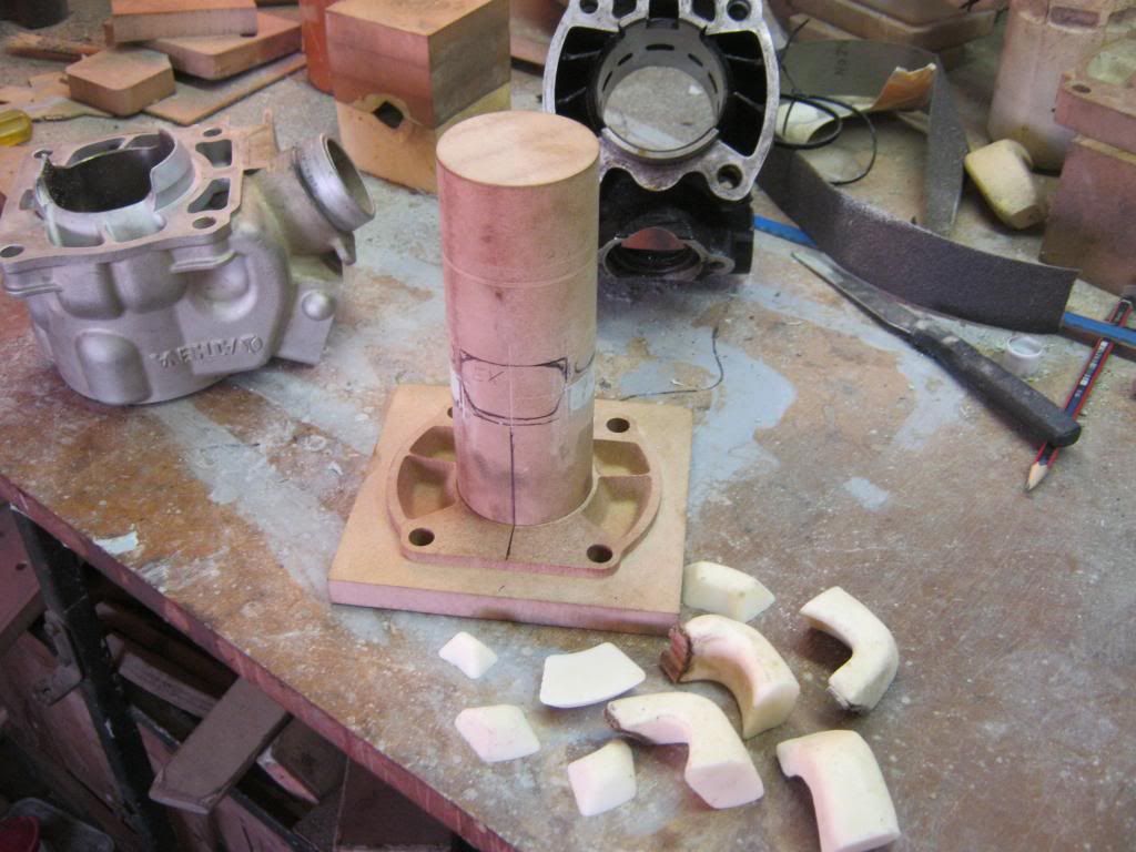

    Here we are slowly moving on with the new RG cylinder.
    I did wonder what you were going to do with a twin 50! - Will it need some sort of clutch as well ?
    Guess it won't need a real big radiator - how long will it be used for each time?
    Have you settled on how to approach the chrome bore problem? I was going to say earlier that Briggs & Stratton have been flash plating their aluminium bores sucessfully (not sure exactly how it's done) for probably 60 years!

    There needs to be a gear reduction in the system ( before the bendix ), this will be a planetary gear system with a clutch band around the outside. Stop the ring turning to provide drive, simple. I'm still not sure on the bore, just it can't cost anything. I know Frits does not like the brass sleeves idea but it only needs 2.5 / 3 HP per cylinder, I think I can get away with that. I can get the cylinders chromed here in Hamilton for bugger all ( on to brass ), and grind them myself. Only has to run for approx two minutes at a time.
    RG cylinder, now, that looks interesting .....
