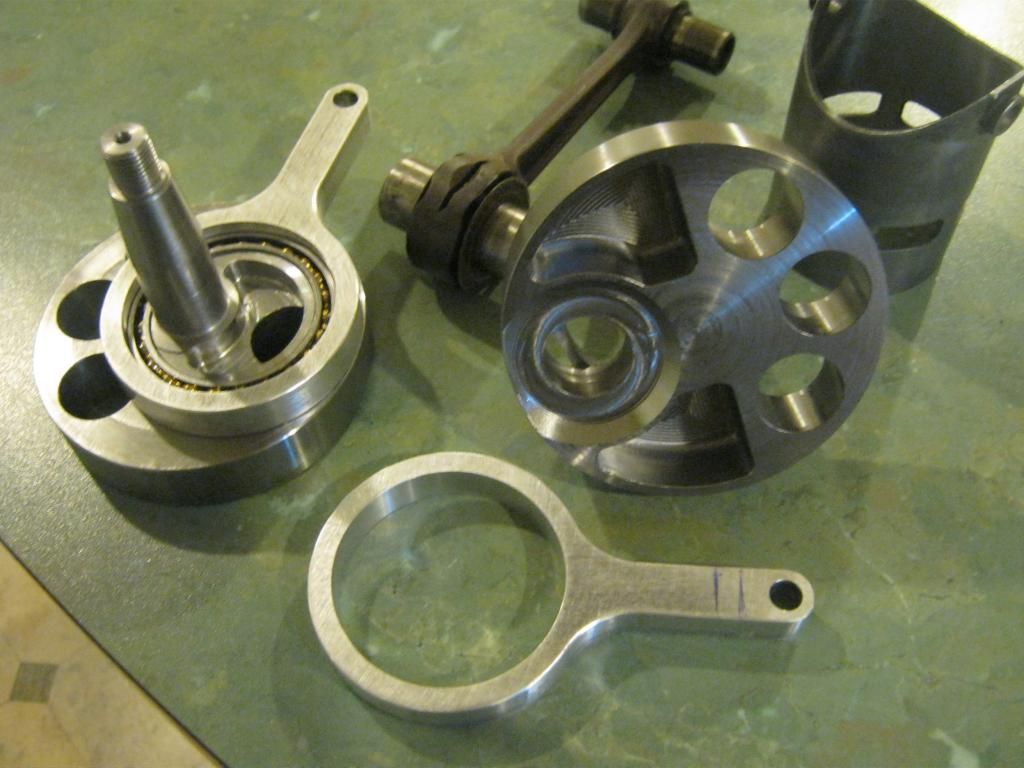

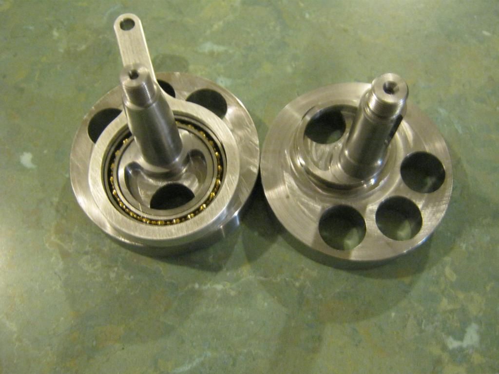

    Sleeve valve crank ready for nitriding, a little bit of Davies pump tech! 360 crank is also finished.

    How is the balance on that whole rotating assembly?
    What is vibration going to be like on that motor?

    citabjockey, I've been hiding on this forum until I've got more to show off ( a running engine for example ). 360 rotary valve engine is moving along slowly, I've just finished the crank for it also.
    Ballance, yes I certainly understand this type of crank will need careful attention to the ballance. You will see three holes for bob weights ( mallory metal ) plus the crank case will house a ballance shaft. A necessity I would think. Hows the RT going?

    Here is the sleeve assembly together, pins are just some old broken cutters just to hold things together for now.
    All looking good so far, like the ballrace bearings on the sleeve conrods!, guess those rods are ally?
    Will the sleeve be lubed from the normal two stroke mix?
    Mallory Metal? what the hell is it? - guess i've been out of the scene for so long and I haven't managed to keep up!

    Rods are 7075, normal twostroke mix, Mallory metal? Not sure but it's machinable and heavy, I think tungsten that has been sinttered into bar form. Lead moves too much and may not be heavy enough.

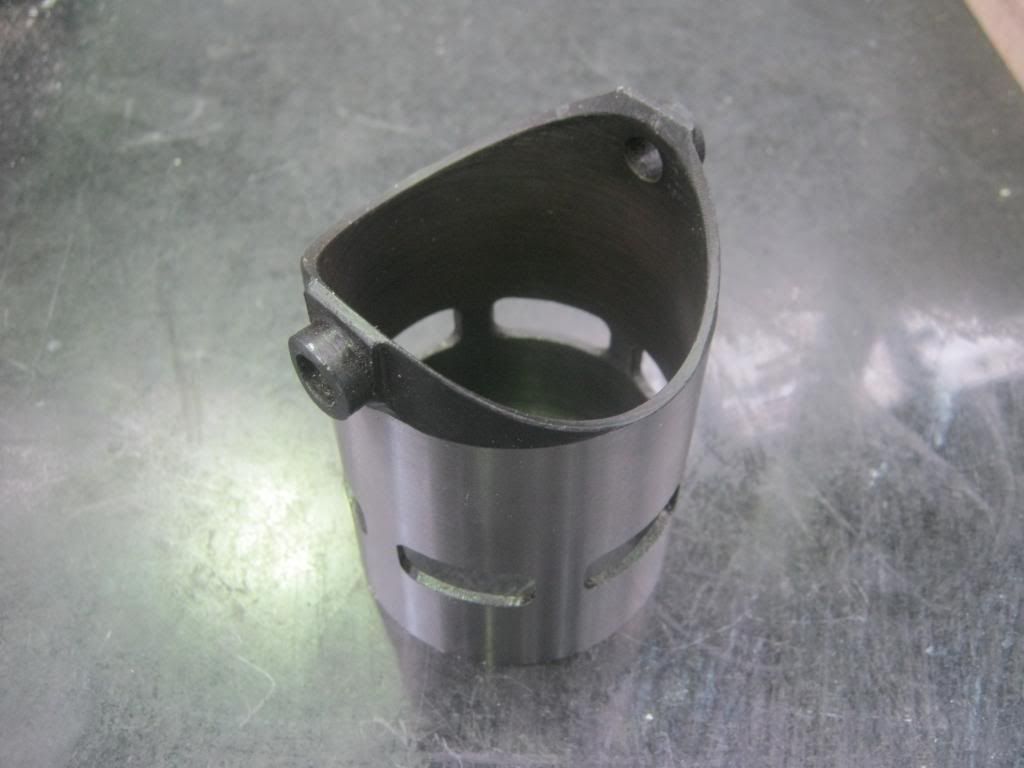

    Where those sleeve rods attach to the sleeve -- that kind of looks like a possible fatigue failure point. Is the sleeve material beefed up there at all? Can't see in the photos...

    Sleeve has lugs, although they are a little thinner now, 5mm wide, 8mm pins. Sleeve has only a 24mm stroke, piston 54mm
    Remember that this is a twostroke so should have a positive push down on the con rods ( the sleeve has a surface area exposed to combustion pressure ), rods should never be under tension ( much ).

    When you say that the sleeve surface area is exposed to combustion pressure, are you anticipating that it will be pressed (or "bulged"?) against the outer bore and so may not require some sort of ring near the top?
    I guess it's possible with this configuration that the usual two stroke low rev "stutter" will disappear?

    That is the amazing thing about Ricardos sleeve design is that it requires no top ring. Apparently the sleeve expands untill it transfers heat to the cylinder surface, self regulating. The top of the sleeve ( 2mm thick ) will get pushed down with combustion pressure, it's the top of the sleeve that uncovers the exhaust ports. Yes I know that sounds like rubbish and I'm sure seizure will probably occur, but I want to find out myself, I have a few other ideas to add.
    Yes the uniflow style engine ( of which this is one ) has a much cleaner cylinder fill even at low speeds, it makes the engine tune much like a fourstroke. You can have them quite lean or rich and they will run clean, ie no fourstroking.
