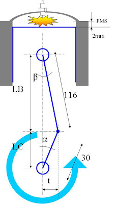

    My first thought was the method once used by Saab, with one electrode reaching down from the cylinder head and another electrode spike riding on top of the piston.
    What is the ignition advance?
    The spark jumps so far away?

    I expected such a reaction, Ceci. But the electrodes need not be in line; they can have a little offset, so they can be longer and pass one another on the piston's way up.
    His proposal was for the opposite piston engine, in that case the length is doubled. The electrodes would not be too long, which exposes them to easily deforming

    I was not too fond of sending the ignition current through the crankshaft, big and small end bearings, or through the piston rings, anyway. Spark erosion can be a great tool, but you don't want it to happen inside a running engine. We'd better concentrate on HCCI.
