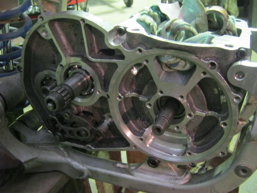

    Engine in the frame, sealed up, this is the water cooled crank case, behind the rotary valve.

    Posting more to subscribe than anything. However, a barrel for a fourstroke with a liner should be pretty easy yeah?
    Bit of a water jacket and a decent surface to mount the head to would be handy for my special motor.

    Neil do you have any more pics of the mold of around the crankcase entry ie the top? I could not quite figure that out from the last photo montage.

    Yes, fourstroke cylinder would be easy, to suit what head?
    Sorry husaberg, I'm not sure I understand what you are asking? Are talking about the rotary valve housing?

    no sorry the top where the cylinder goes with the transfer entries.
    How it goes from this

    Am I right to guess there is another male component for the bottom of the transfers ie the curved shaft that provides the transition from the crankcase?
