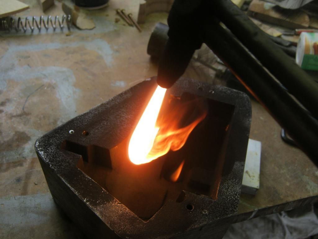

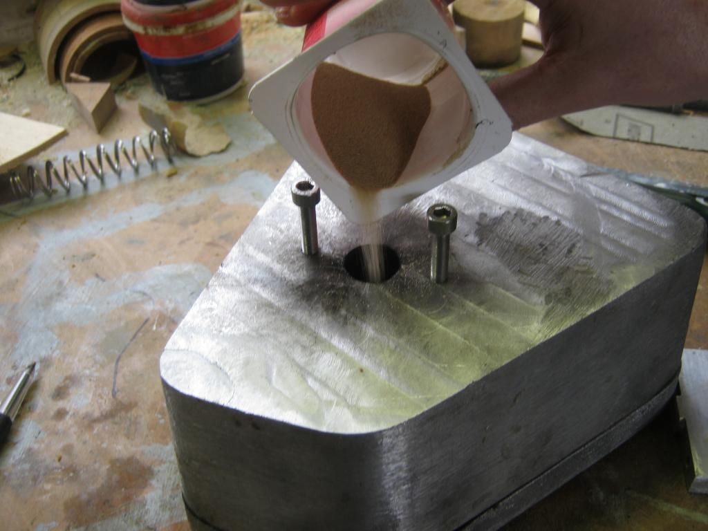

    Finished 360 cylinder water cores with allowance for blade type power valve now. Metal will flow through this gap to make a soild plug through which I can machine a slot for the power valve blade to run. As simple as that.
    give me a minute.........
    http://i1056.photobucket.com/albums/...psce0016e9.jpg
    Carbon based release agent
    http://i1056.photobucket.com/albums/...psa45ec78e.jpg
    Filling with shell core heat set sand, then off to the oven to bake.
    http://i1056.photobucket.com/albums/...h_IMG_0519.jpg
    http://i1056.photobucket.com/albums/...ps14c5c5a6.jpg
    Only seam available as a mini pic Neil?

    FLETTNER.
    Carbon based release agent??
    In the first photo are you deliberately using a carbonising flame?
