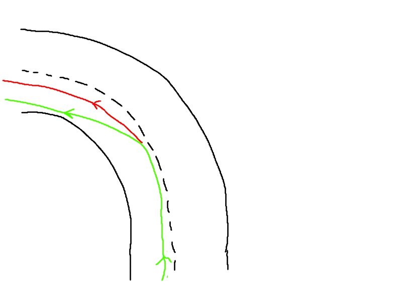

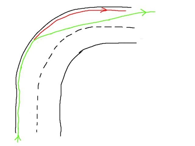

    I've included a couple of crudely drawn graphical depictions of both left and right hand turns. The green lines represent the "normal" cornering line, while the red lines is what I'd do if there is debris in the middle of the road. The red lines are always in the wheel tracks of the cars, where there is very little debris (usually). The arrows show which direction I'm riding in.
    For the LEFT turn, the green line is approximately in the middle of the lane. For the right turn, the green line is near where the right hand wheel of a car would be. Does this look like a reasonably safe way to corner, both for collision avoidance with other vehicles, and avoiding debris?

    Quote Originally Posted by SMOKEU View Post
    You're in the shit here I'm afraid your line is way off......like wrong side of the road off

    Quote Originally Posted by skippa1 View Post
    lol! That's a pretty epic fail. Fixed.
    That's exactly what I try do. There's the back up option of turning in earlier if the outside line looks shit as well.
