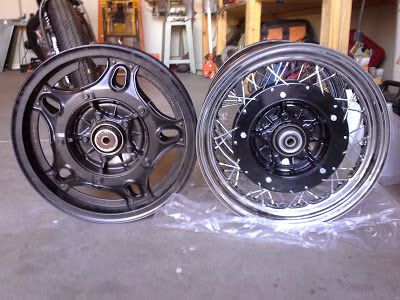

    Comstars can be converted to wire spoked wheels.
    http://motosynthesis.blogspot.co.nz/p/products.html
    I know someone with the machinery to build this. CNC machined not water jet? the key would be to set up the CAD model.
  15. #30
    12,312
    I first seen it doing the Covered disk ala VT250/500 or CBX550 (Enclosed disk )so it looked like a drum brake it was pretty neat.
    Of course it would be likely cheaper to just buy a couple of hubs and modify the fork axels etc
