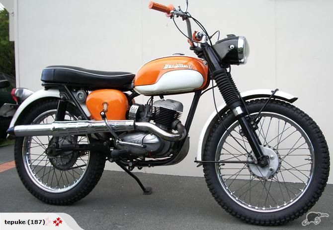

    The original Bushman was a Bantam derivative and sold into Aussie mostly. I think they were the last of the Bantams (175cc 4 speed) and were quite good apparently. They are now rather rare and highly sought after by men in anoraks wearing strange badges that look like chickens... I'd quite like one and an original D1 as well for some reason I just can't understand... oh - and a badge...
    http://i386.photobucket.com/albums/o...ps467ad621.jpg
    They certainly were an early 'trail' bike...
    Oh - heres a picture and info on the non BSA version..
    http://www.bridportclassicbikeclub.c...sa_bushman.htm
