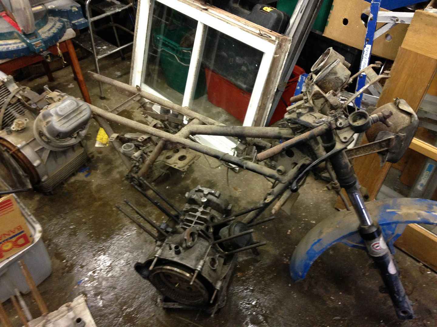

    I have a spare BMW frame and thinking about building up a replica of Helmut Dahnes Imola 750
    The frame in the pic is a modified BMW frame and it uses the stock steering head and lower frame as far as the swing arm pivot. The rest of it looks pretty easy, just the bend at the steering head would be hard ( for me).
    What sort of tubing would I need?
    I have a spare 900 motor, gearbox,FD, wheels ( but with discs)
    for the tank I'd just put a small tank with a dummy cover.
    Fairing, probably modify an existing one.
    Pic of current frame
    For use on the road .. ??

    Frames are a fun one, the company's that make them (both race developers and bike manufacturers) spend decades designing and developing them, flex, geometry strength, and performance aka weight are all things that are taken into consideration.
    If you had access to the figures of your desired frame, rake, trail, swing aim height, lengths then you have a good starting point.
    We considered building a new frame for my F3 race bike (ZXR400 with a ER650 twin jammed in) building a frame not hard, but making it actually perform like a frame needs to, was impossible for us at this time.
    There is bound to be someone somewhere who has created a machine like what you are looking at building - become their friend and good luck. Its a great looking build!

    No idea what that last pic is as it won't open for me.

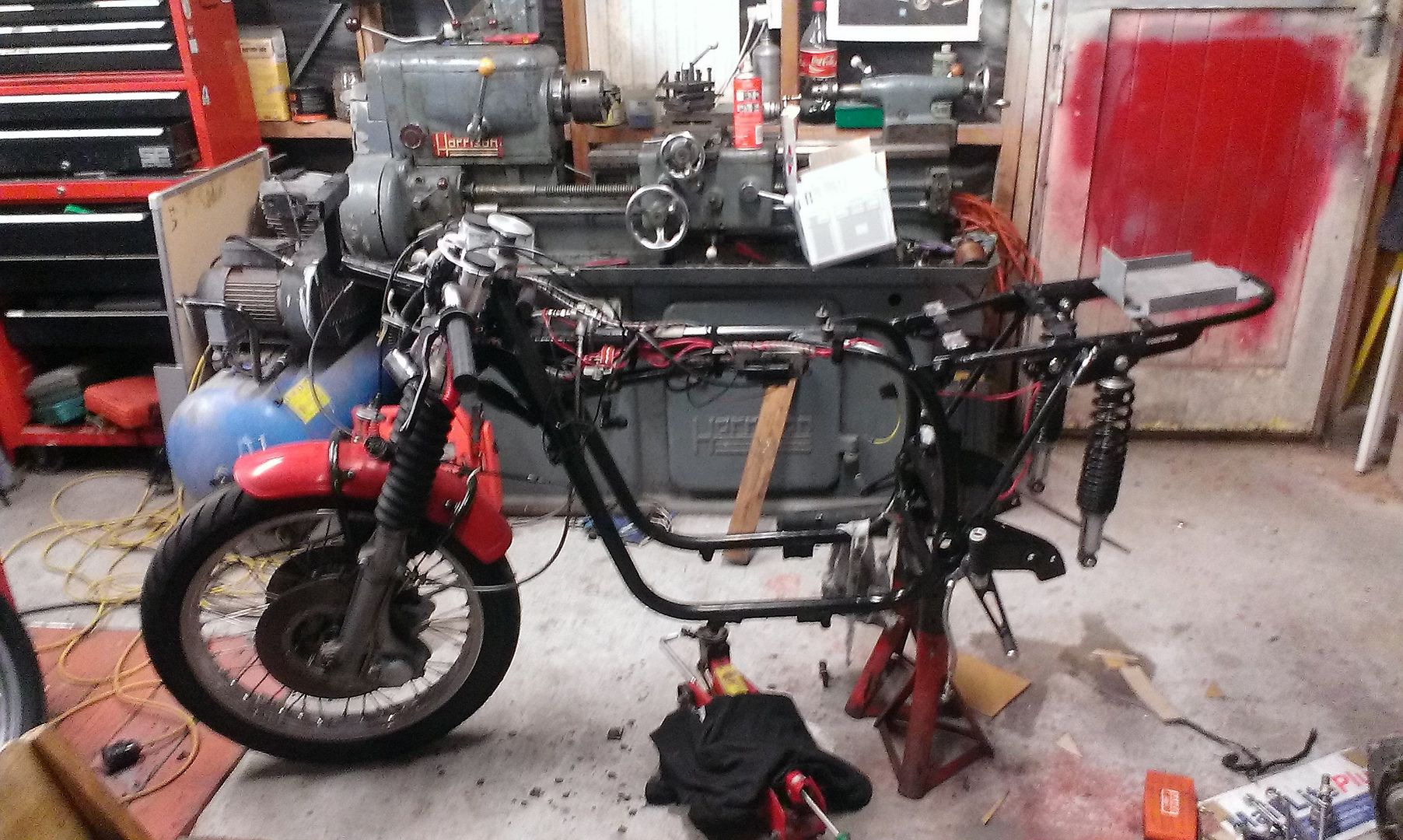

    Those frames are as flexy as fuck. I put a Kohler V twin in one for Eurodave down here. Build thread somewhere on Dotheton forum if anyone's interested.
    That frame is basic as - which is Helmut Dahne to a Tee - he's the original KISS type.
    The one I'd look for info on is the BMW USA bike which had a frame built by Rob North in California. Very like the triples frame, not hard to do.
    FWIW, the top tubes on that one of Helmut's look like 1 1/8in OD - and i can hand bend that in 2mm wall on my bender. Mild steel is all you'd need.
    Quote Originally Posted by neil_cb125t View Post
    Did you bother to read the original post?
    Looks like a simple way to solve most of the Airhead flex problems - a couple of nice straight top rails like a featherbed copy should have, triangles and stuff. You'd need to have extra length on the bends and cut to length, otherwise as you say, looks simple to replicate. You could tweak the head angle while you're there, stretch it out for some longer forks and higher bars for a more relaxed stable riding position - cruise past those CB350's in style. I don't know what sort of tube is best.....me, I'd just use black tube and paint the whole thing in Sampson High Gloss.
