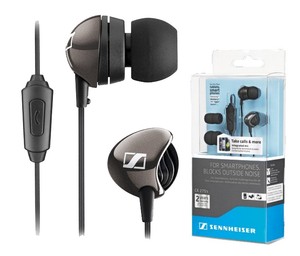

    When simple "earplugs" are not enough, here is an alternative:
    Noise cancelling FTW.
